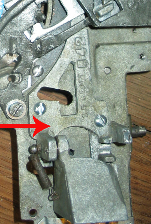

madpug3 wrote:The coins we currently have which came with the machine are actually tokens (like you said it has been in the French market, we got it from Belgium). I’ve attached a photo, we have been looking for some more that will work as we’ve tried a few very similar coins/tokens with no luck. I will try the Francs that you mentioned if you think these will work as we definitely could do with more of them to fully fill the machine.
Hi
Do you can post some photos of the Mechanism ??
When the Mechanism is out of the Wood case ,check the coin tube size , if the diameter is : OUTSIDE/ 27mm (arround 1 inch) and INSIDE/25mm try with 25ç$ and let me know !
it s will be ok for the complet escalator but maybe stopped at this step:
If the coin tube is more small , try with 5ç$ but I think that you will have a problem on the rotor.
Try and let me know.
Stephane
