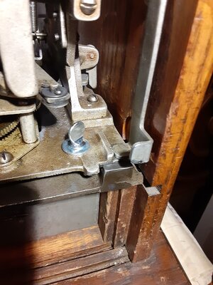

yes it might be a while since Marshal Feys grandson is helping out with the book orders, its important to make sure you get the 2 mechanisms hold down bolts on your 10 cent machine which helps keep the escalator aligned with the mechanism properly.
1 inch length cut down to 3/4 long
1/4 x20x 3/4 long

Bally Bill wrote:yes it might be a while since Marshal Feys grandson is helping out with the book orders, its important to make sure you get the 2 mechanisms hold down bolts on your 10 cent machine which helps keep the escalator aligned with the mechanism properly.
1/4 x20x 3/4 long
Yes! I learned this. Mine did have the hold down bolts, but the base plate itself was loose. Once I tightened up the four nuts at the corners, it's been reliable.
Thanks again for your help!
