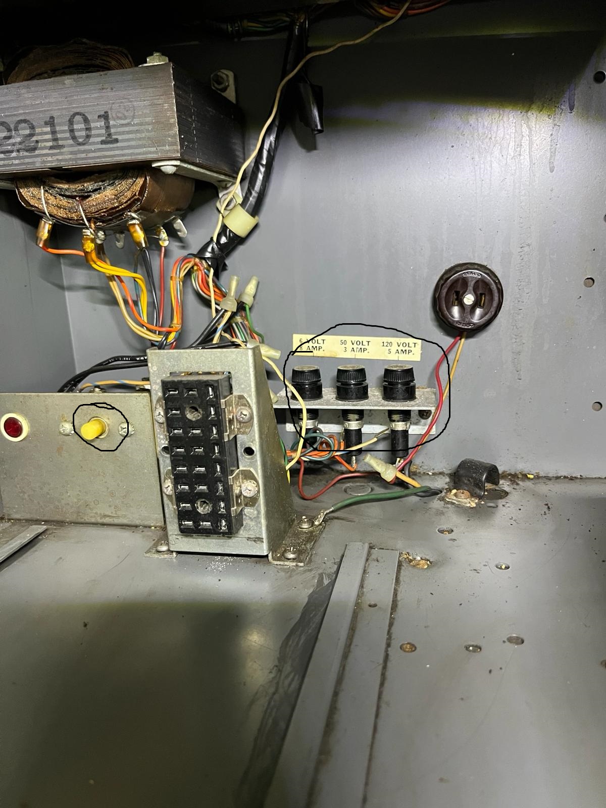

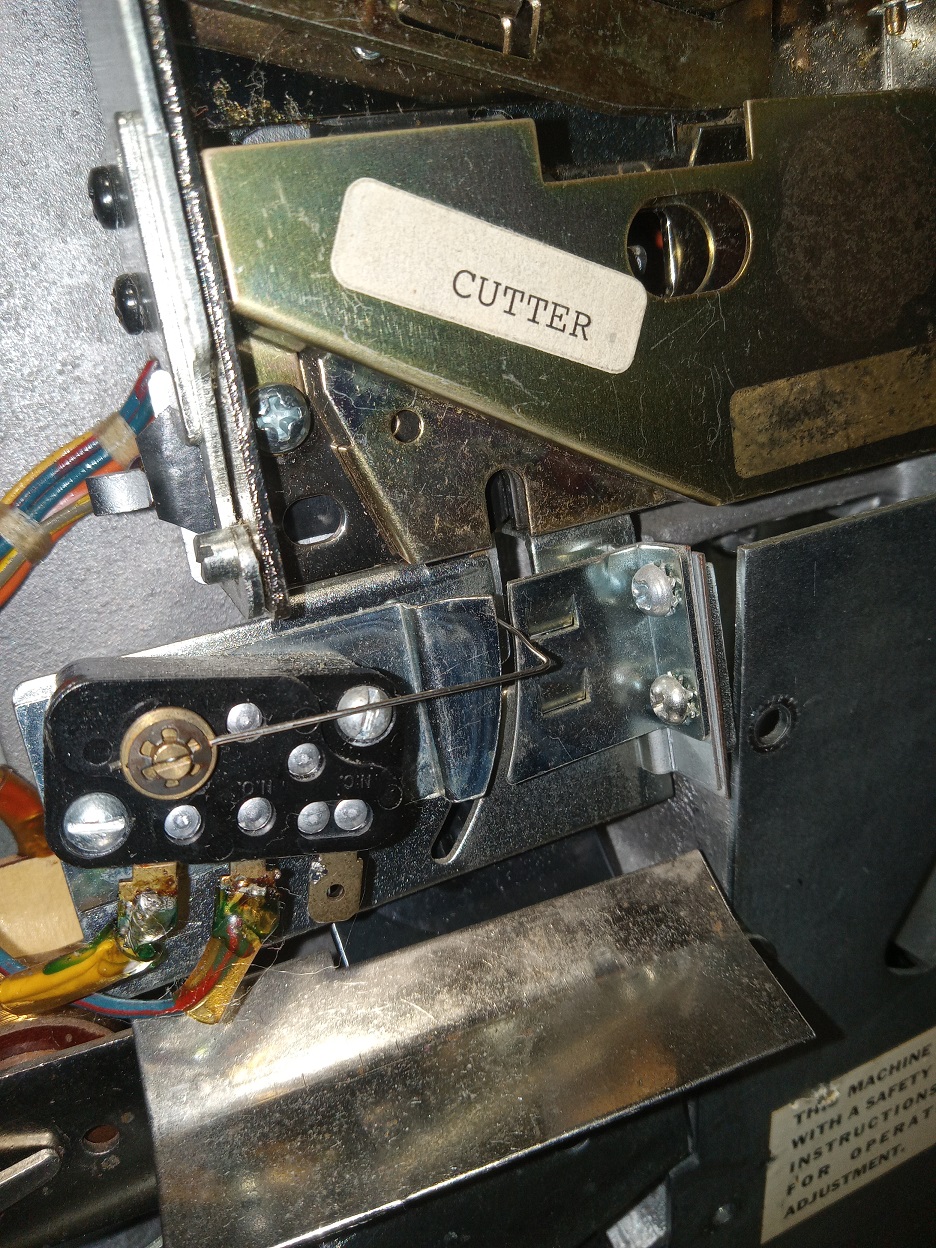

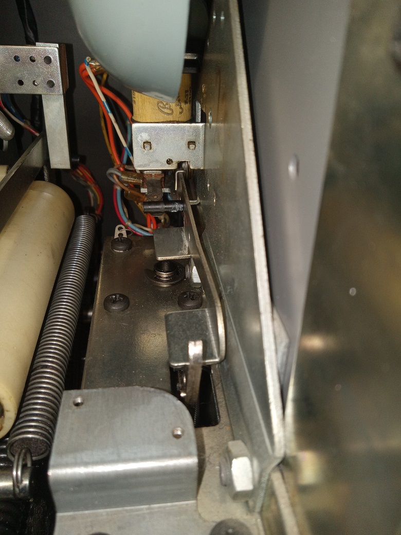

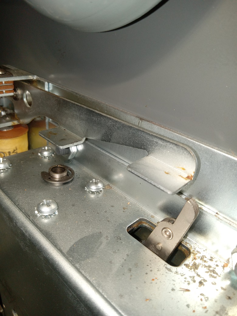

Postby Bally Bill » Wed Mar 06, 2024 5:29 pm
Ok I sounds like you pushed in the white reset button and nothing happen, So let check the 3 fuses in attached picture to see if one is bad. Just push it down and twist and see if the small wire is broken in one of the fuses. Post when your response when you can but in the meantime instead of dropping in a coin you can power machine and up open the door and push down the coin switch to see if it releases the handle release coil. I have included some helpful pictures and information so you can arm yourself with some EM knowledge to learn the basics.
Your machine model (742A) with serial number-361 was originally a .025 cent 3 BAR anyway slot from the Silver Spur casino in Reno Nevada and was recycled at some point to a Kit machine after the casino got bought out in the late 1980 which changed the top awards glass and belly glass to your 777 Golden Nugget configuration.

Postby tim1088 » Mon Apr 01, 2024 9:59 am
So we spent about 2 hours playing with it and after replacing a fuse, finding the jackpot reset bar, and troubleshooting a stuck handle...... WE DID IT!!! Thank you guys so much for all the tips, we would have never had a chance if it weren't for the images of the manual and tips provided here.
