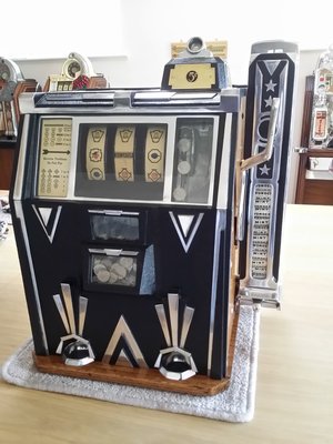

Postby clubconsoles » Tue Feb 12, 2019 1:55 pm
Ok
Here is the Dictator i just finished.
A big shout out to Marsonion on here.
He has helped me out with various Questions on this machine! He seems to be the go to Guy for caille Questions!!

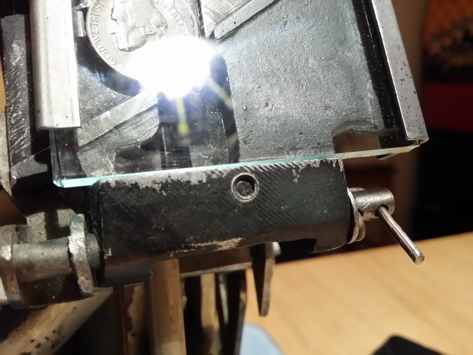

Does anyone have the bronze piviting lever that mounts at the bottom of the escalator?
You can clearly see where the sholder screw has snapped off in the threaded hole for mine!

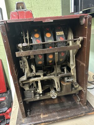

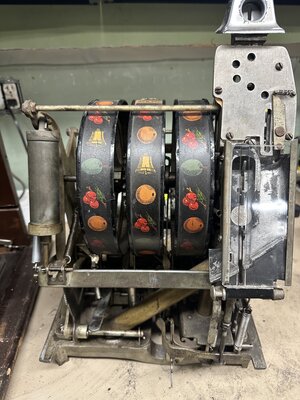

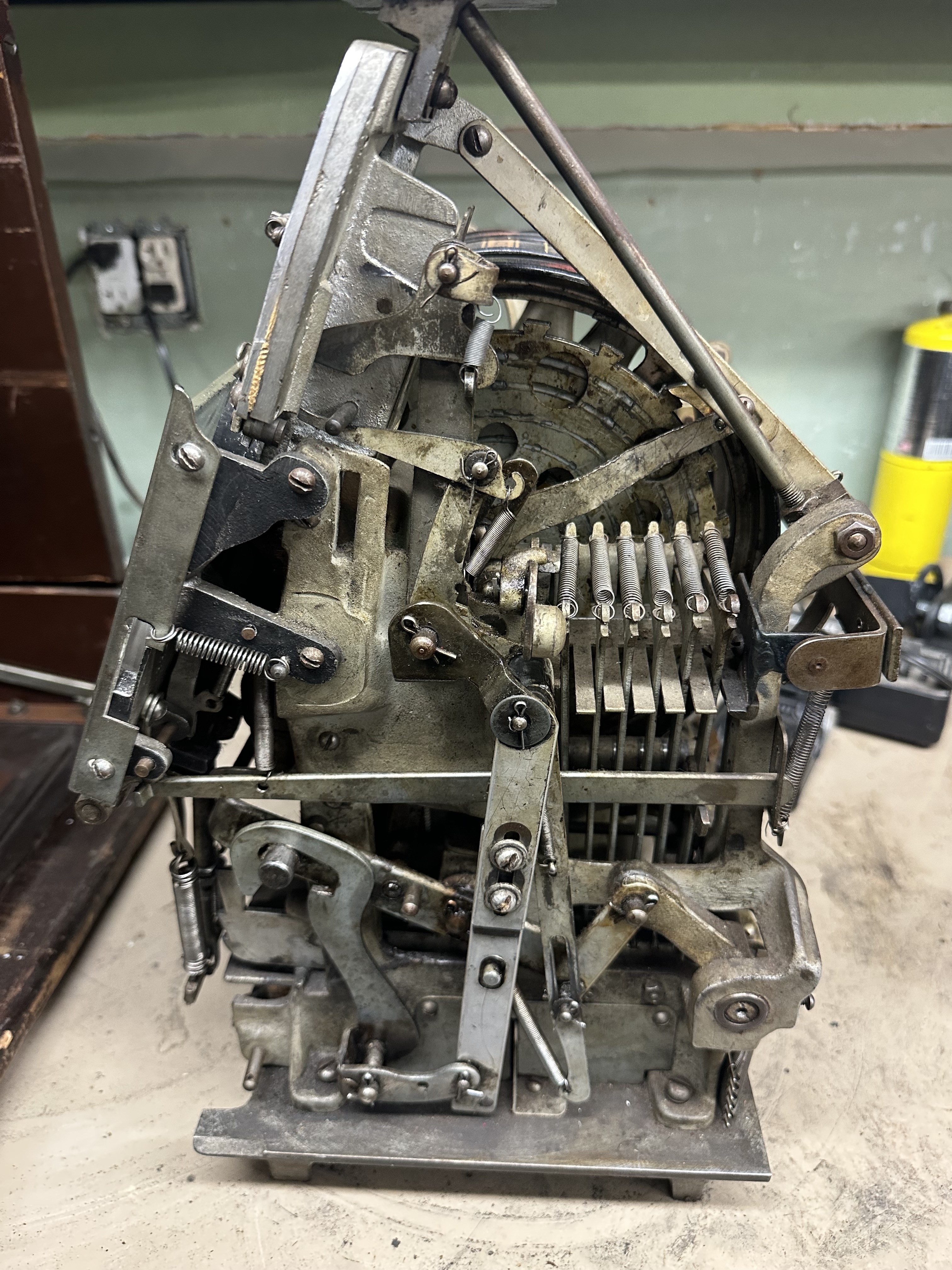

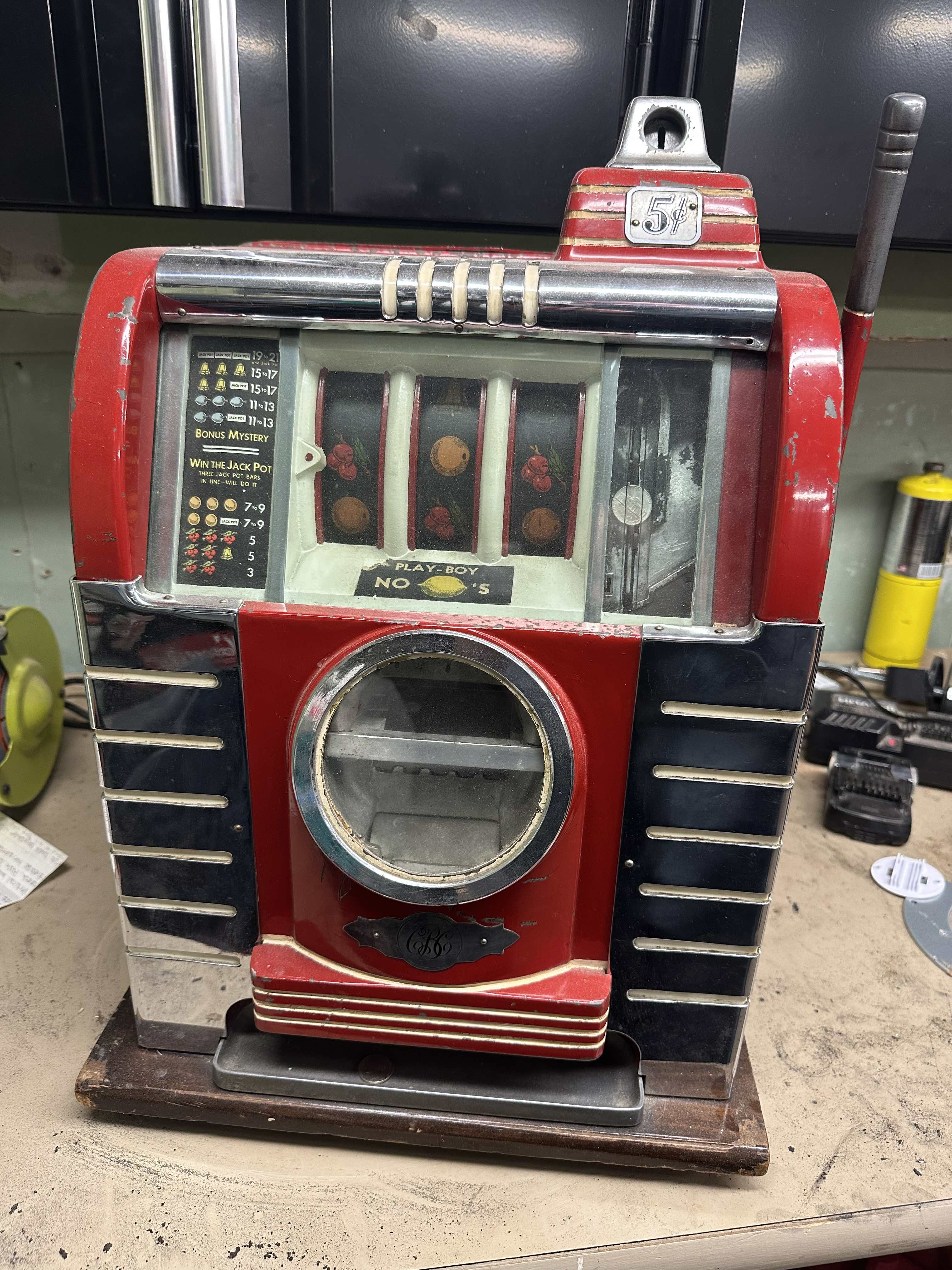

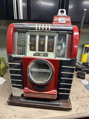

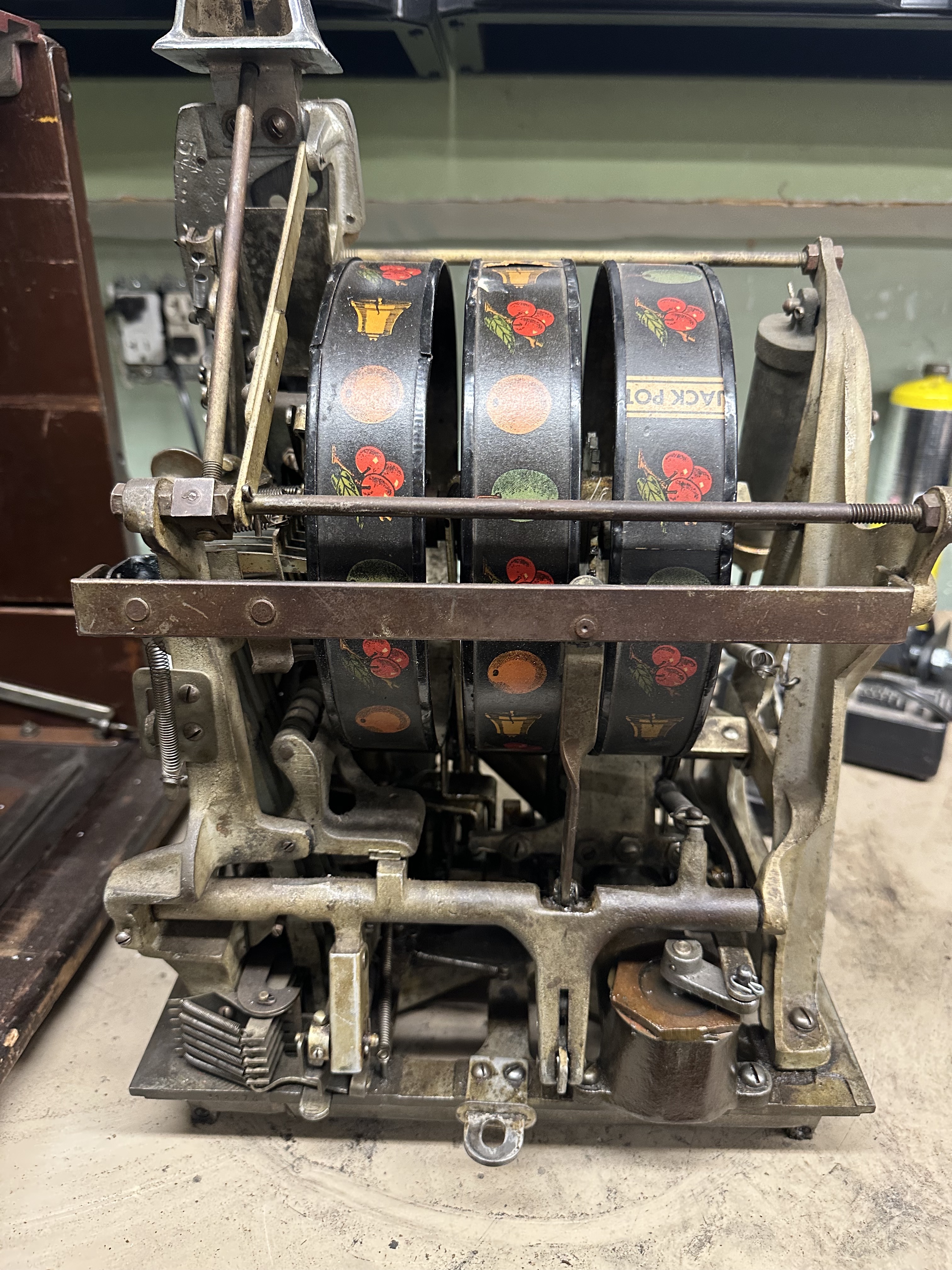

These are so hard to find info about! I was asked by a friend to fix this Play Boy.
When I first got it, seemed like just the nickels had gotten jammed. I went through and emptied the whole thing. Found a jam and cleared it all. Played 20+ games and then RIGHT before I called it good, it stopped on me... and the score reels stopped spinning when you put a nickel in. That was almost a year ago and I'm just getting back to it.
Any tips or info on what to check for the score reels not spinning?

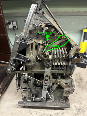

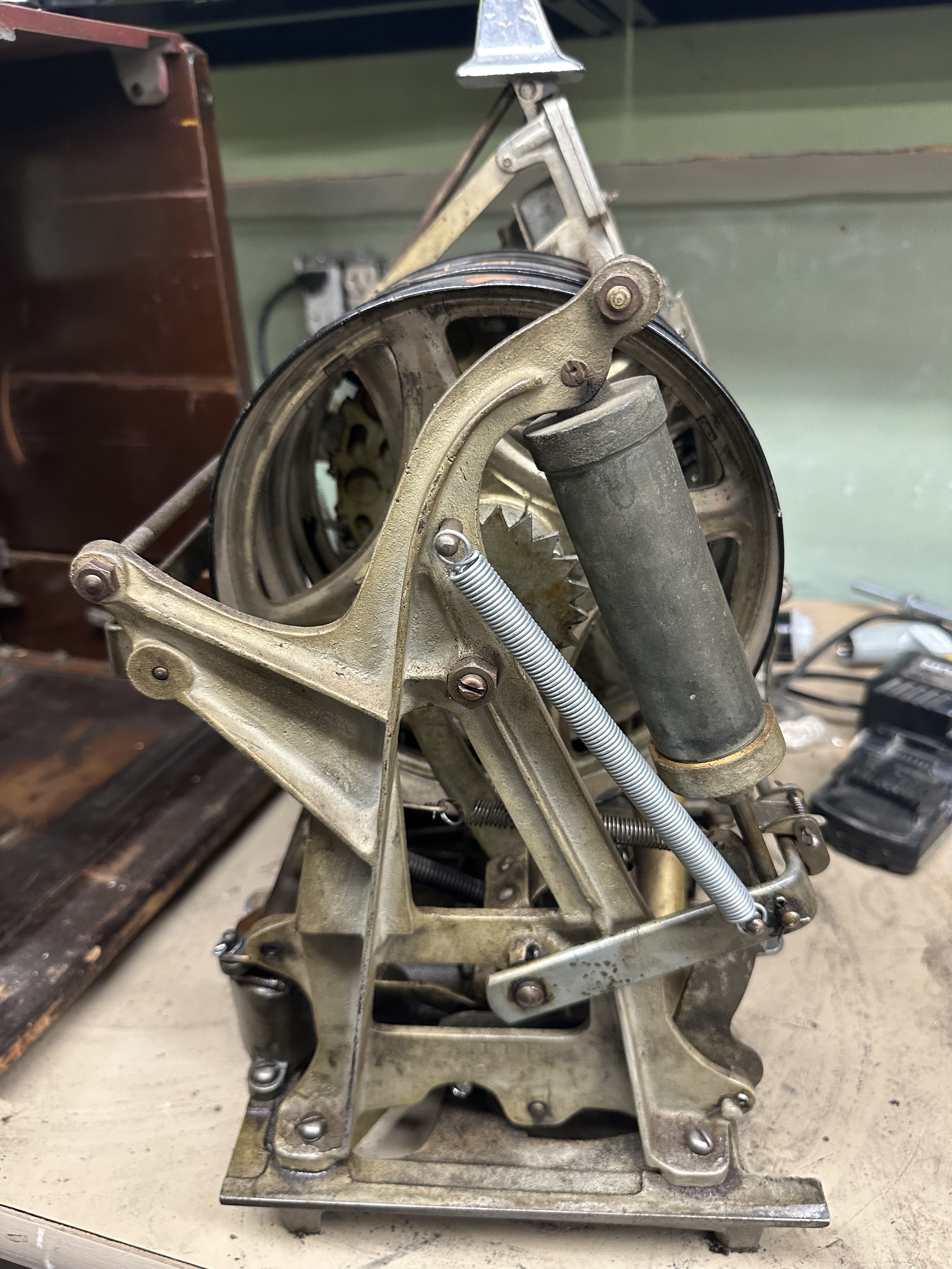

If what you're saying is that the cycle remains intact and runs its course in every aspect EXCEPT the reels don't spin when you pull the handle, then the logical thing to investigate is the kicker assembly. First, look at the kicker itself, specifically where it pivots at the right end of the reel axle; I've found that the kicker hardware can fatigue and break where it straddles the axle... if it's broken, it will easily wiggle side-to-side. That kicker is not easy to replace, as you have to take a lot of the mech apart to fetch and replace it.
Another common kicker problem arises from the slotted shaft that connects to the kicker and actuates it: that particular part is continually being both tensed and compressed, and it will eventually fatigue and bend a little-- and then a lot-- and then it must be replaced (unless you have some way to re-temper it after removing it and straightening it out). Merely inspecting that part is a big chore, as you'll have to half-cycle the mech, drop the escalator (two screws and a spring attachment have to be removed) and then remove the coin tube besides (a single screw holds that) in order to see it. If you find that shaft squished up against other hardware in the mech, you'll know it's a goner. There is a Cadet partial mech carcass on eBay right now for $45.00; it includes a kicker, but I don't see this slotted kicker actuator part anywhere in there... and I think I know why. :(

Thank you for posting! I can get a video if that helps, but you'll have to excuse my ignorance. What is the kicker?

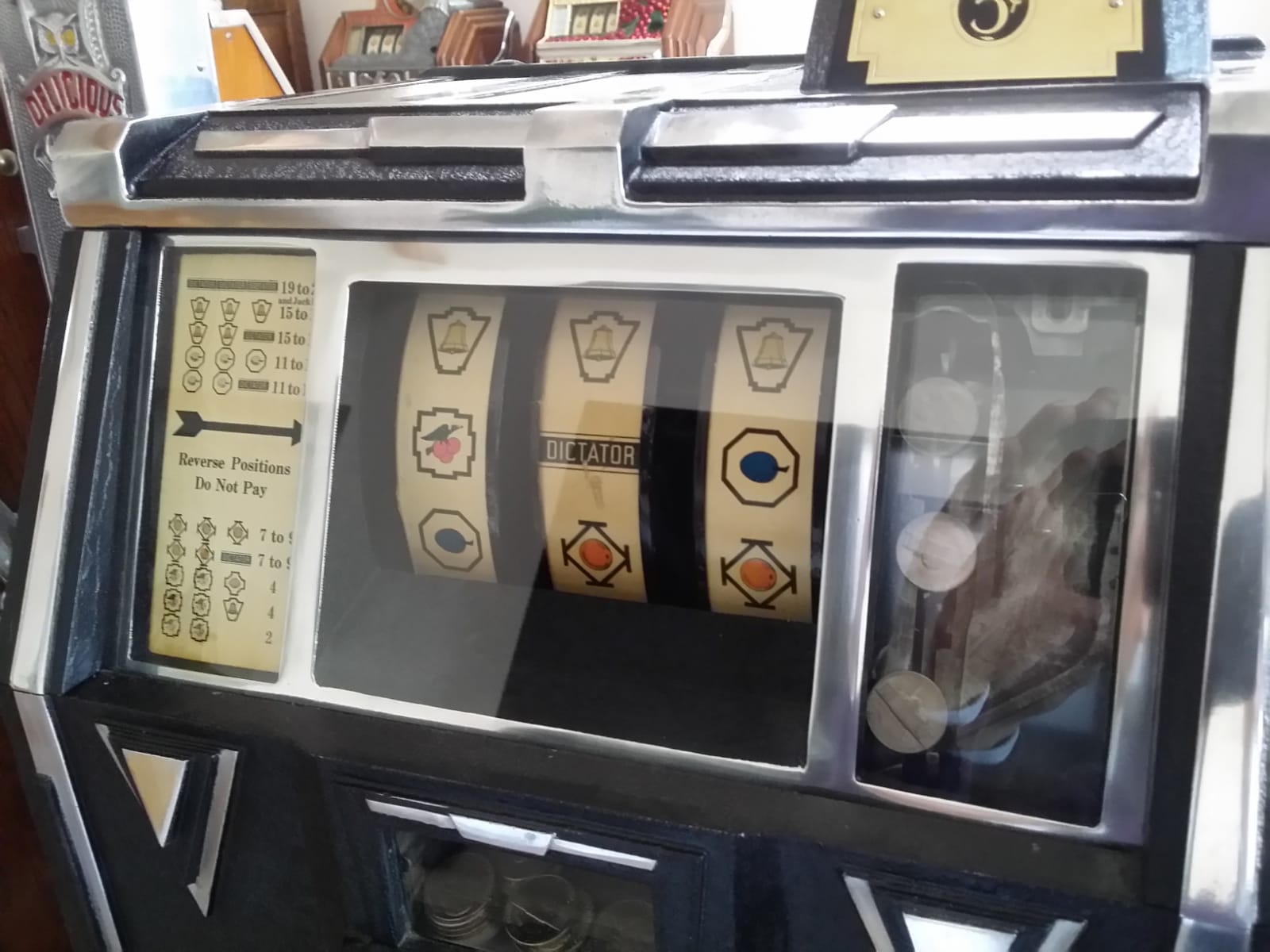

Postby marsonion » Wed Oct 09, 2024 10:57 am
northvibe wrote:Thank you for posting! I can get a video if that helps, but you'll have to excuse my ignorance. What is the kicker?
Are the service manuals from liberty belle books worth getting?
https://www.libertybellebooks.com/2013% ... ement.html
Image attached. I've never found any manual which is truly helpful for servicing the late-model Cailles; I think Bueschel (RIP) had planned to create and publish one, but never found the time (I'm sure he was a very busy man).

Oh that mech is tucked in there.... I can see it being a pain to get out. Ok, I'll go check how that looks when pulling the arm down. Thank you!
