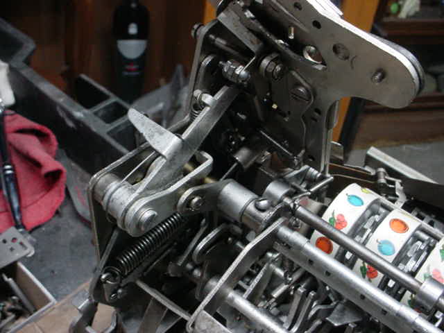

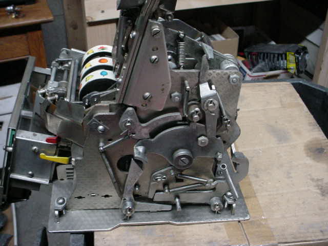

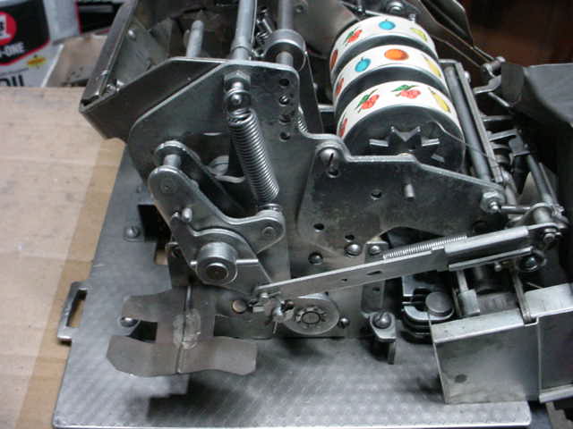

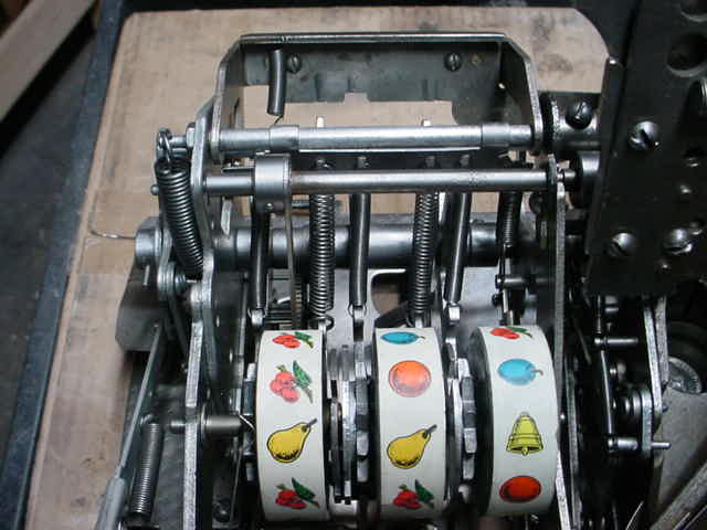

Postby rtmccurdy » Mon Mar 31, 2025 1:08 pm
Here are some general pics of the QT mechanism. It is quite important that all springs on a QT are correct with proper spring size and strength. If not, that can severely impact the ability of the slot to cycle and pay out properly.

Postby apiscione » Tue Apr 01, 2025 11:22 am
The pics were very helpful. Looking at the springs, the ones on my machine matched. However, there’s a space of about an inch to the right of the reels. Looking into that space, there are 2 springs hanging with the lower end not attached to anything. One of them seems to be attached to the bar that is about 2-3 inches above the reels.
