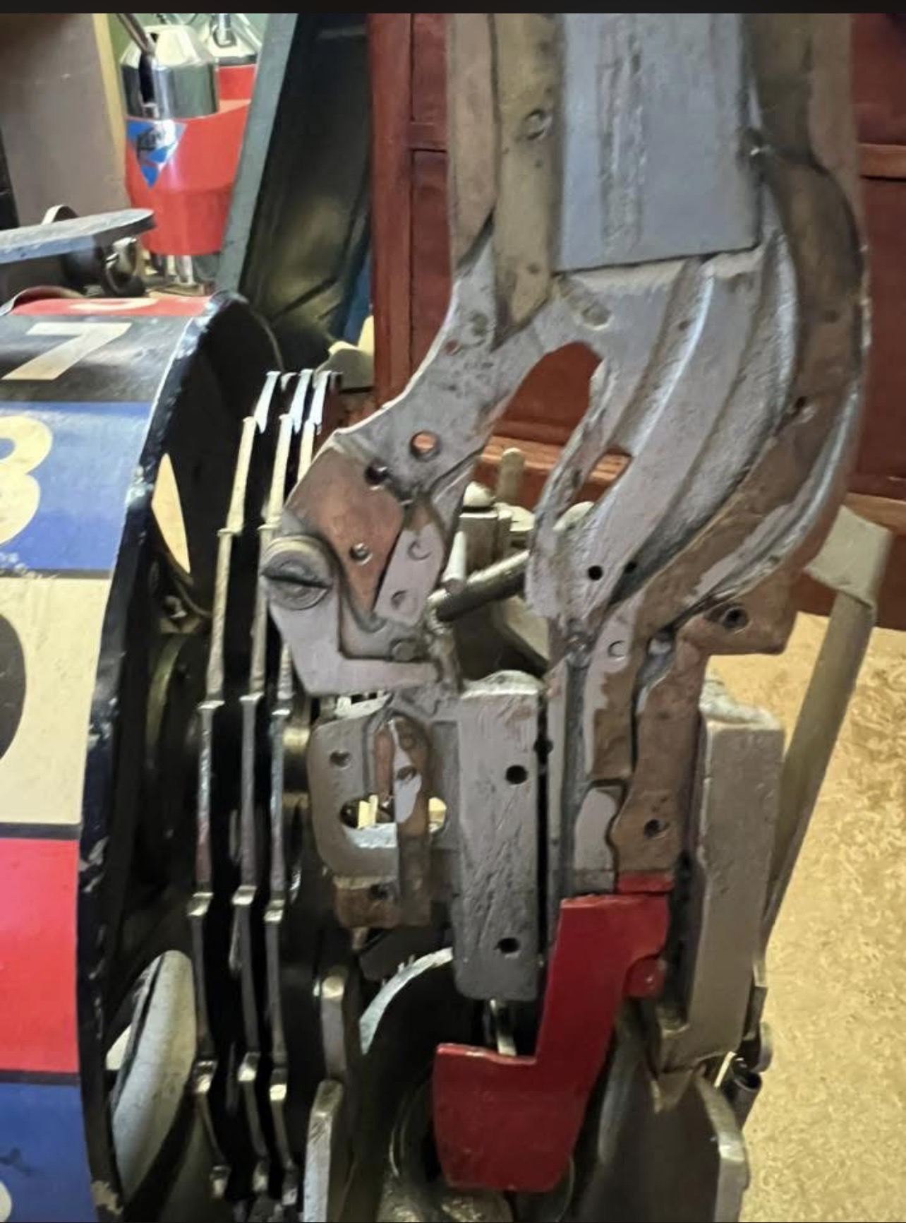

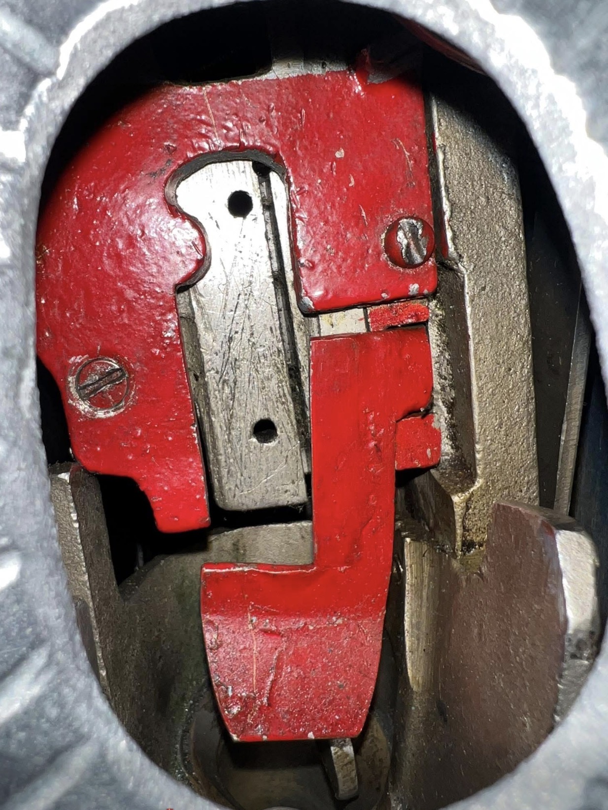

I did not explain the operation of the gooseneck clearly on my reply, there is more to the proper operation of a gooseneck coin advance than what I previously mentioned, I took some pictures of a gooseneck that I have, besides the coin return the rest of the coin head is the same, there are two coins held in the view area plus the one coin played, as the coin travels down there are two levers on the left side, the top one holds the coin played in place till the coin advance arm pushes it down, the lower lever holds the two coins previously played in the view position, when the coin advance pushes the played coin down that coin pushes down on the previously played coin and the coins push that lower lever over letting the bottom coin to drop, the two levers on the rear of the coins is a anti cheat, they keep the coins from being pulled out, the lever above the coin advance bar will hold a extra played coin from jamming till the coin in play is pushed down, I think the pictures on this link are better on understanding the operation of the gooseneck.

Postby jerryt » Sat Dec 20, 2025 9:43 am
Amazingly useful… Thank you
I can see it clearly now
Seems it’s missing from mine, so I’ll need to hunt one down

Postby altort » Sat Dec 20, 2025 11:56 am
No problem, looks like you are missing a few parts, not hard to find they come up for sale quite a bit on ebay, you may find a complete gooseneck, looking at your pictures looks like you have a 20 stop meh, never seen a poinsettia 20 stop before, interesting, what is the history of your slot if you know?
