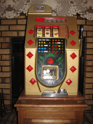

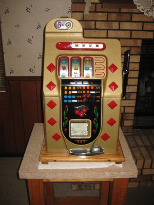

Postby oldslotman » Mon Jan 02, 2017 8:20 pm
Here are two machines, one is original and one is recast. The 5 cent machine on top is original, the lower is a recast. Look at where the top and bottom castings meet. The original one will have the small lip on the top and the recast will have a wider lip on the top.
