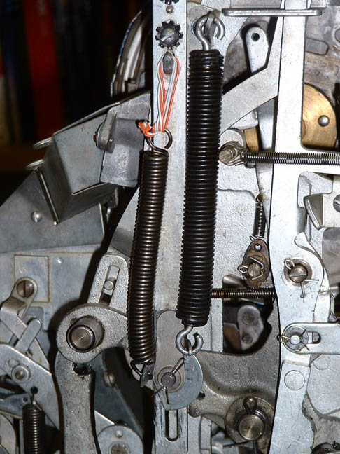

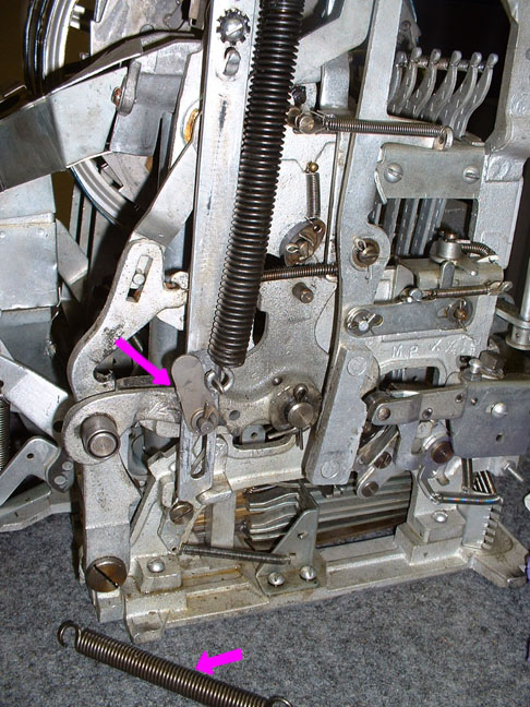

I have exactly the same model and denomination, and your story calls back a memory of when I first got the machine out of packing: the damn thing didn't work! Then I noticed a loose spring rolling around the bottom of the cabinet... I thought, "oh great, they sent me an extra spring!" #-o
Turns out the problem was a spring retainer that had broken off so cleanly it was hard to see that there was anything wrong with the part that the loose spring used to be attached to. I ground-out a washer into a hook as a quick-and-dirty fix, and got the guy who sold me the machine to send me a proper replacement part. (Oops-- I realize now that I never really got around to installing that :oops: but the Chief has been running fine in this condition for years.)
I'd like to help you but my machine is over 500 miles away from me right now. I'm posting the only pictures I have handy, just in case they're useful to you. With regard to the situation you describe, however, if it were me the first place I'd look is the reel kicker, to determine whether your loose springs have anything to do with that function.
