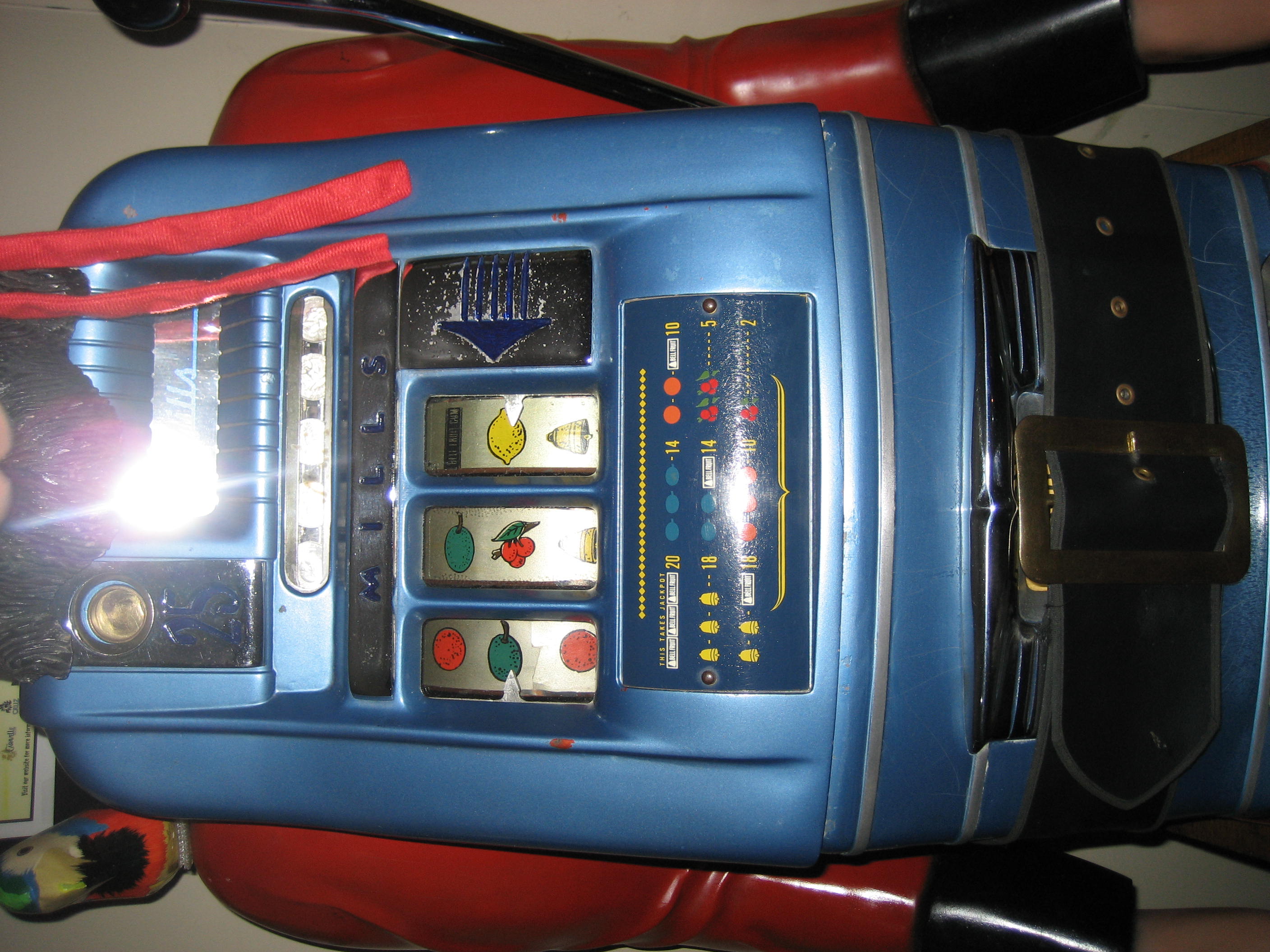

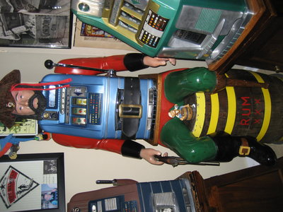

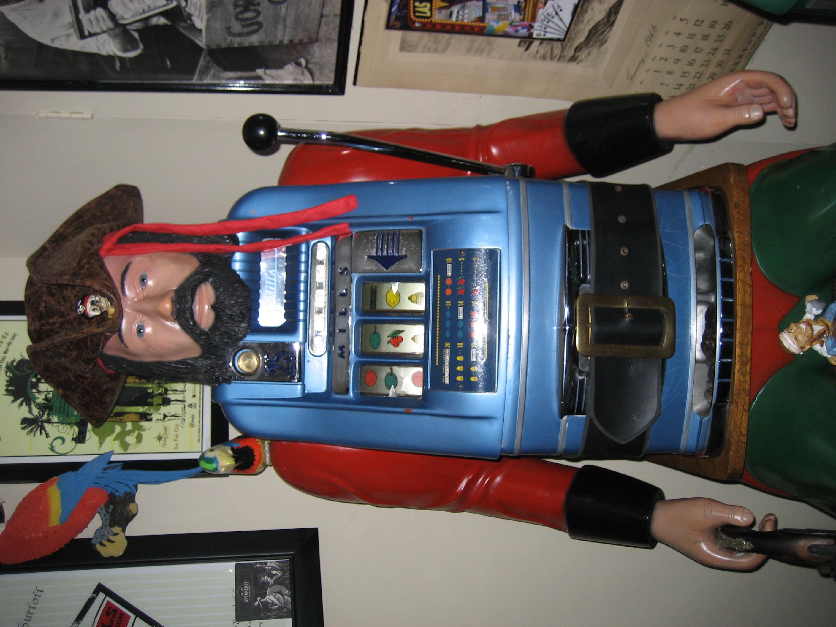

Hello, New to the site and just wanted to share. I recently purchased this Dick DeLong carving with the 25 Mills. The machine was a little beat up but I got it up and working nice. Thought it was the coolest machine and I got it for a steal I was at the right place at the right time and the person wanted it gone NOW. I tapped out on the Ballys to many problems with solenoids and relays, now just with the mechanical much more rewarding. I now have 8 machines Mills/Jennings. So I'm not 100% if the machine that's in my carving is the original only because it was a bonus machine "I think". I put that Mills piece where the bonus should be. Any thoughts thanks

Yes your machine was a bonus machine, at least the upper casting is. The early high top machines including the early bonus has the type of trim around the jackpot that yours does. A simple explanation would be that the upper casting was replaced with a bonus casting or the whole case could have been a bonus case. I would suspect that just the upper casting in your machine was changed as the award card is the blue color that came on the early Jewel Bell the first high top mills introduced after the war. The jewel bell was a blue and purple color, not pretty but it ran well. Silver reel strips are the correct color for this machine and the while the bonus strips in a high top were silver also they have letters over the fruit symbols on the first reel. A lot of slot machines were broken into and it was the top casting that was broken when machines were broken into. So it is not uncommon to have a casting replaced on a slot machine. Hope this information helps

Thanks for the info. So I was pretty much on target. Have never seen this type of DeLong carving of a pirate so again thank you.

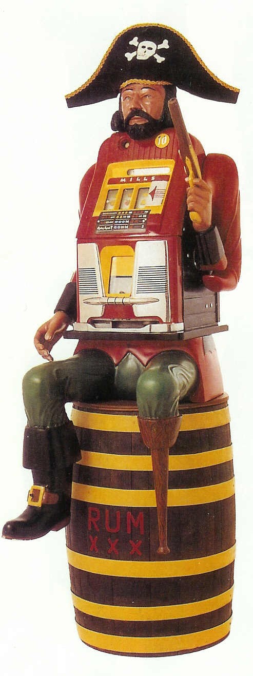

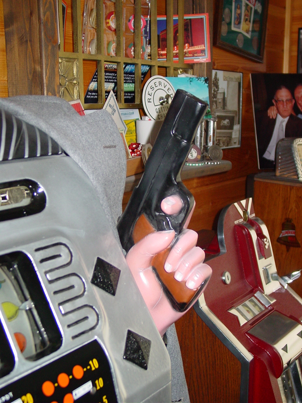

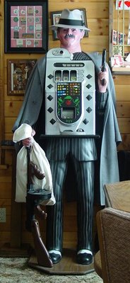

Dick Delong did many different carvings and this picture here below of the Pirate is from a Brochure I carried in my shop to promote his work in about 2005!
He was out of Johnsonburg, PA. at that time!
Last time I spoke to him arthritis was getting the best of him and his son had taken over but it has been a while since then so I don't know if he is still in business!
He also did a lot of Carvings for the Mill's QT!
I still have his brochure in my shop files, have to dig it out!

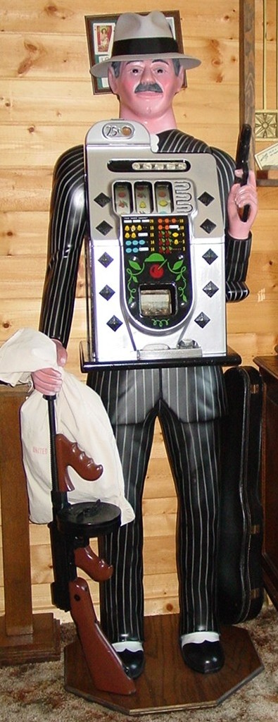

Being Sicilian my favorite was the Gangster he did special for me, Great Guy!

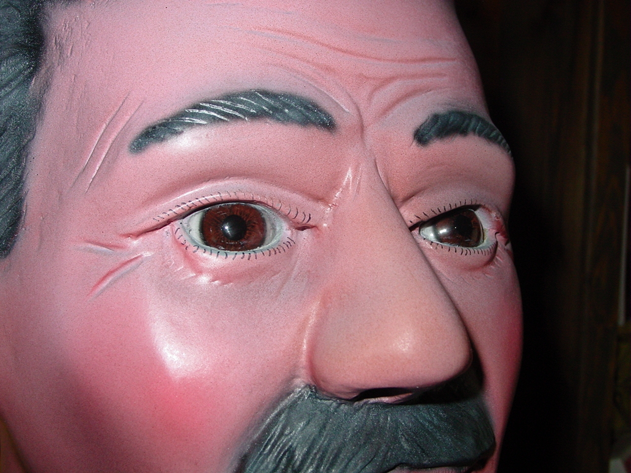

Many celebrities had his carvings which he made out of Bass wood, a type of wood that was local to his state, a couple of the celebrities were Frank Sinatra, Tanya Tucker, Jay Leno, Etc.

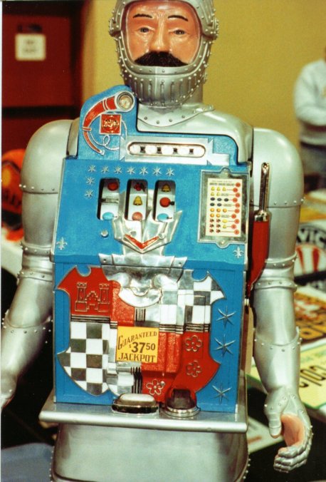

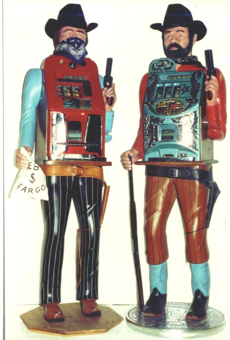

He also used glass eye's in his figures in the later years like in the one shown below as well as a couple other photos below, one of a couple cowboys from his literature and a custom made Knight with a Mill's Castle Front he sent me a snapshot of while he was working on it in his shop!
