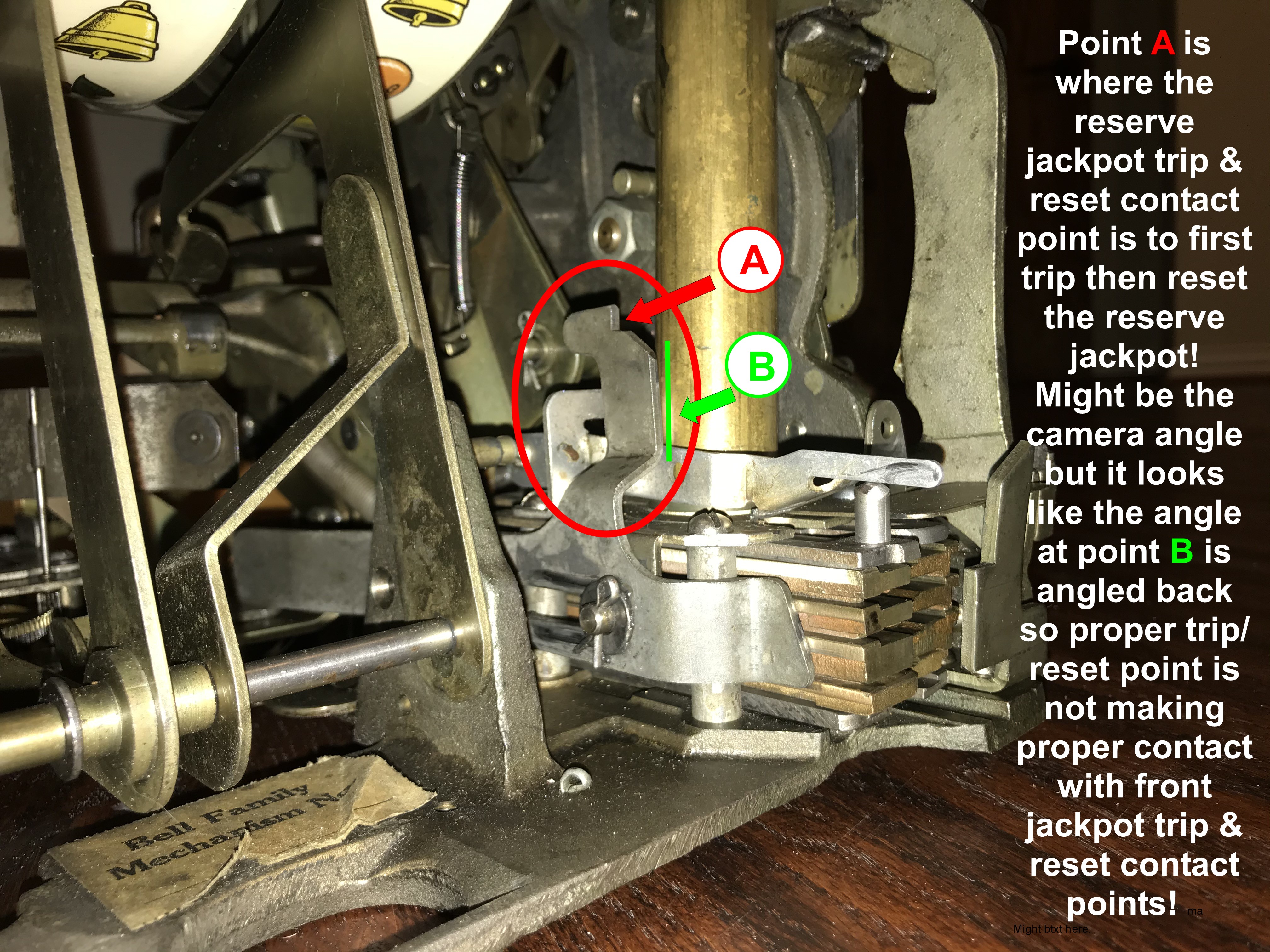

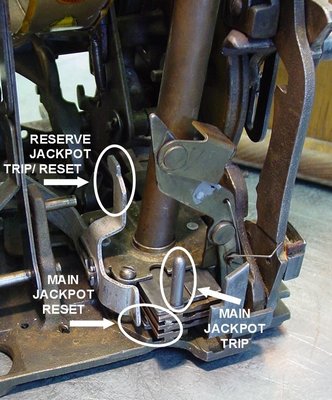

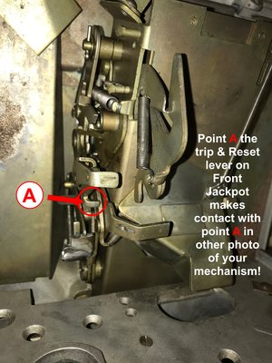

Your posts, explanations, and pictures are the best I've seen so I hope you can shed some light on a similar issue I'm having with my 1946 Mills Black Cherry reserve jackpot. I'm a newbie at all this so please be patient with my lack of expertise.
Everything works on the jackpot payout except the reserve does not trip to reload the jackpot when it is won although it is full of coins. I have no idea if parts are missing, there's a misunderstanding on my part, an adjustment issue or something else. I just purchased the machine and everything appears to be clean and in working order. I'm about to start investigating what's going on so yours, or anyone else's input for that matter, is greatly appreciated.

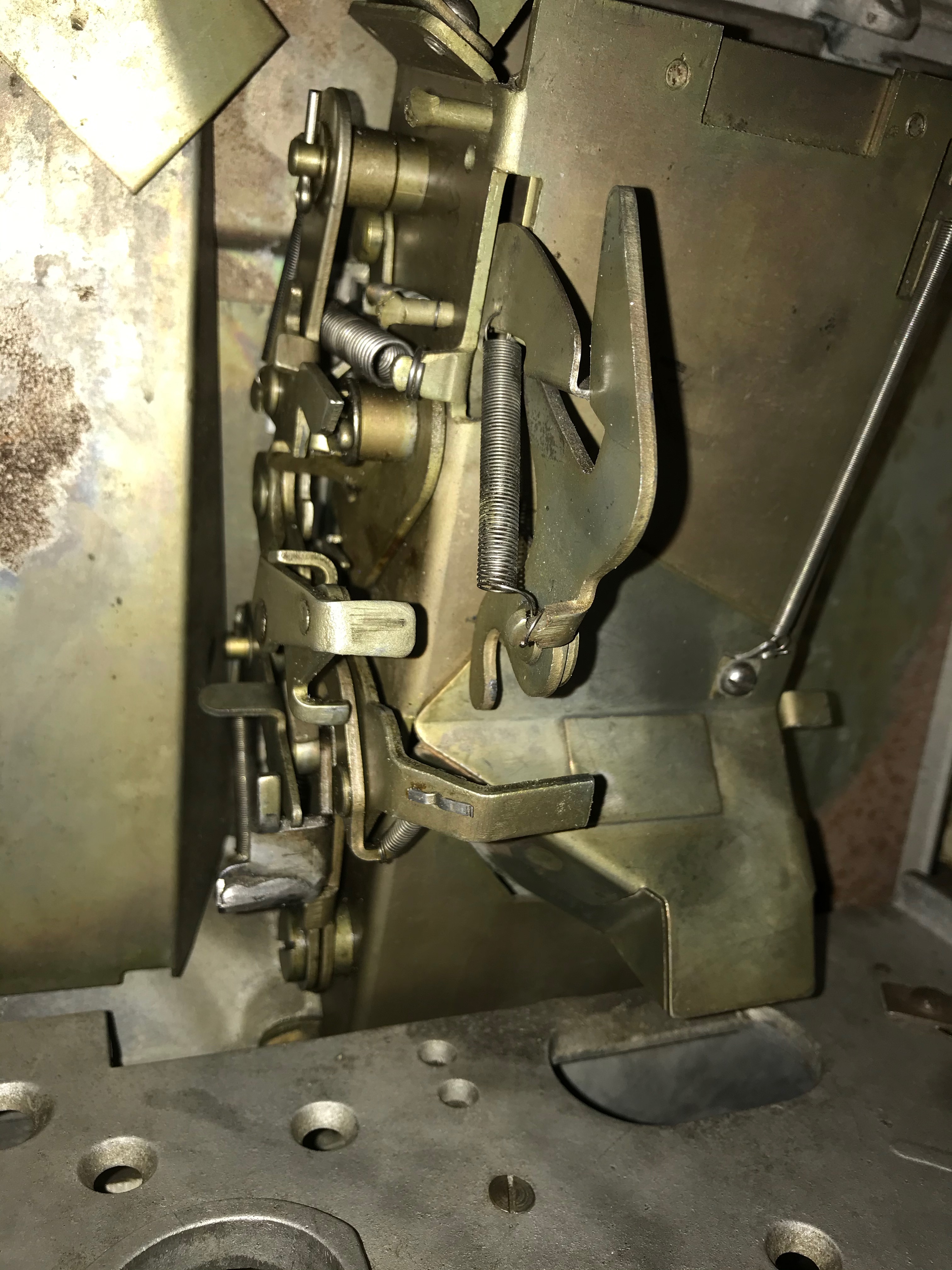

Postby MONTI » Mon Dec 02, 2019 10:42 am
Hello Harley Hound!
Don't feel bad because the front jackpot interaction with the mechanism in a Mills slot machine can be somewhat overwhelming to understand as in slot machines for every action there is a reaction and if one action does not occur there can be a failed operation!

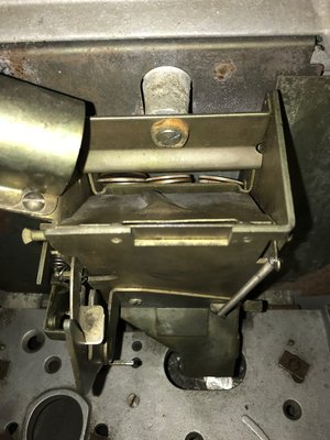

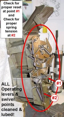

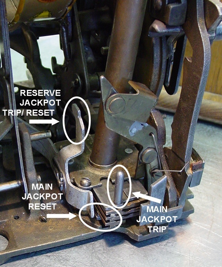

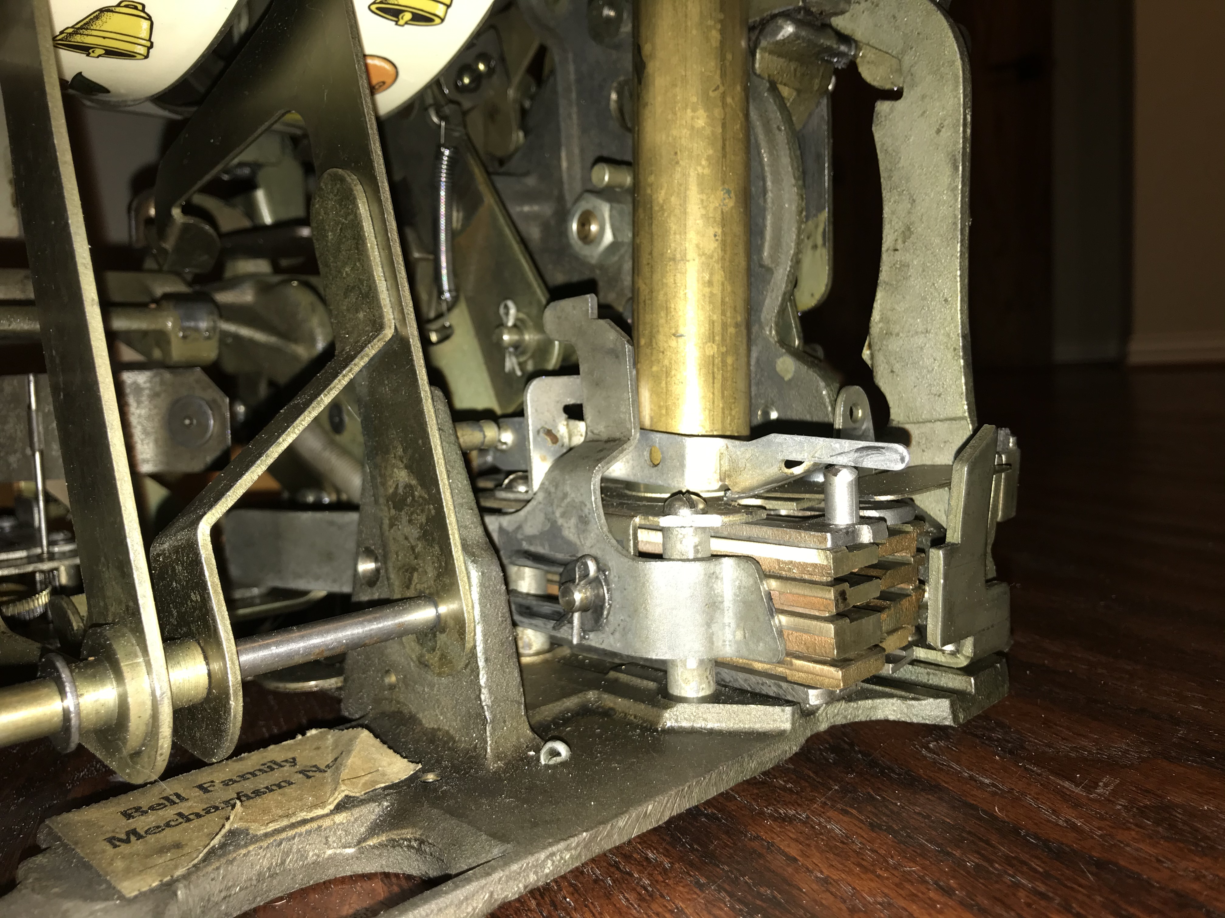

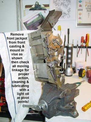

That being said I have some photos posted here below, the first two are of your components with comments on the photos and the others are general photos describing operation with the last being the removal of the front jackpot and vise mounting so that you can bring action to the assembly and follow it thru to see how the operation works and also, if needed, clean the gunk left by previous lubrication and re-lubricate with a light oil for proper operation!
All of the interaction between the mechanism and the front jackpot needs to have all contact points interacting properly or in your case an action, like tripping and resetting the reserve jackpot will not occur!
Also, the photo above in a previous post on this thread also describes the operation in more detail!
Visually seeing this with the mechanism in the cabinet can be hard but with proper illumination from the back of the mech and looking thru the mech the interaction points can be seen, if, and this is a big IF, you know what you are looking for!
Absolute worst case scenario the upper casting can be removed so you can illuminate and look straight down on the contact points but this is time consuming!
Kind of hard to go thru all the points here but if you have further questions or wish to make contact with me you may PM me and from there we could possibly communicate by phone as well!
BONA FORTUNA!
