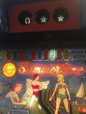

Postby jayram1408 » Mon Aug 20, 2018 9:22 pm

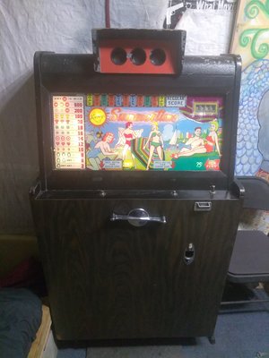

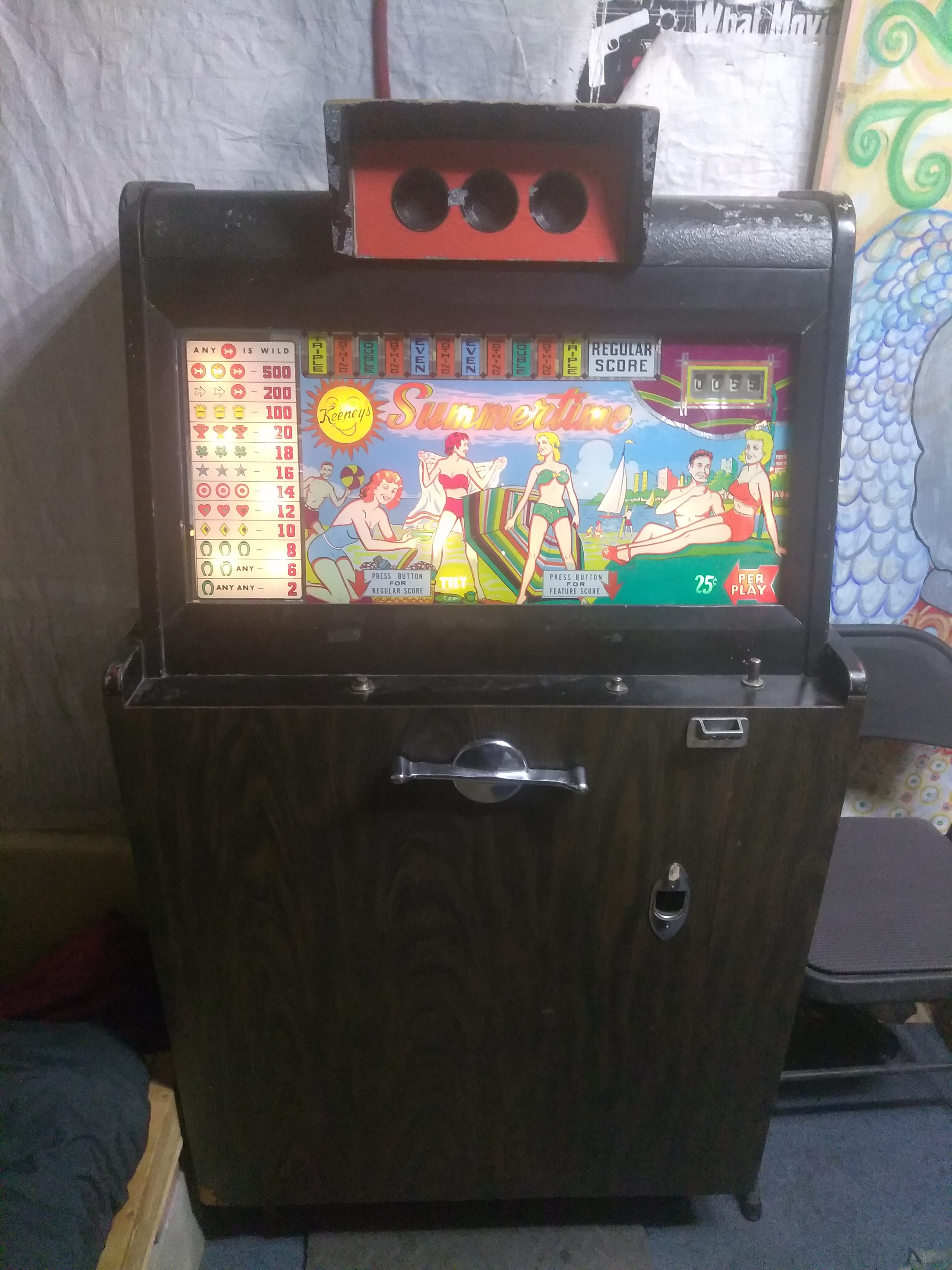

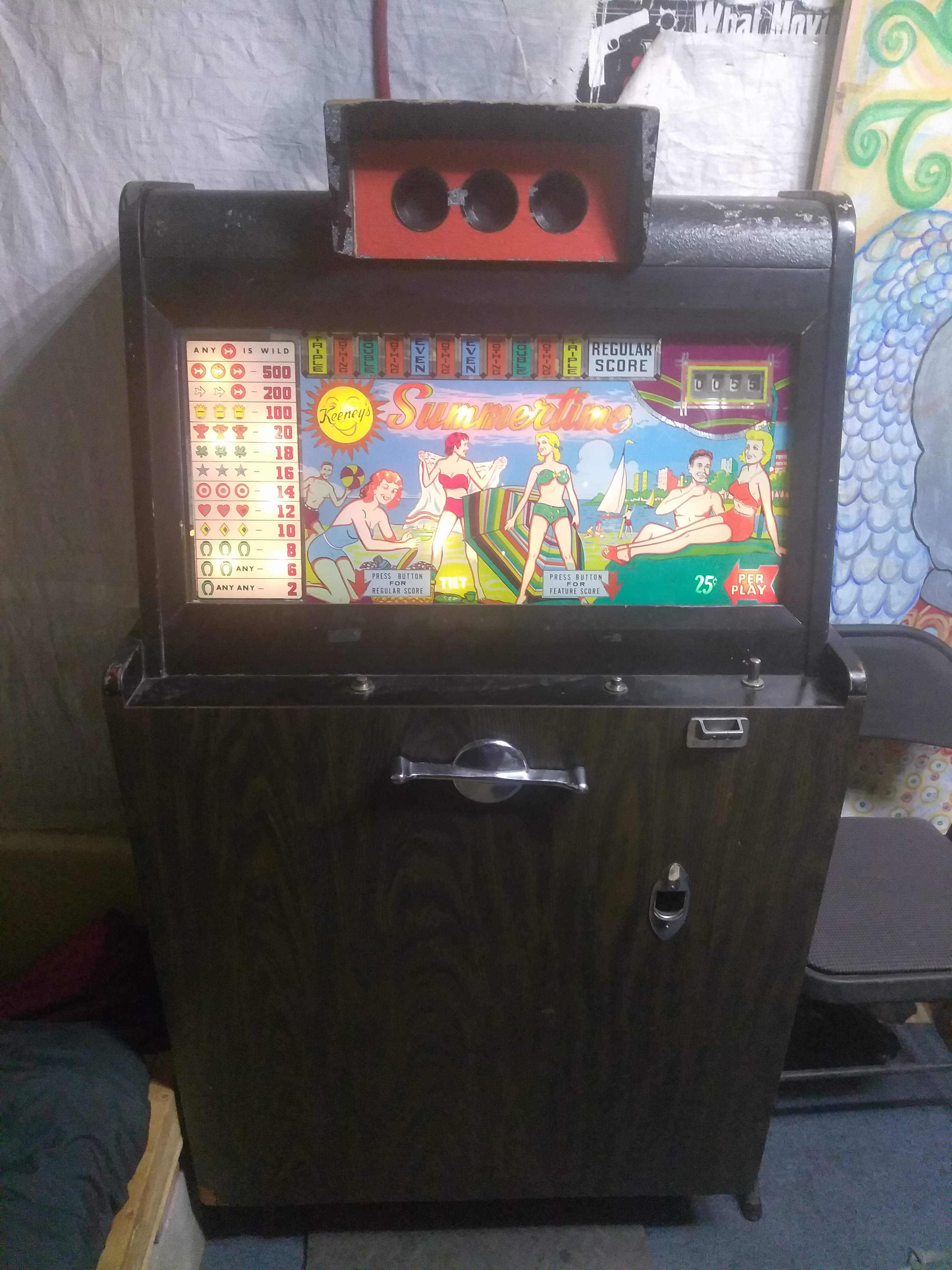

I was super lucky to get this off Craigslist for FREE. It works but is a little off sometimes? I think there might be some adjustments that I do not know how to do. Is there anyone familiar with this machine and does anyone know where I can get or buy a manual and schematic for this machine? Its all pretty much original and in great shape. Just needs the finishing touch. Any help is appreciated. Thanks.

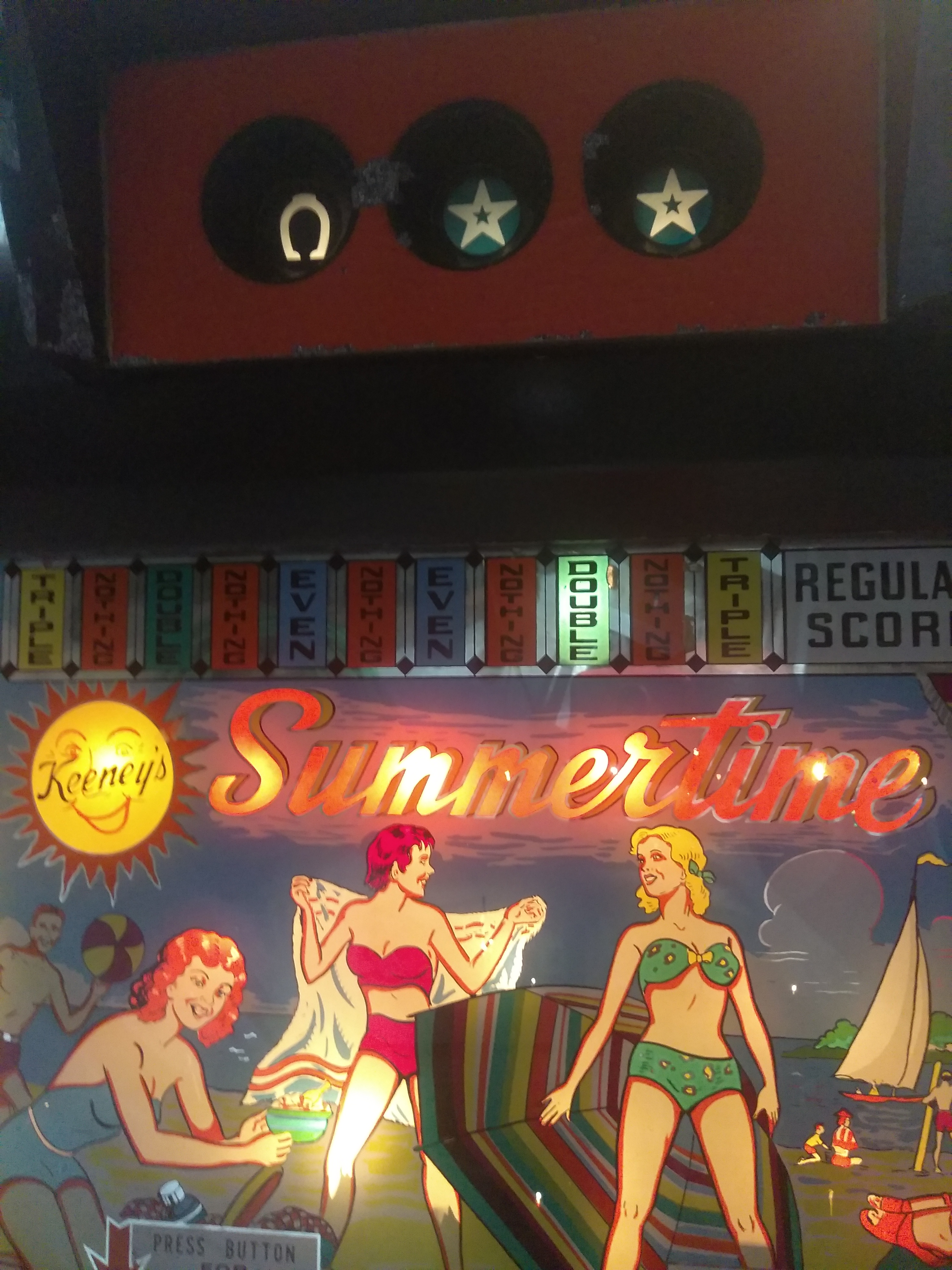

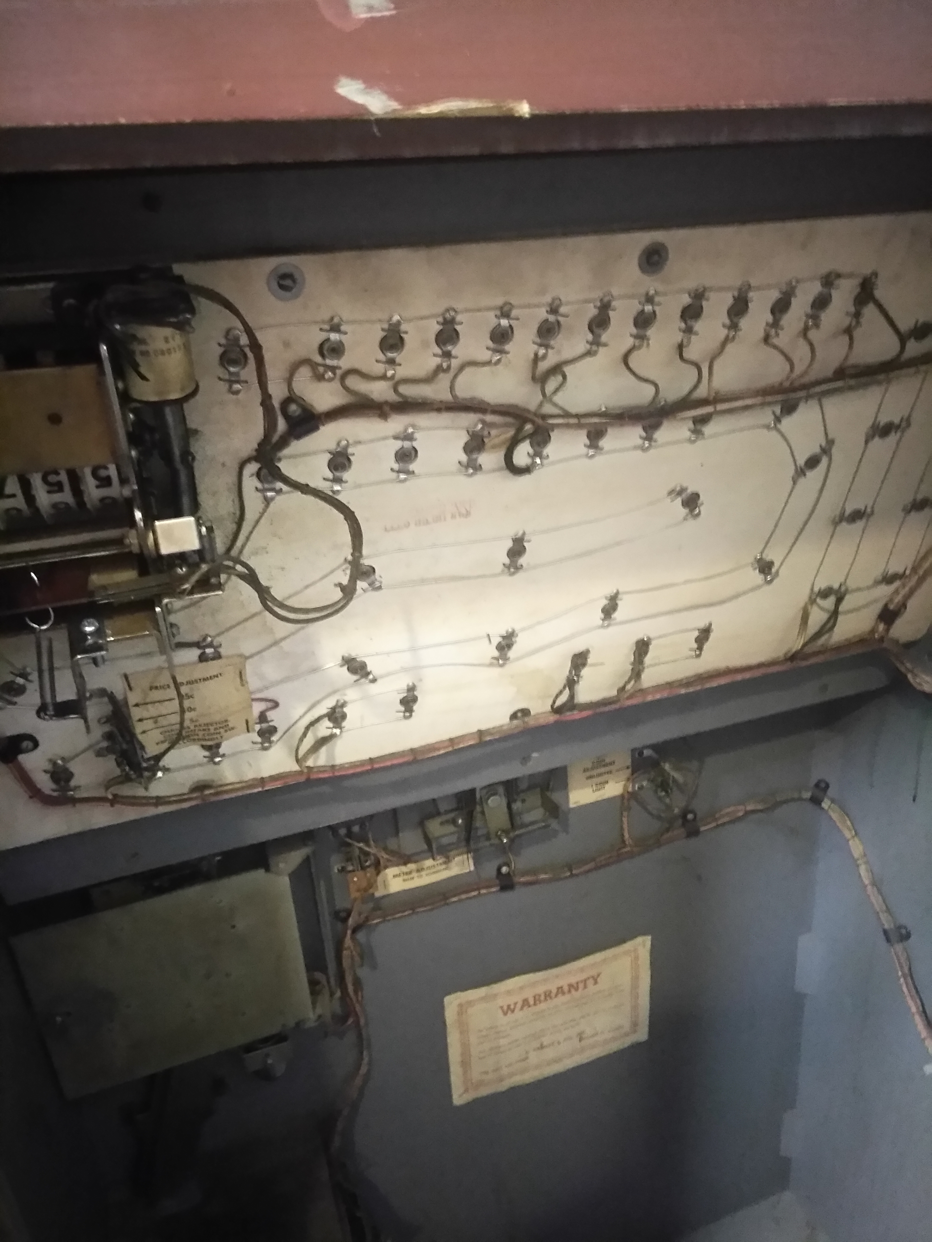

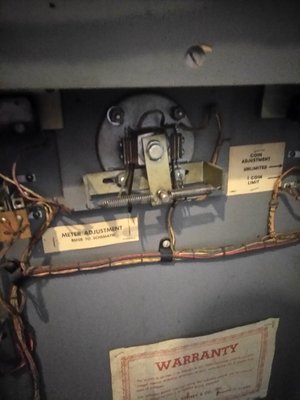

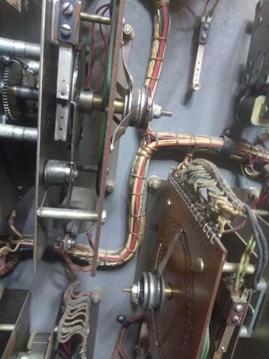

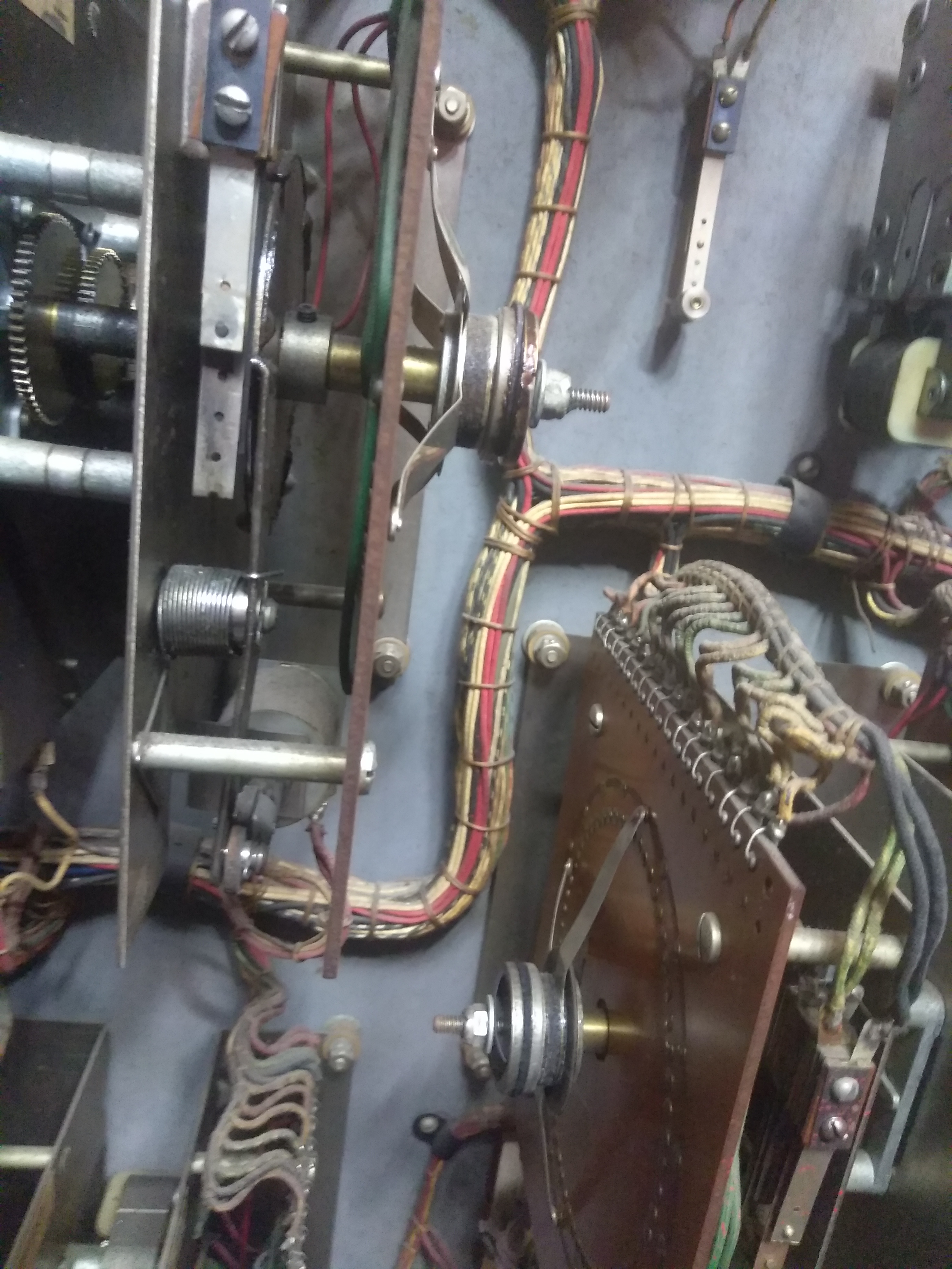

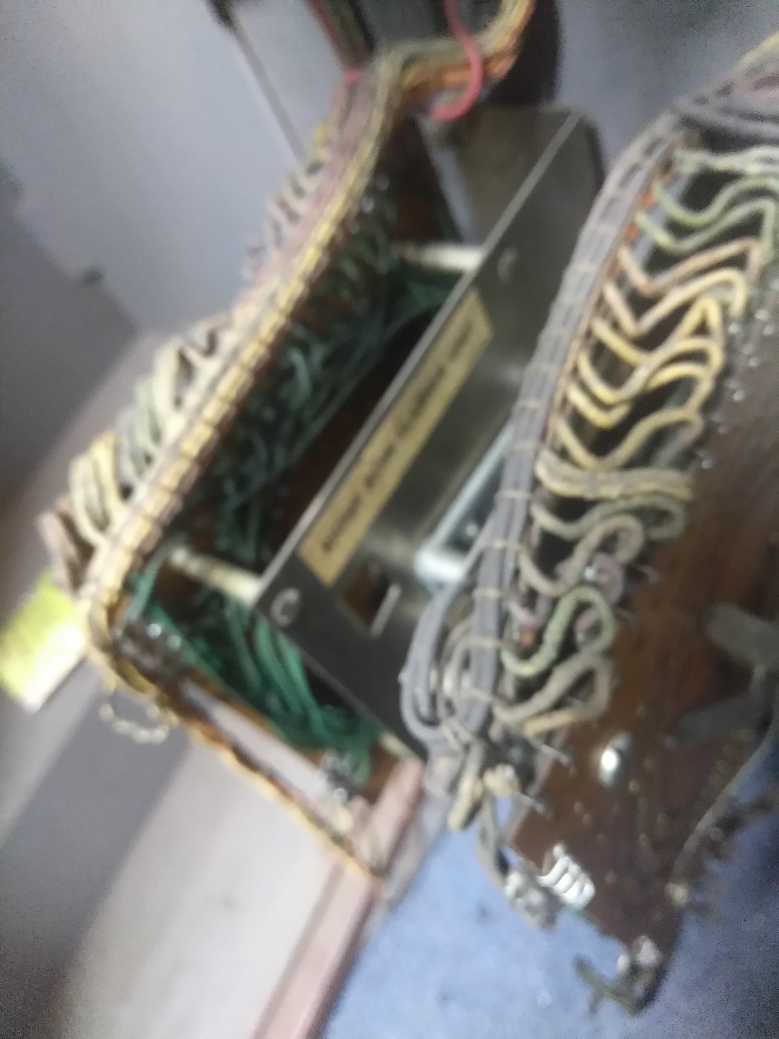

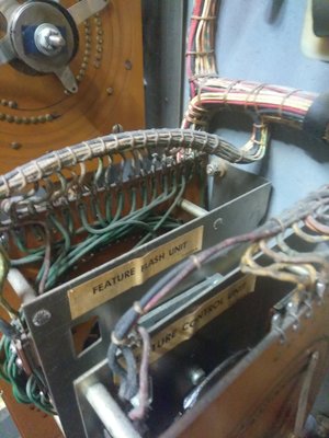

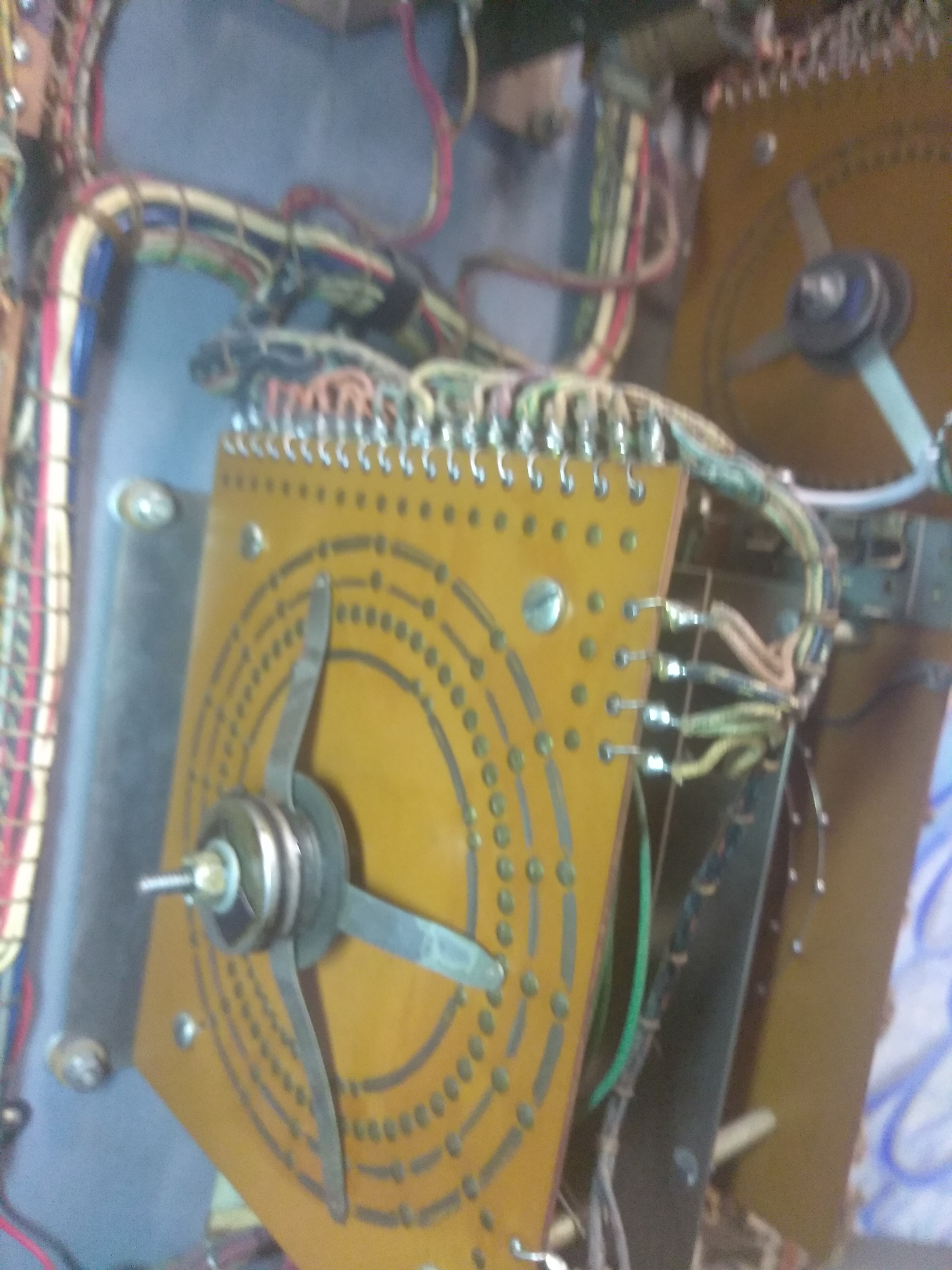

Postby jayram1408 » Mon Aug 27, 2018 8:26 pm

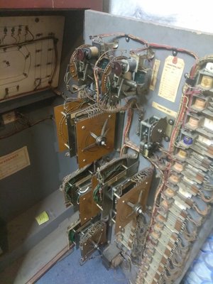

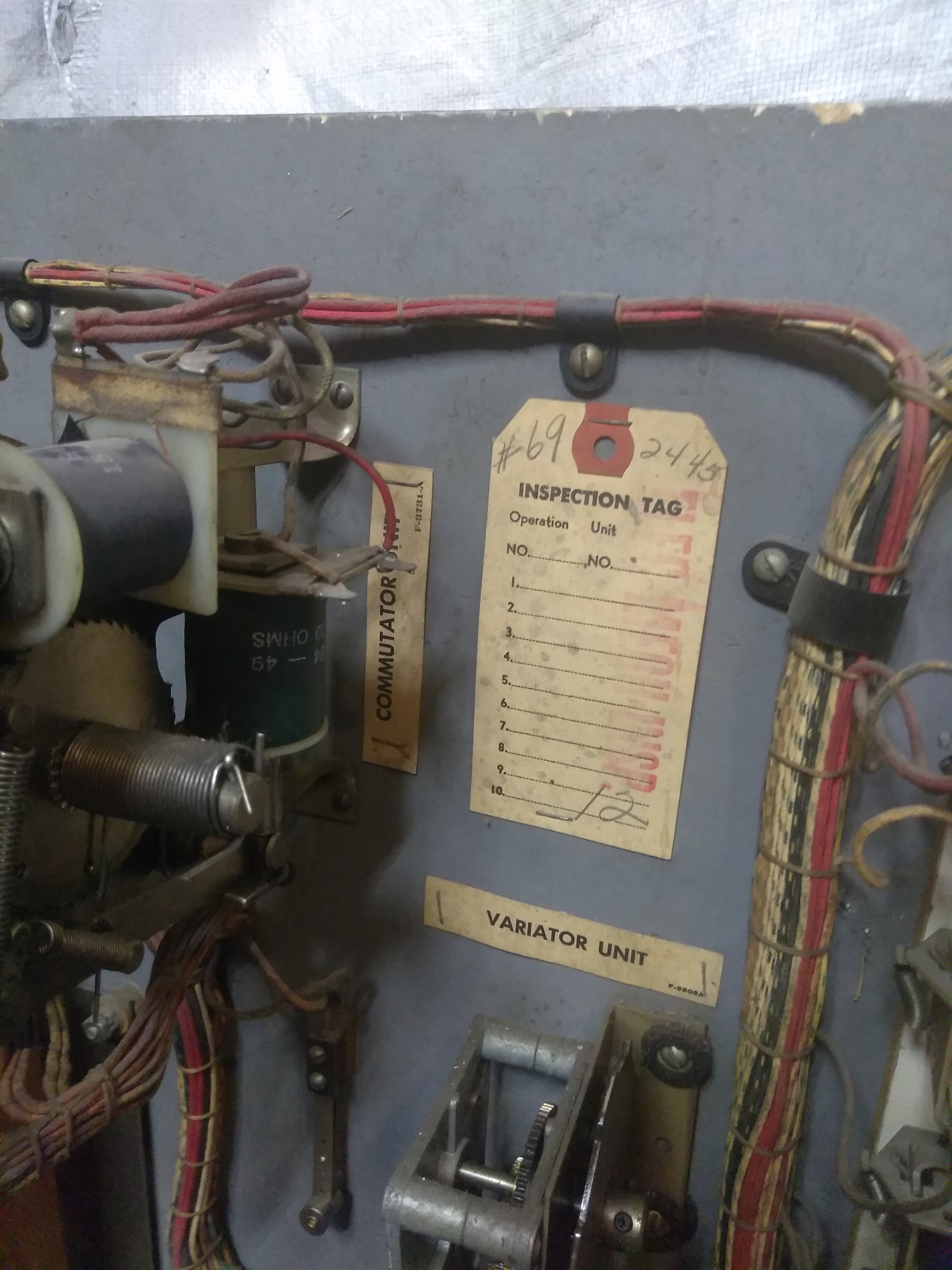

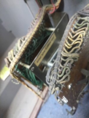

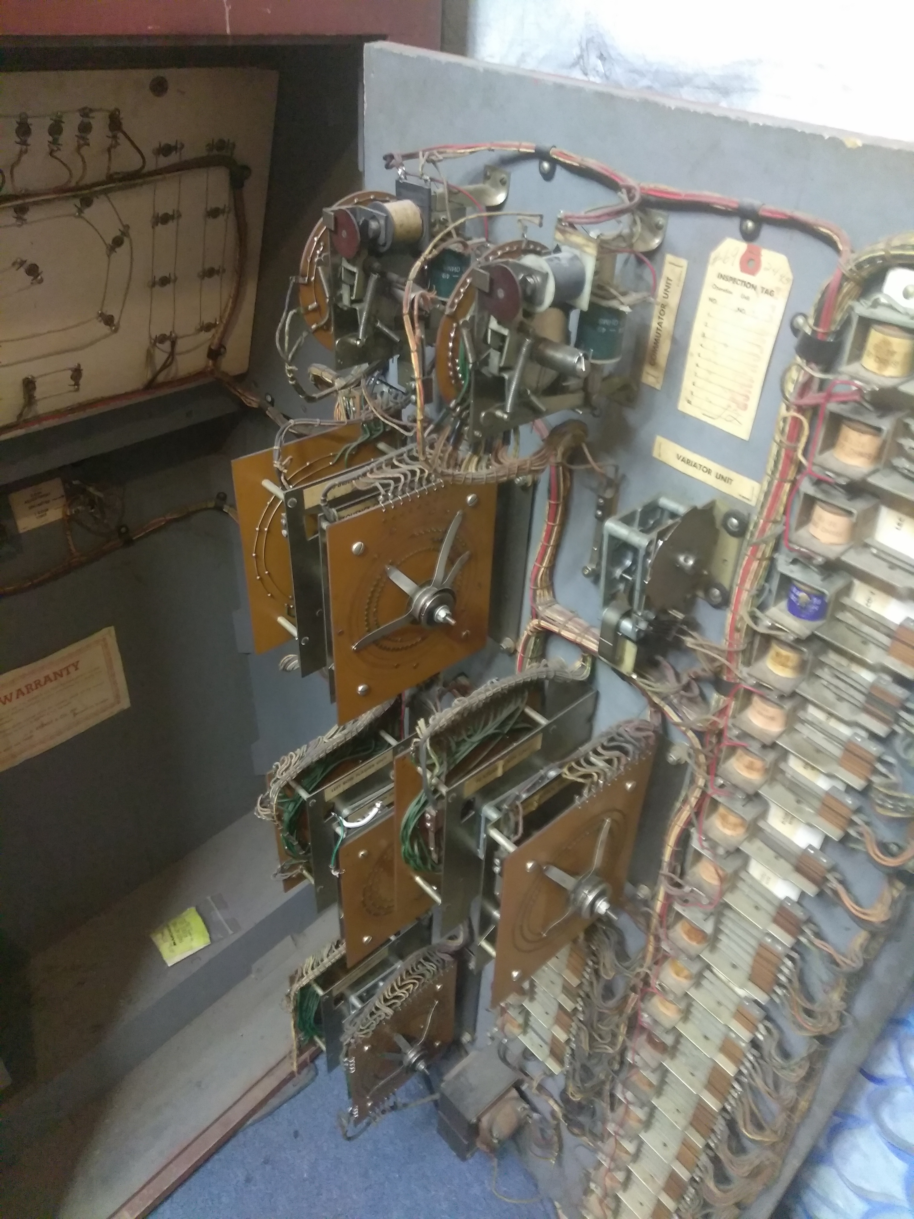

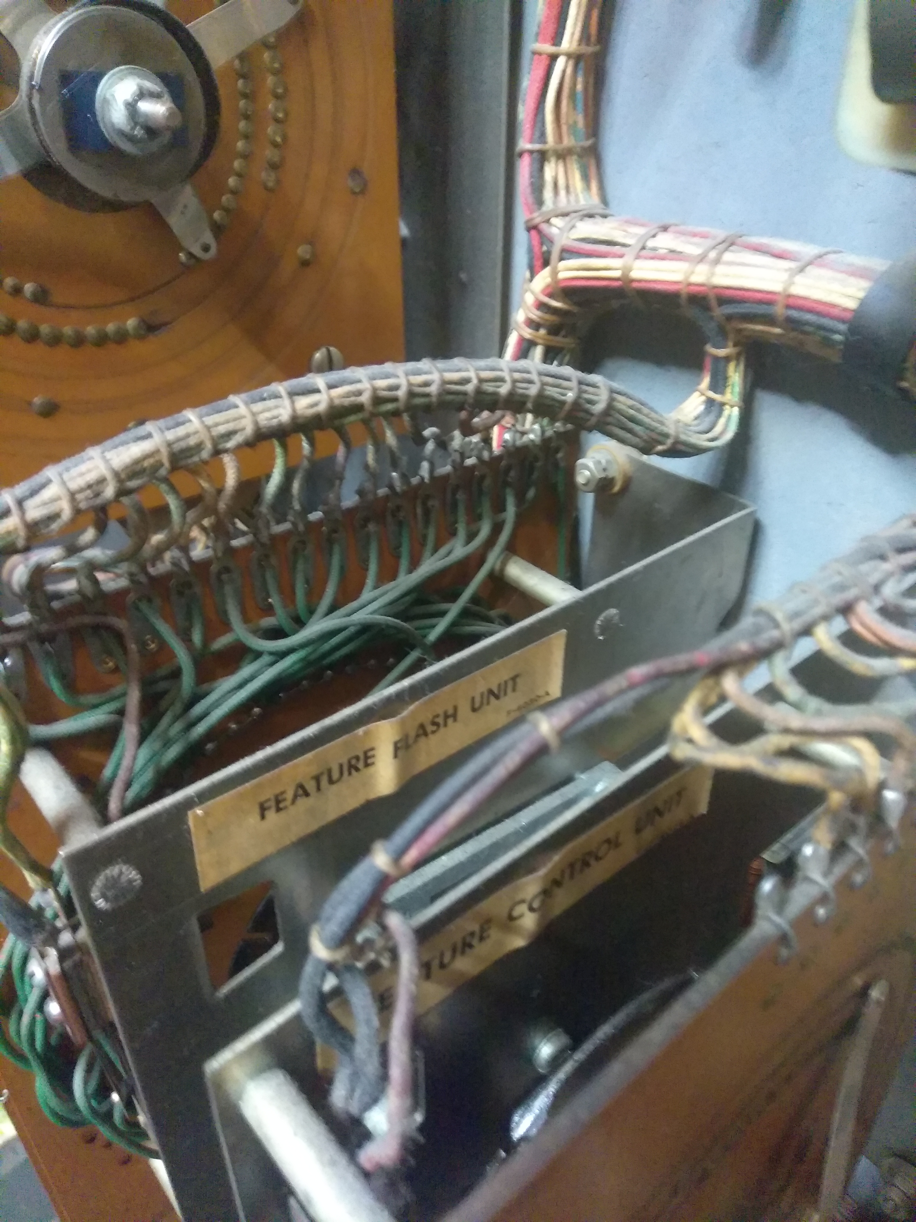

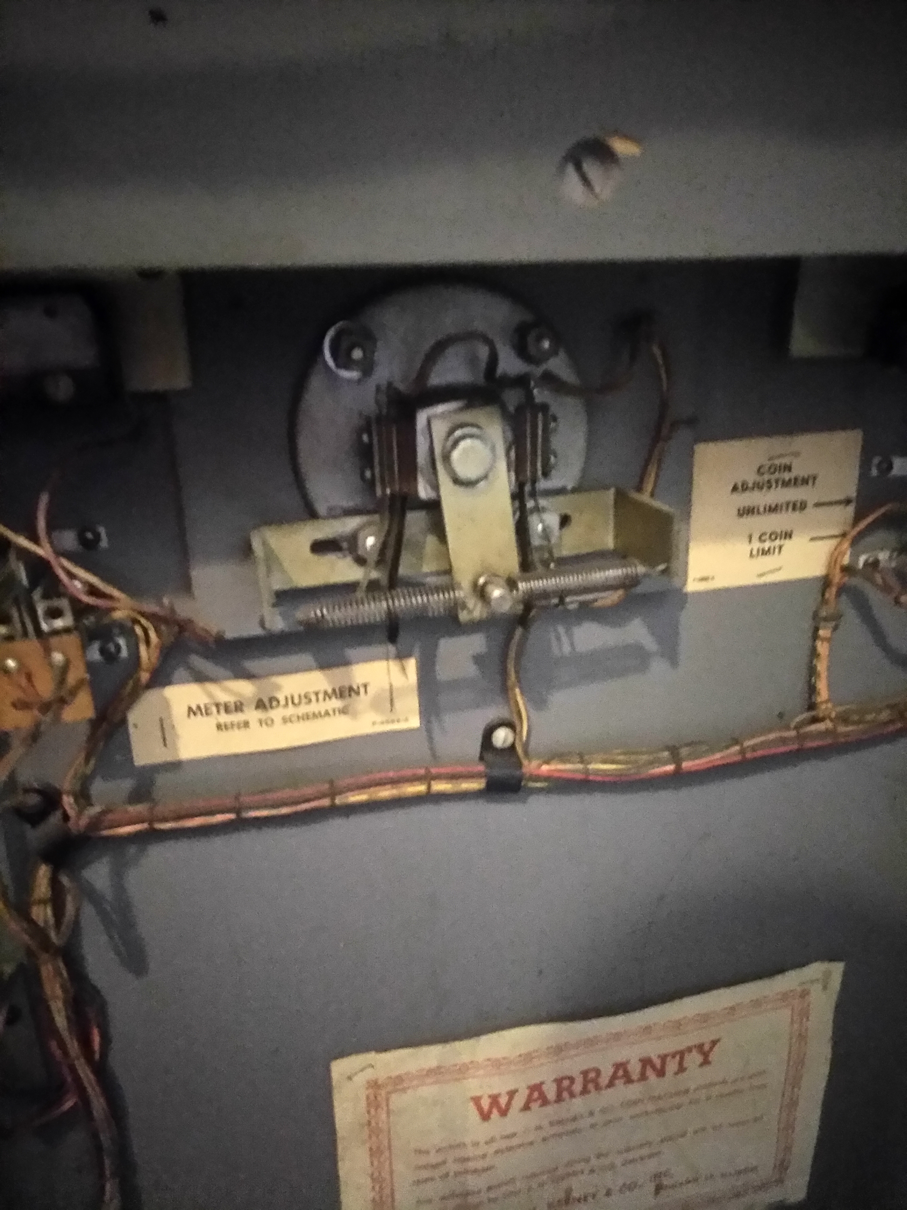

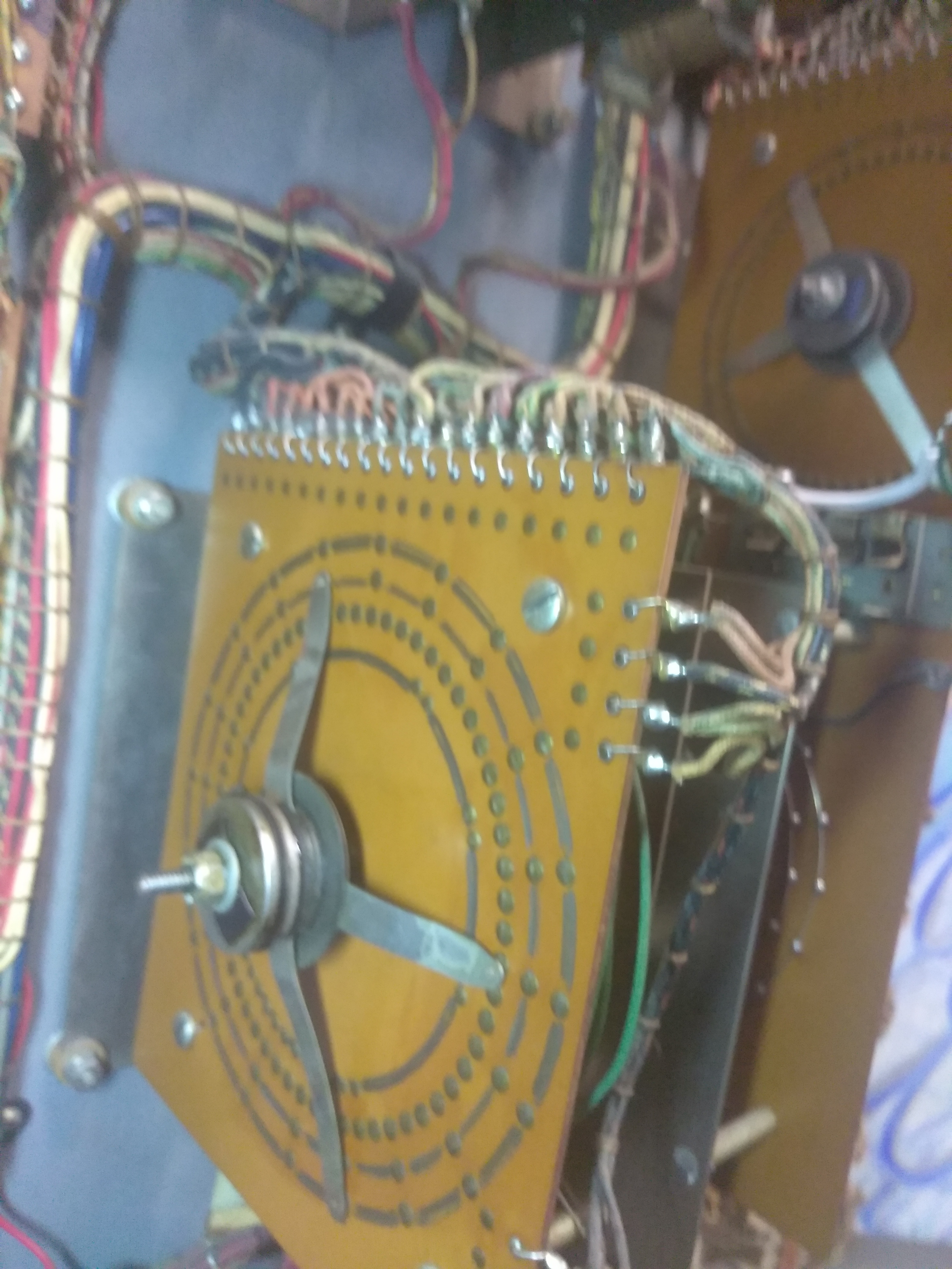

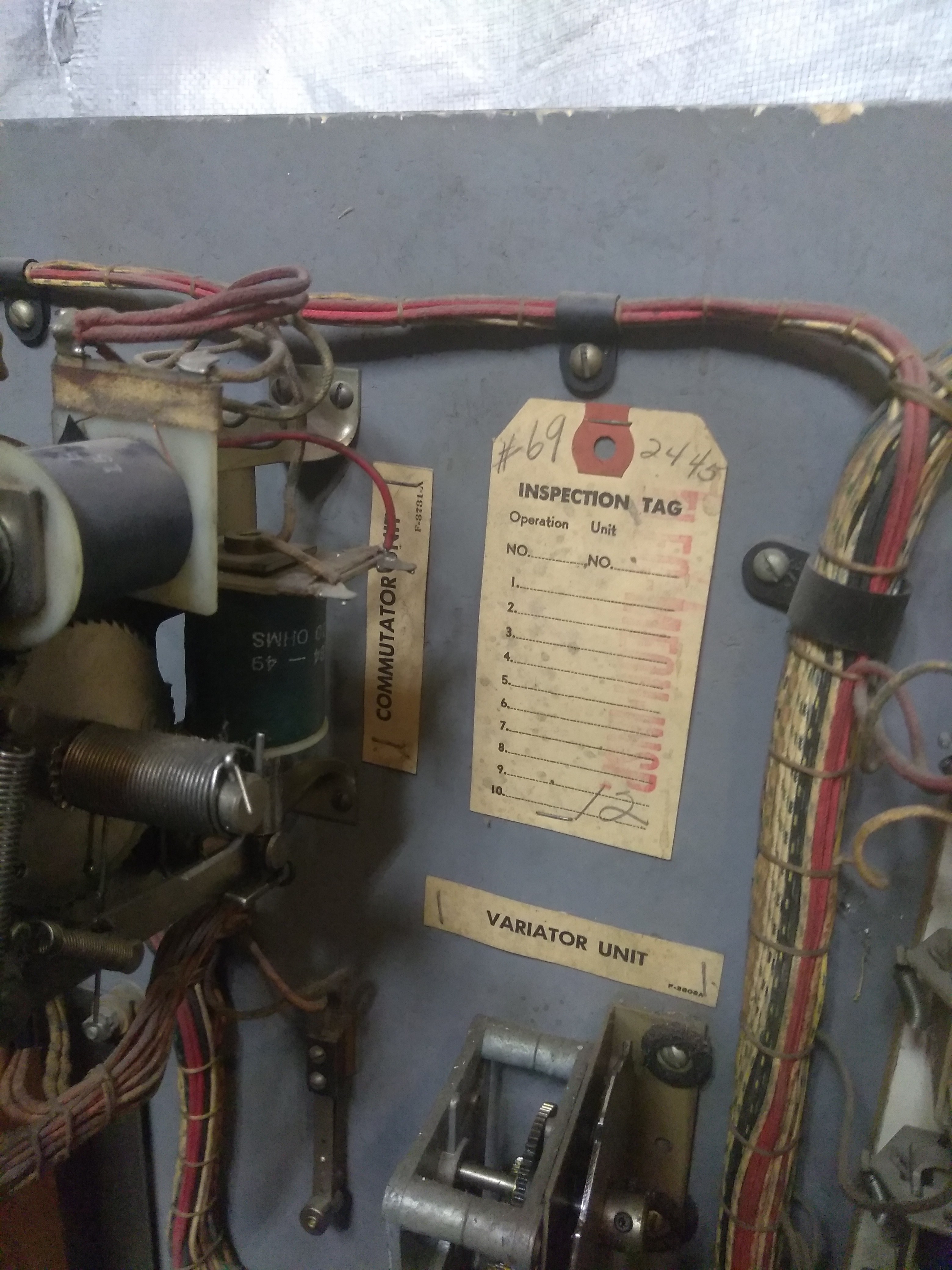

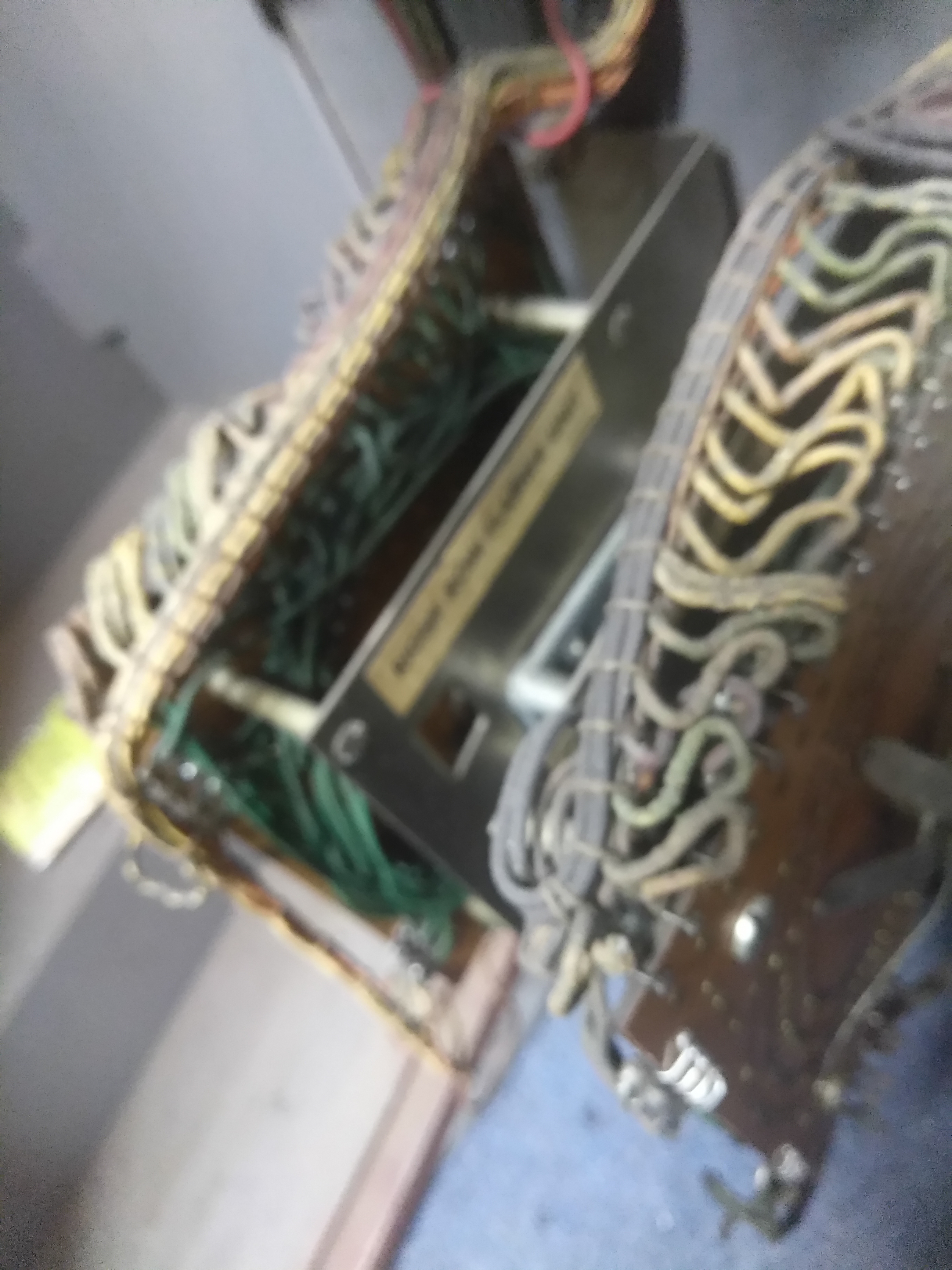

more pics and as you can see pretty much all original.

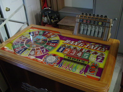

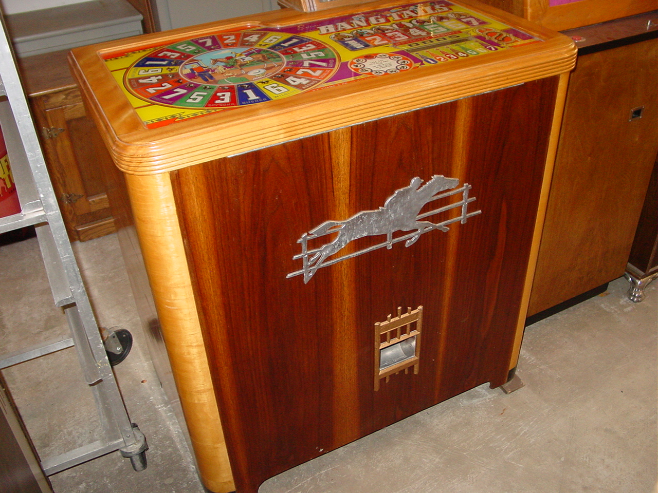

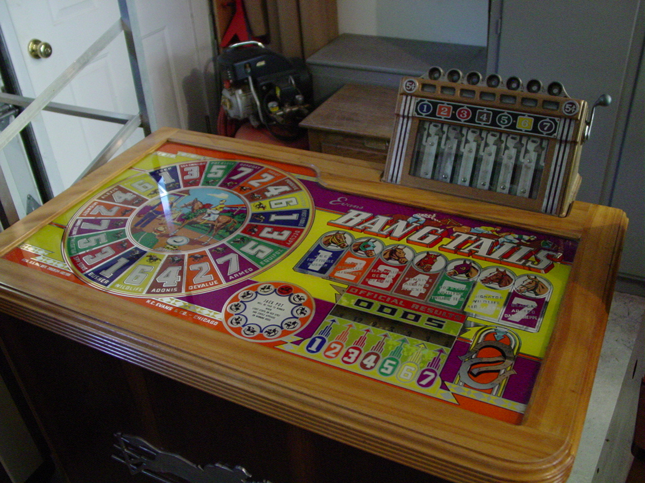

Postby MONTI » Fri Aug 31, 2018 10:14 am
I believe that particular machine was made in the late 30's maybe early 40's at the same time the Evan's Bang Tails was made as well as other "Flasher" gaming devices, called Flashers as they did not have spinning reels but used flashing lights to denote winners and they do have some similarities to the early pinball market as they use a lot of the same components, solenoids, steppers, cloth wrapped wire, Etc.

Postby jayram1408 » Fri Aug 31, 2018 7:58 pm
Thanks for the info, my issue is it does not always win when it is superposed to and also there are those different connectors that can be put in certain plugs but for what I am trying to figure out.

Postby sam2002 » Sat Sep 01, 2018 11:17 am
The earlier post of the pinball resources gave me a good strategy for cleaning and repairing a few electromechanical machines . (1948 Mutoscope Fishing Well , as well as several 30-40’s era pinballs )The biggest of which was to clean every connection , switch , plug etc . The accumulation of grime on a machine of this era really seems to hinder and effect its overall performance and you may be amazed at just how dirty those contacts are .
Hopefully your machine is complete and you find the resources that help you to bring it back to life .

Postby jayram1408 » Tue Sep 25, 2018 6:00 am

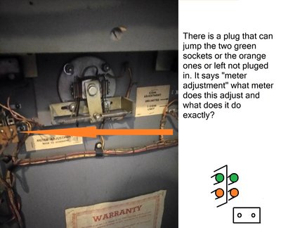

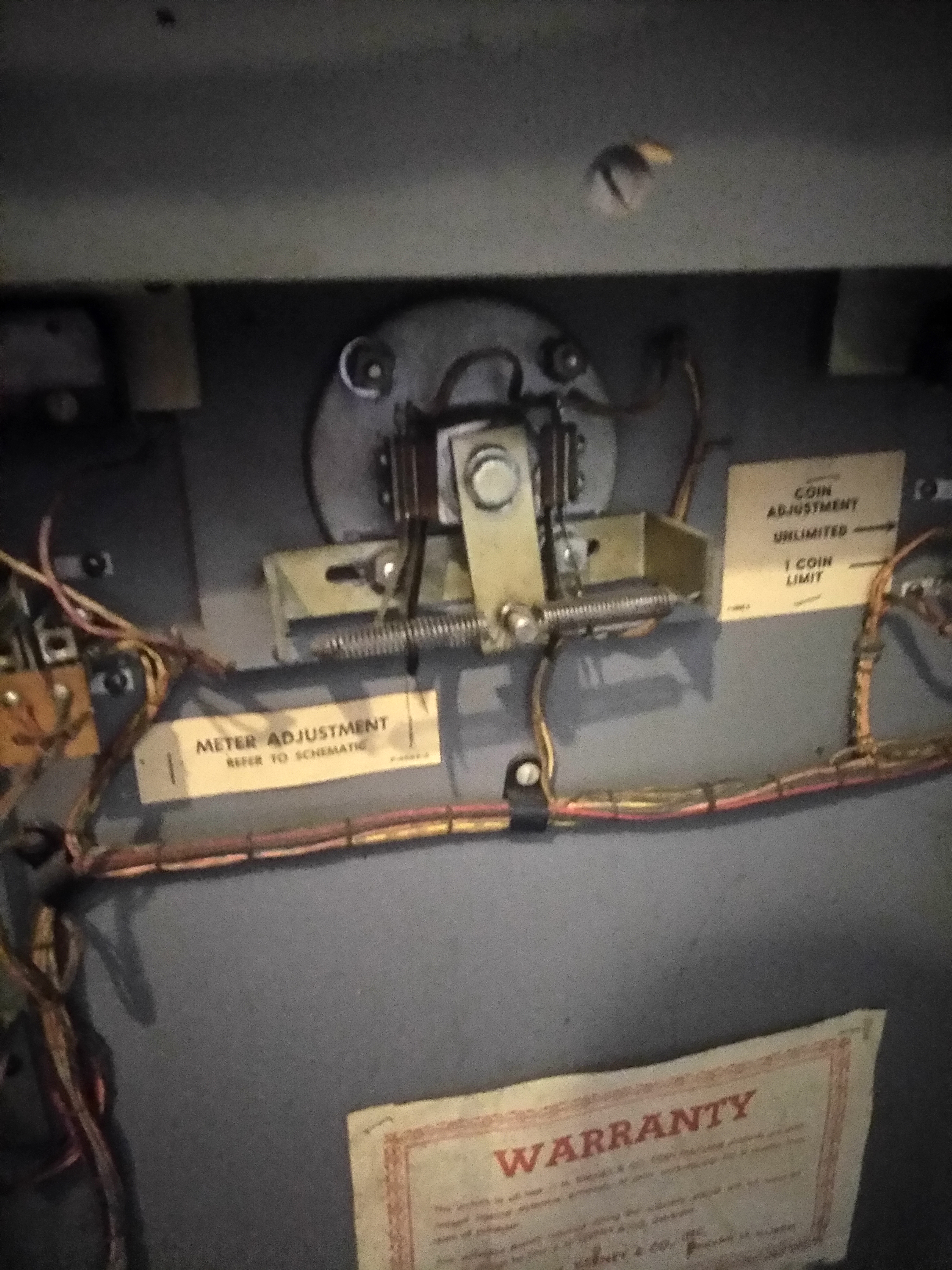

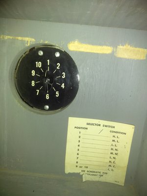

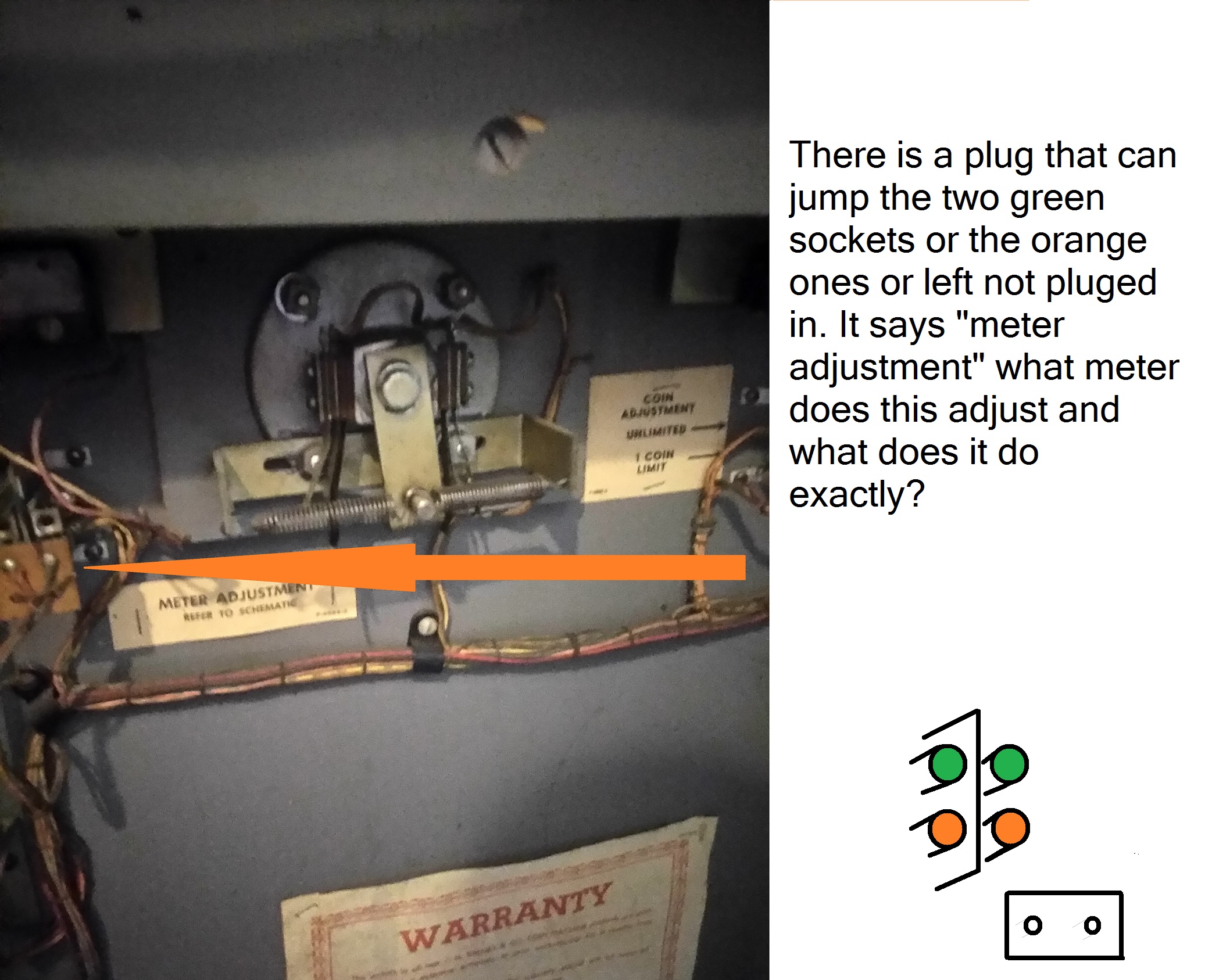

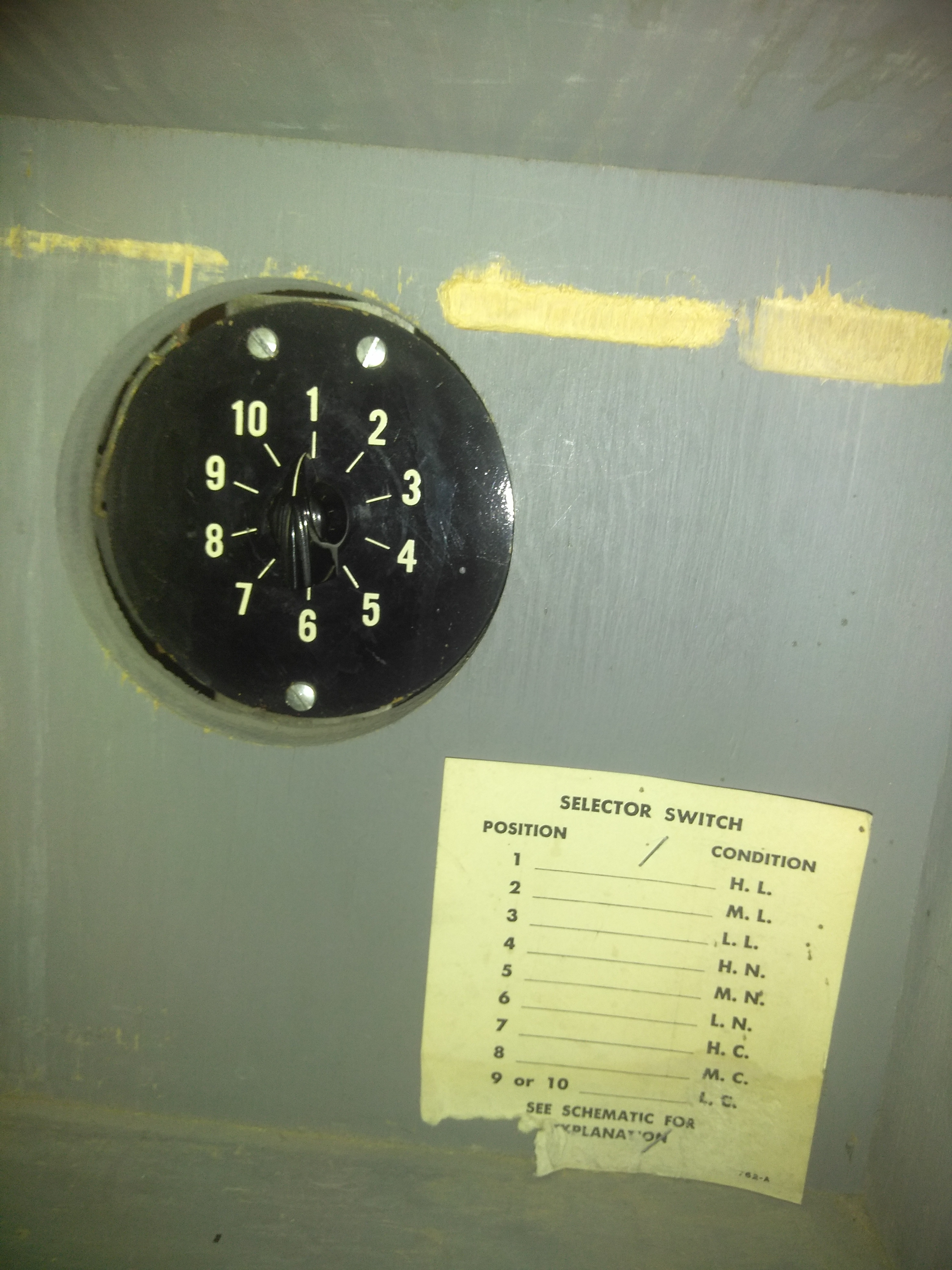

I am located in Denver Colorado. The issues I have are #1 The symbols dont match up to when it is susposed to win. So I am assuming there is something mechanical out of alignment? And #2 There are a few diffrent knobs, switchs and plugs that I have no clue as to what they are for exactly?
