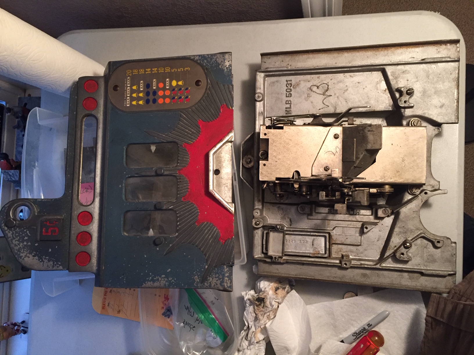

Excited to dig into my first restore project. Castings get bead blasted tomorrow and will start full tear down of the mech.
Thankful for this forum and Dave's videos as resources - it is unlikely I would have tried this without any outside help.

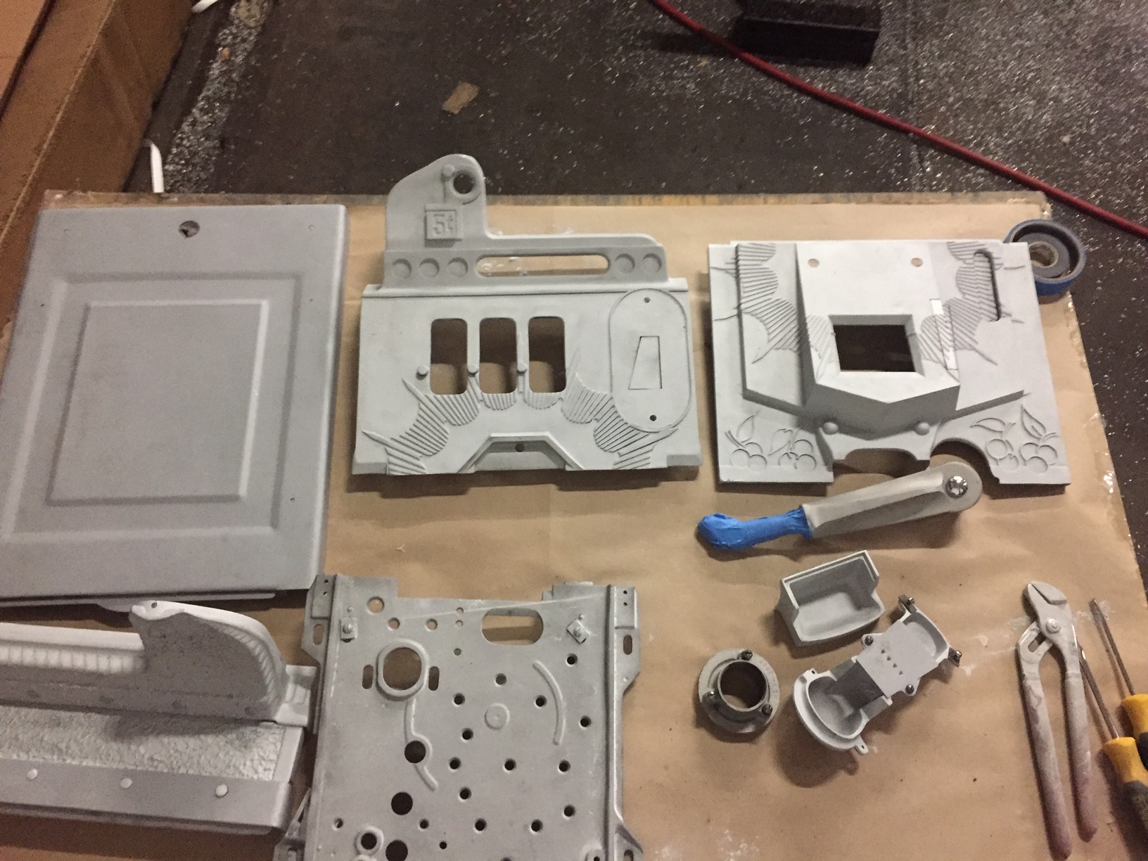

Postby Shane » Sun Feb 03, 2019 11:09 am
Bead blasting completed. I plan to polish the burst rays and other non-painted parts. Should the rest of the casting be buffed out at all or is it ready to go straight to paint?
Shane
Posts: 118
Re: First restore project
Postby radiorich123 » Sun Feb 03, 2019 1:25 pm
Just buff the high parts then paint the castings. The handle and the center cherry is chrome plated then painted.

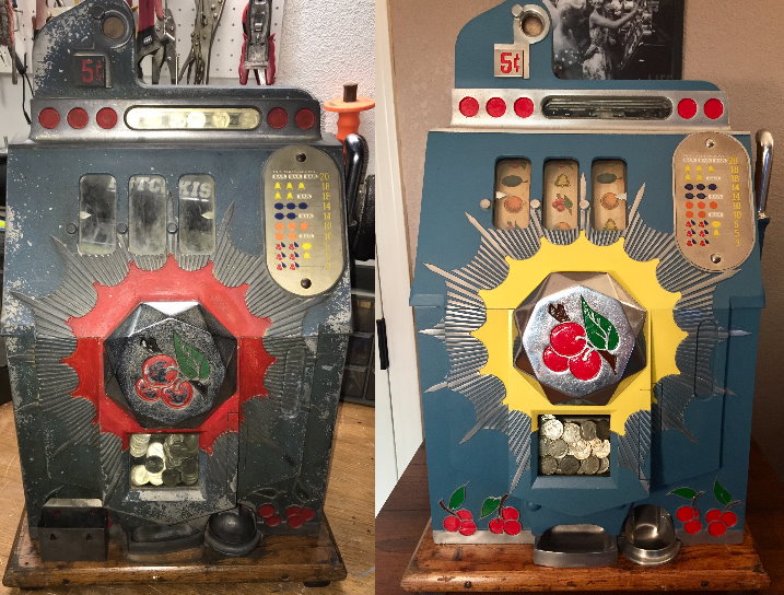

Postby Shane » Mon Feb 25, 2019 10:01 am
I'm ready to paint the castings. I've sanded and polished all of the high points. Question on the sun bursts - the bursts are unpainted but between them will be painted. I don't think there is a simple way to mask each ray. Do I just paint over them and then go back and sand the paint off of the rays? If so, what grit is sufficient to remove paint?

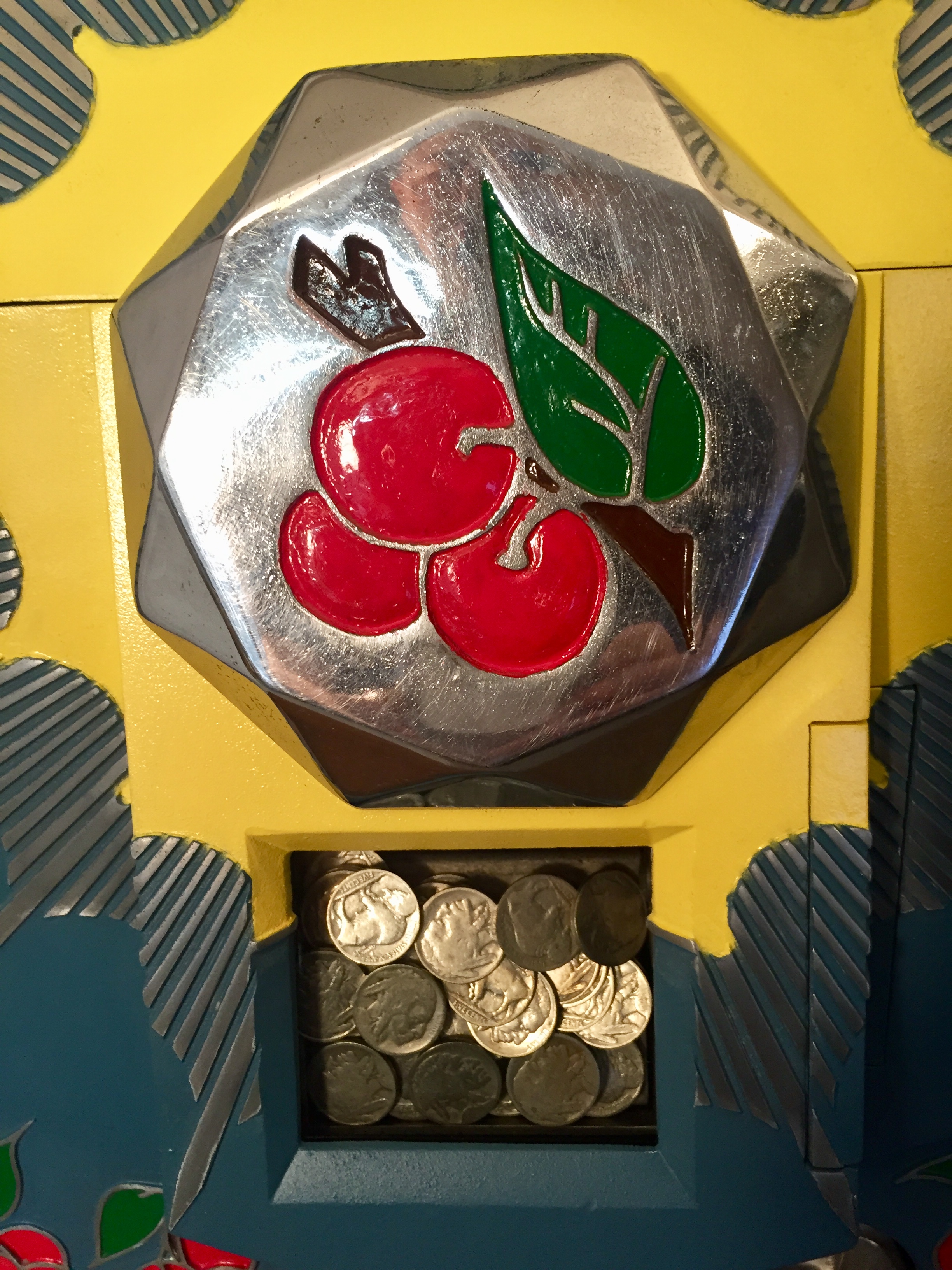

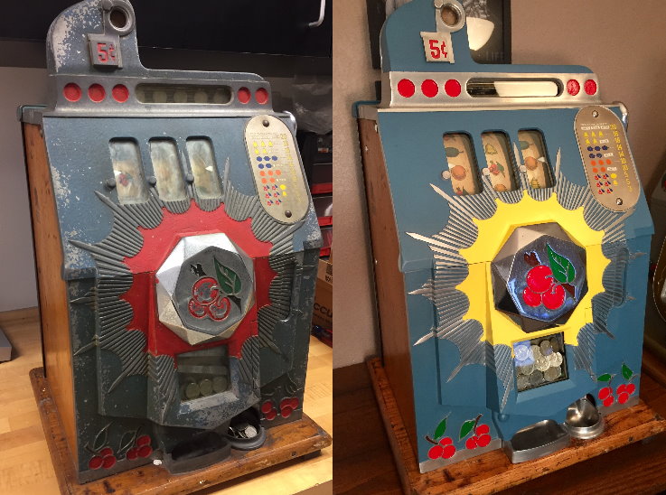

Postby Shane » Sun Mar 24, 2019 5:55 pm
Making progress - exterior finished. Now to work on cleaning the mech, jackpot and escalator...
Postby bkrsdoz » Thu Mar 28, 2019 3:14 pm
I think you did a great job.
It looks awesome!
