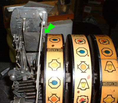

Attached is a snapshot of my Dictator mech viewed from the rear. At the location indicated by the green arrow, you should find a pin projecting from the side of the gooseneck just under the rim of the third reel; this pin serves to raise the kicker flap to clear the payout wheels, which should spin silently. If this pin is missing, you ought to find the threaded hole in which it is seated; a little threaded rod (such as a machine screw with the head ground off) can easily be substituted. BTW I had noticed this in Alex's video-- the sound of the flap dangling on the payout wheels-- but neglected to mention it to him, among all the other entertaining trivia we discussed...

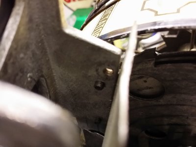

see the close up of mine that is, indeed, missing that pin!!
