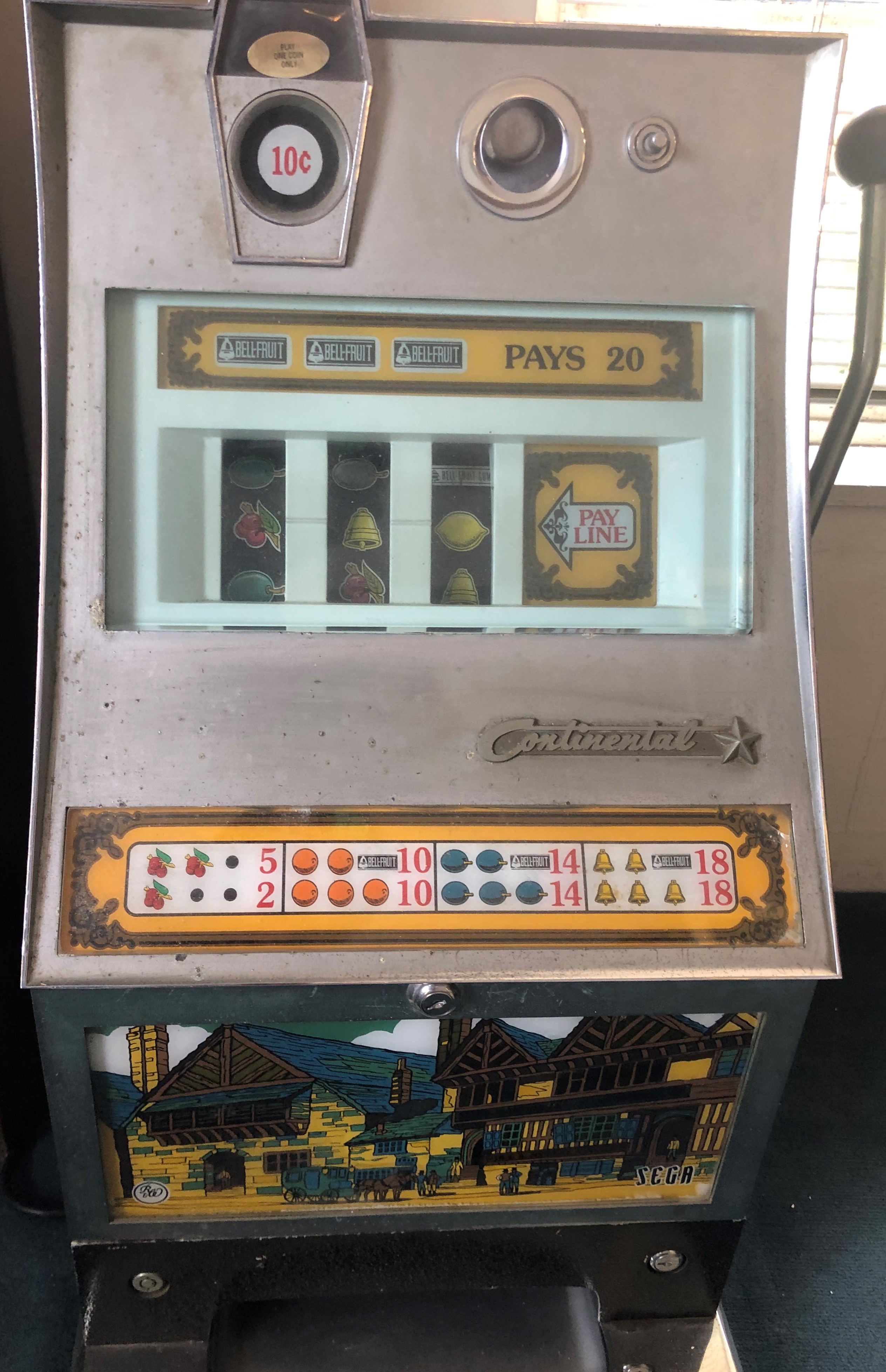

Looking for any information on a SEGA Continental Slot machine. Would like to find out more information on this machine as well as locate a manual (pdf) on line somewhere. Not even certain of the name of this machine!
Also, when I put a dime in the machine the wheels don't spin with any real velocity. Thinking it might be as simple as cleaning and re-greasing the moving part??? Not sure so wanted to ask for input. This machine has been sitting for well over a decade!

Appreciate the post. I felt like $550 was around the going price. Nonetheless any input on the issues/questions I have with the machine? Also, anyone know what the coil size is in these? The coil sleeve missing and the plastic housing is broken so it's best to replace it.
Original post ... "when I put a dime in the machine the wheels don't spin with any real velocity. Thinking it might be as simple as cleaning and re-greasing the moving part??? Not sure so wanted to ask for input. This machine has been sitting for well over a decade!"

Postby meSz » Tue Jun 11, 2019 11:10 am
Hey all still looking for some input on the mechanics to this machine. I have it working now but the reels don't appear to be spinning really well. Is this common on this? With other slots the wheels would spin fast this one they're slow. There is some lubricant on them so not sure what the story is here.
Also, when I plug the machine in all but one of the lights (all new ones installed) is coming on. I thought maybe the starter but if I take the starter out and put it in the light comes on. Almost as if the machine can't light all 5 bulbs at once!

Re: TECH - SEGA Continental Slot Machine Help needed
Postby radiorich123 » Tue Jun 11, 2019 11:25 am
HI Make sure you have the correct starter number for the machine.Make sure all bulbs are good.

Postby meSz » Tue Jun 11, 2019 1:38 pm
radiorich123 wrote:HI Make sure you have the correct starter number for the machine.Make sure all bulbs are good.
I have all new bulbs so I know that's not the issue. As for starters, I don't have a manual or anything to confirm what the starters should be but I have all FS-2 starters.
Postby radiorich123 » Tue Jun 11, 2019 6:36 pm
Make sure the transformer for the bulbs is 115 volts not 220 volts.
Here is the starters that go with the bulbs
Starter For use with
FS-2 F14, F15, F20 preheat fluorescent lamps
FS-4 F13, F30, F40 preheat fluorescent lamps
FS-5 F4, F6, F8 preheat fluorescent lamps
FS-12 FC12 Circline lamps when operated by preheat ballasts;
F22 T8 preheat lamps; F32
FS-20 F15, F20 preheat fluorescent lamps
