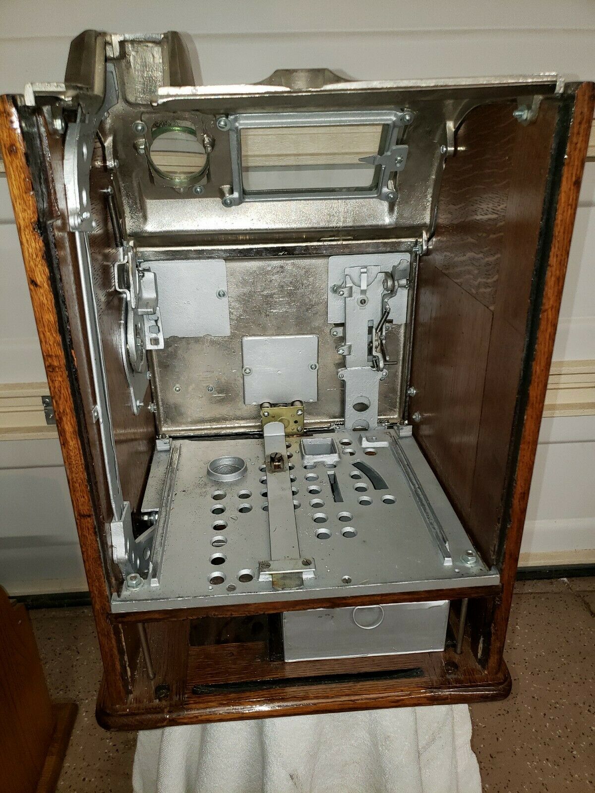

The GA mechanism looks to me to be a Mills mechanism cut down to fit.

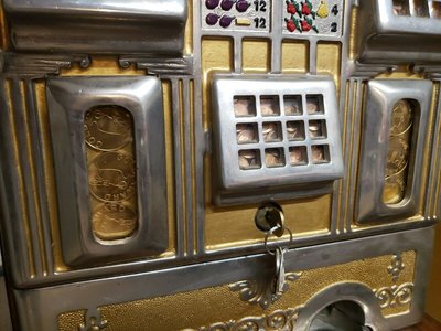

The bottom lip of the front casting has been broken off to accommodate the GA coin chute.
The GA tokens in the dummy windows are Mills tokens used in their later model machines (this could be excused if the original tokens were lost, if there ever were any).

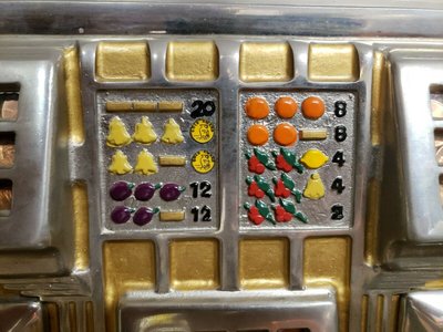

The GA symbols on the front cast award card are simply paper stickers over the cast-in awards.

This is a put together machine, not a revamp. The lower casting is not original as you can see the slag marks on the back. The award vendor is a Mills cut down to fit. But mostly all the nuts on the inside of the cabinet are hex nuts. Jennings and Mills like the rest used square nuts for all their machines. Too many red flags, unless you want to go bull fighting !!!!!!
