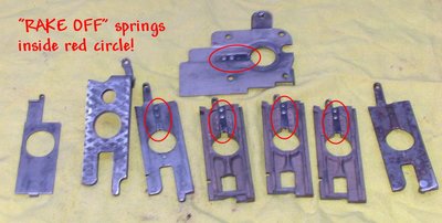

The payout slides are metal. Hey Jim need some help any chance of a pic I'm off kilter with the rake spring?.

Postby MONTI » Wed Aug 14, 2019 7:47 am
Here's what mechanic is speaking off below!

Postby capt7310 » Wed Aug 14, 2019 9:23 am
OK yes,Thank you very much Monti!

Postby mechanic » Wed Aug 14, 2019 8:34 pm
MONTI wrote:Here's what mechanic is speaking off below!
YUP !!
