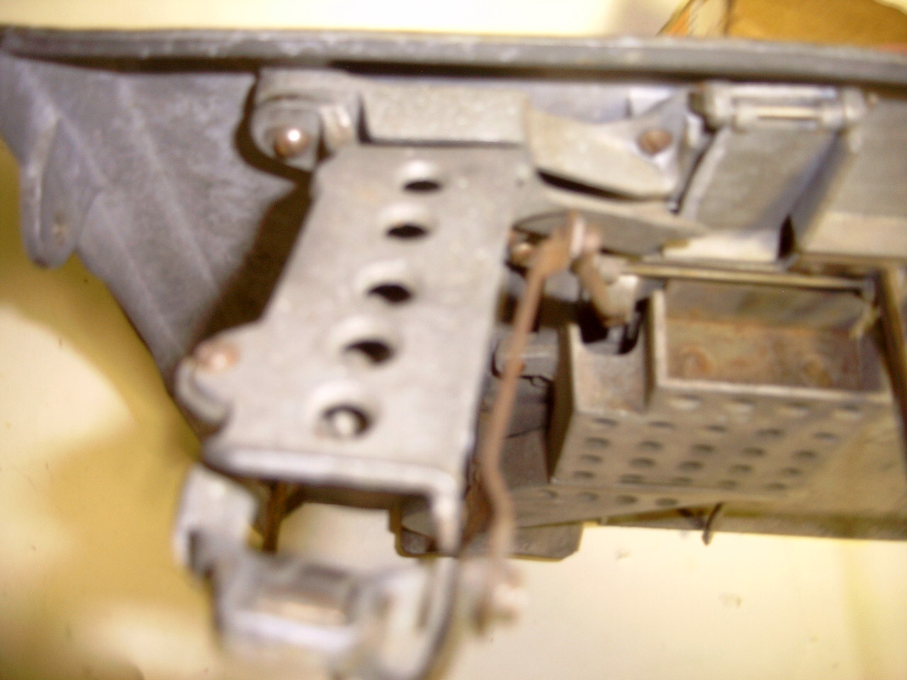

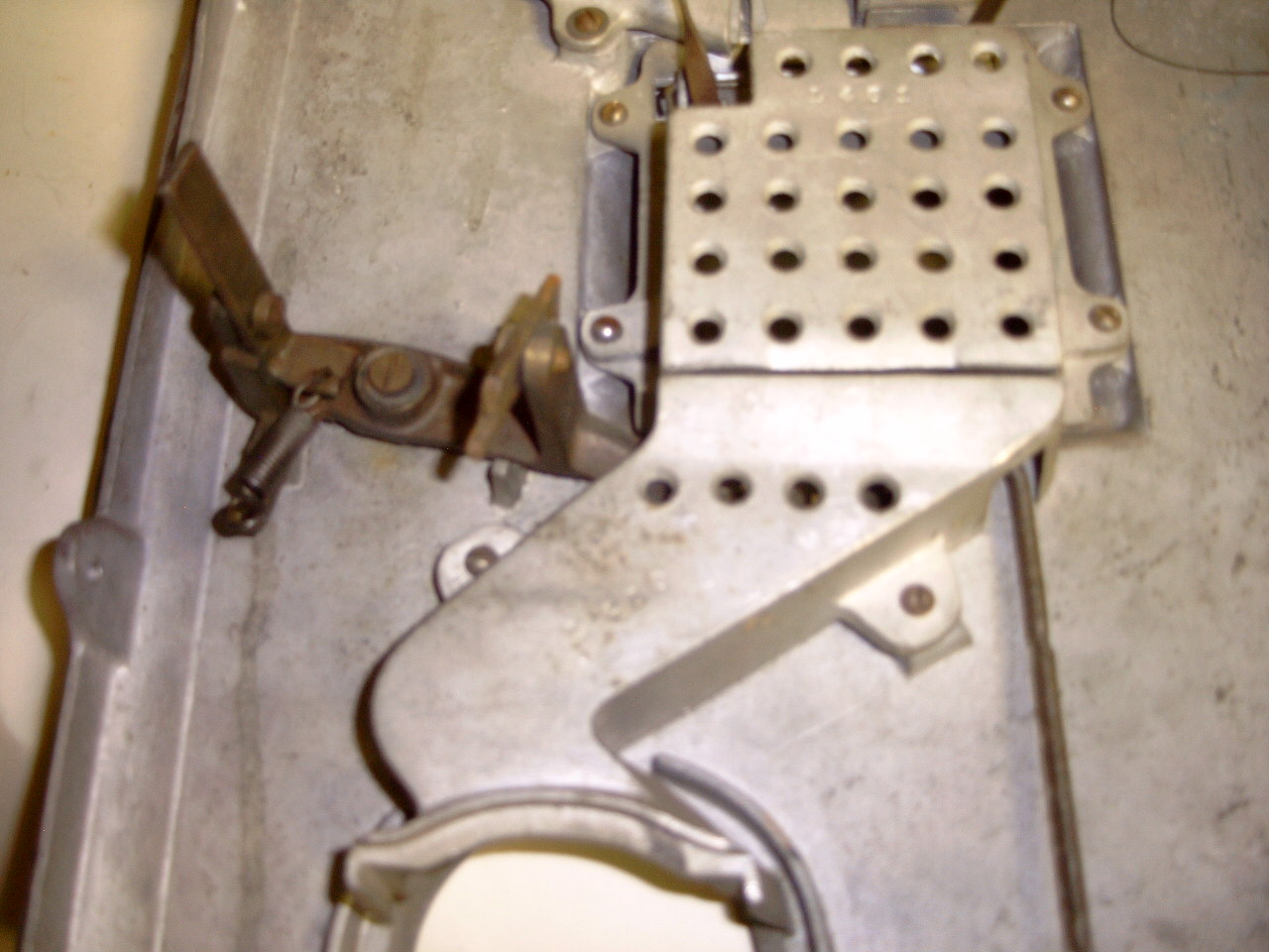

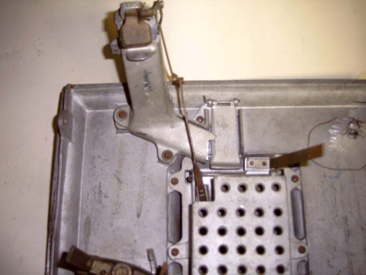

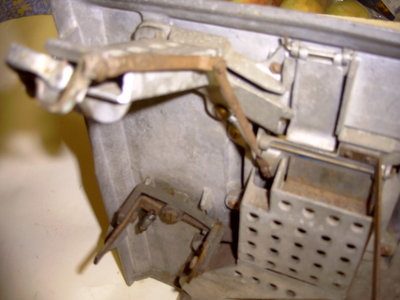

Postby mechanic » Thu Dec 05, 2019 5:42 pm
Here are pics of the j/p assembly complete. The tube on top is from another machine. The chute should have a cover on top where the tube is screwed onto. This J/P unit did not have an overflow to the cashbox just a small spot where the coins fell when the jackpot was full. The little square area with the four holes on top of the jackpot.

Postby bajrbajr » Fri Dec 06, 2019 10:45 am
Thanks for the help guys!
Looks like I just need a cover for the jackpot fill shoot... this black tube isn't a Watling part.
