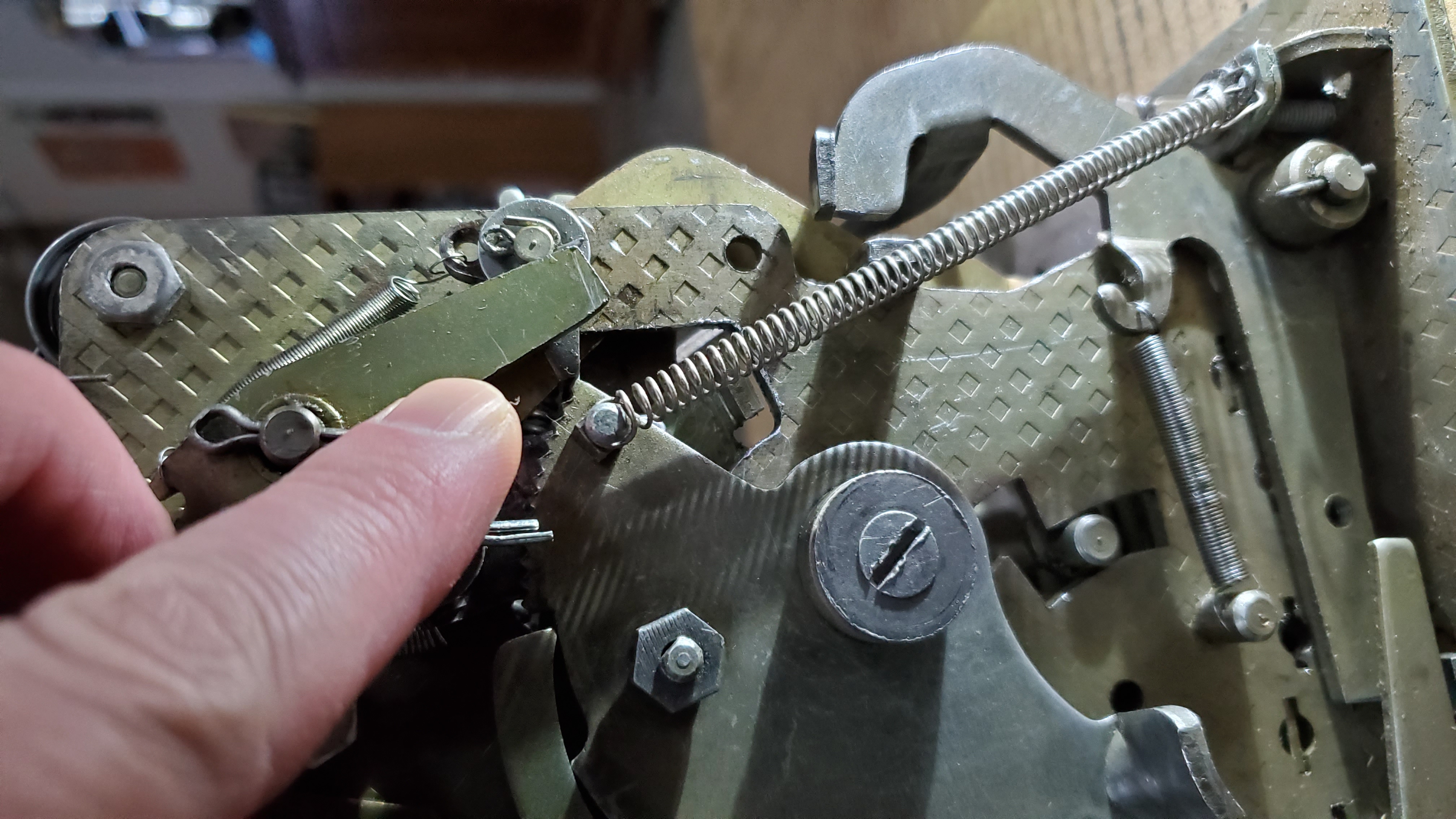

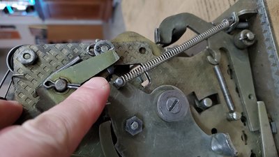

Hi all. I just got my first QT,and the starting lever keeps binding after a play...it will not reset to normal position. Is it the spring on the small part behind it? I took some pictures...any help much appreciated
Thanks,
Mark

That thing you call the small part should swing out of the way to allow it to reset. It may some oil or maybe a different spring. Make sure it moves freely.
