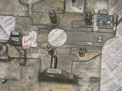

Postby J.N. Shetler » Thu Mar 05, 2020 12:21 pm
These are the riveted/staked posts (pics attached). They are 1 - 5/16" high, which is for a set of quarter slides. Nickel posts are 1 - 15/32" high. The Nickel set of payout slides will not fit, they are too high when stacked. I either need a base with nickel denomination posts in place, or a way to drill these out and replace with nickel posts. I was just wondering had anyone done this before and had any advice. I don't want to damage the base removing the posts. Berten's has posts that I'm assuming will fit. Every other part of this machine is nickel denomination parts, so i gotta make the change one way or another. Someone swapped the base at one point, which is why it was never reassembled when it came to me.

Postby WS65711 » Thu Mar 05, 2020 2:09 pm
Just my thoughts . . .
I don't think it would be too hard to drill three of the rivets, especially if you have access to a drill press. The fourth rivet appears that someone may have attempted to grind it off but gave up. That one may be harder to drill, because I don't see a well defined center on the underside.
BUT . . . not knowing any more about your machine than what I can see in these two pictures...
If the nickle machine requires 1-15/32" posts, and the quarter machine requires 1-5/16" posts, would it not be possible to extend the nickle posts upward by using a 5/32" tubular spacer of some sort stacked on top of the existing post (along with a longer screw to suit)? Maybe even stacking a couple of washers might work?
Of course my idea may be silly, because I don't know what attaches to these posts. :-?

Postby J.N. Shetler » Thu Mar 05, 2020 2:26 pm
Hi WS65711,
Those posts hold the top frame for the coin slides, the base of the coin tube, and jackpot lever.
I thought about some home-made "extensions", but I'm going to keep this one, so want to try to do it right.
Might be time for the drill press......
