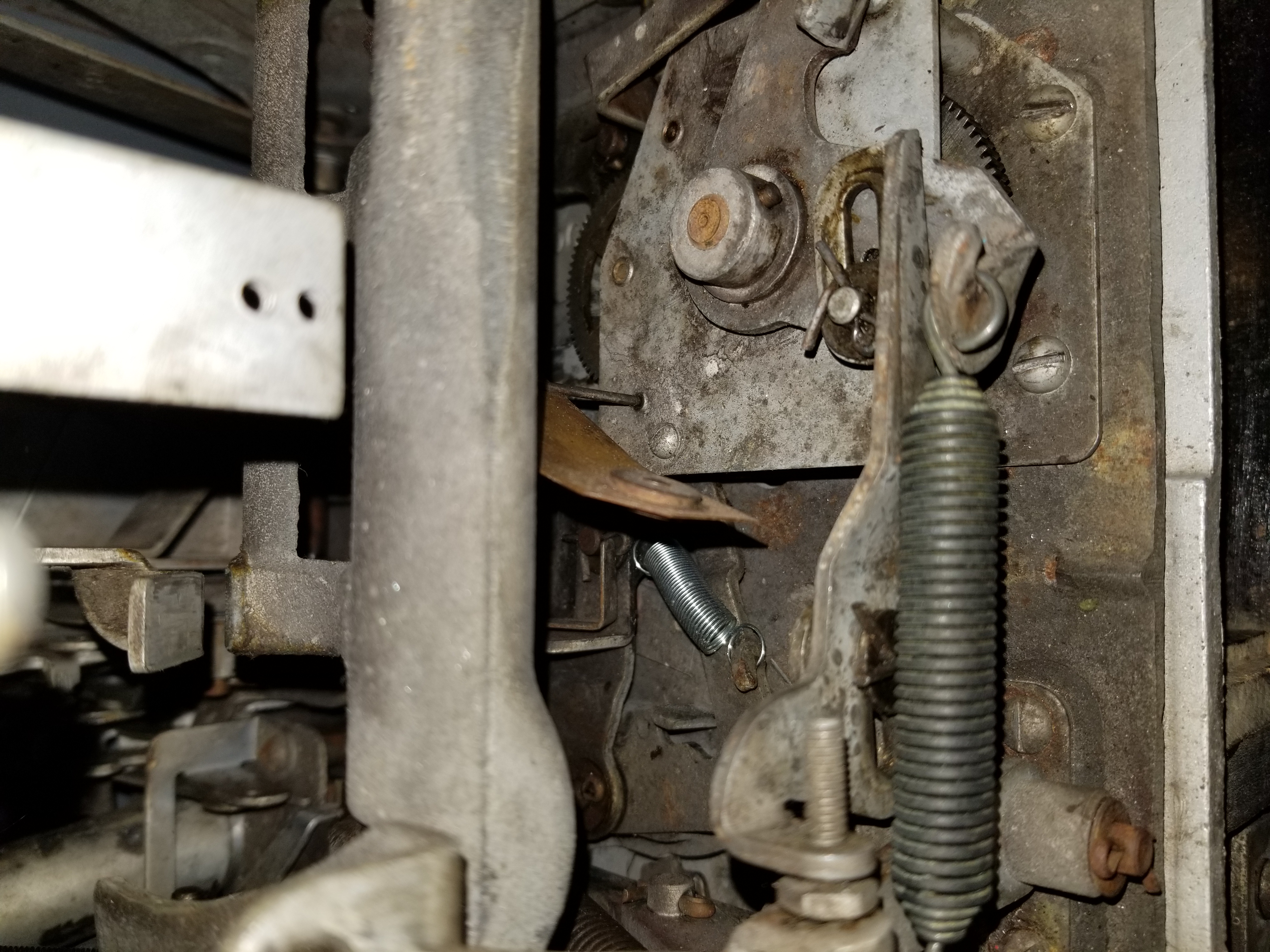

What is the name or part number of the spring that goes where I have this shinny new, not correct spring?

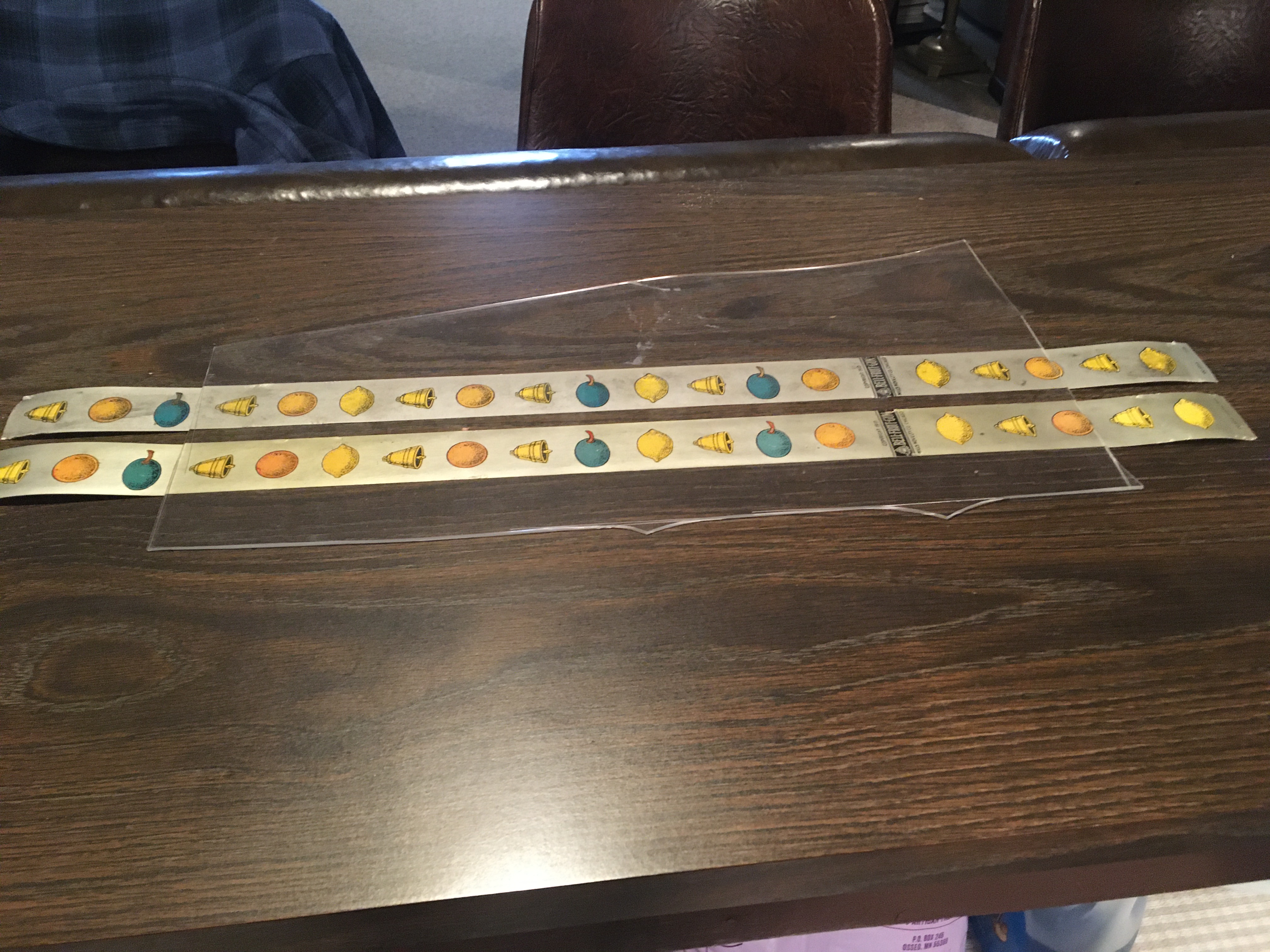

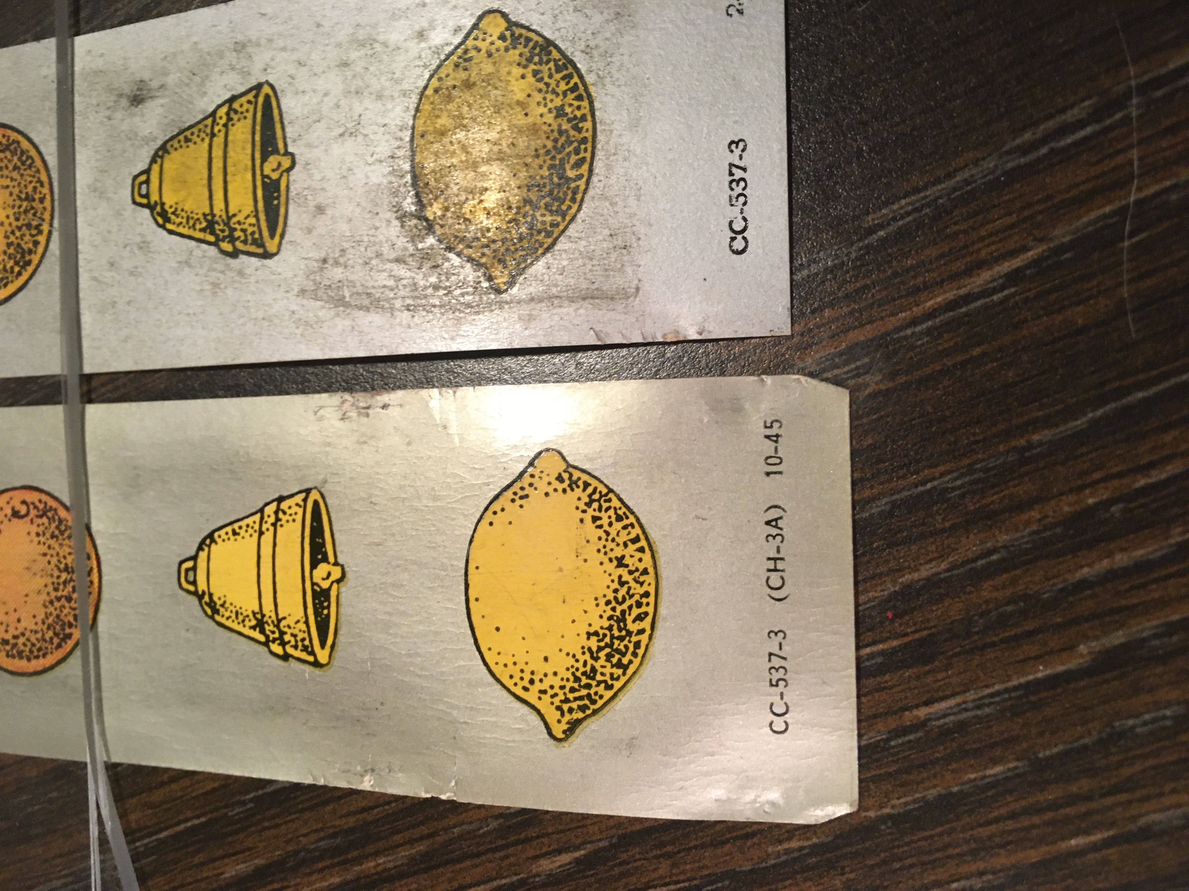

Also, if anyone has a useable CC-537-3 reel strip, let me know. It's missing just one strip, and it's a rough machine.

What color reel strip? Spring is MLB 160 extension spring [ 70062-CSP ]

oldslotman wrote:What color reel strip? Spring is MLB 160 extension spring [ 70062-CSP ]
Thank You, I couldn't find that spring in the diagram in David Berten's catalog. The reel strips are silver, the two that are there are labeled: CC-537-1 (CH-1) 10-47 and CC-537-2 (CH-2) 2-48
I finally have it mostly working (need to order a spring set for the escalator as I have the wrong large spring as well, which I think is causing the nickles not to be cycling through (cycles fine out of machine)).

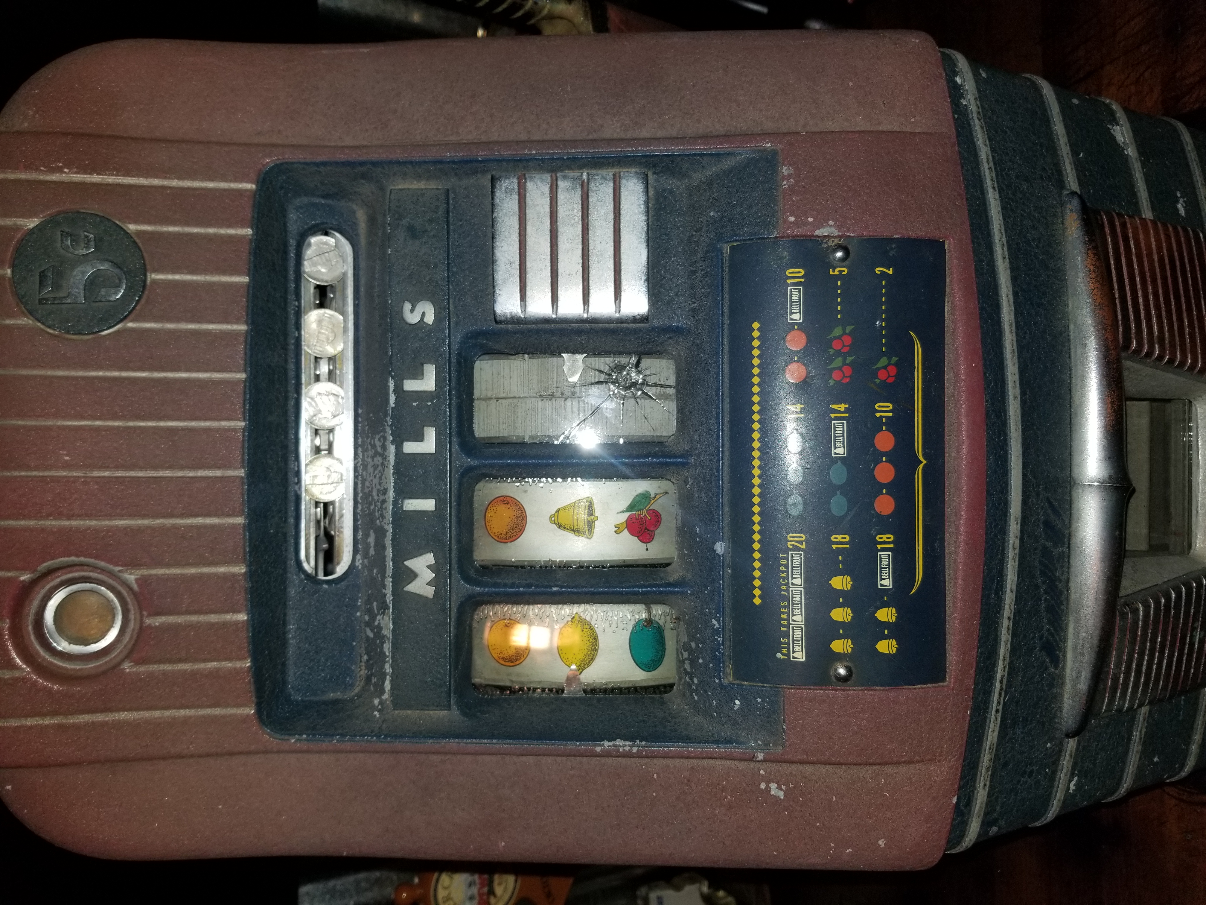

Since this is in poor condition, and missing the back door and bonnet, I don't want to drop $$ into it. It's just been a fun project to get from completely dead and abandoned to rough and working. Its my first mechanical regular slot (Own one console and a vest pocket).

I do have two of the reel strips

Update: Reel strip found, Thanks again to Oldslotman!
