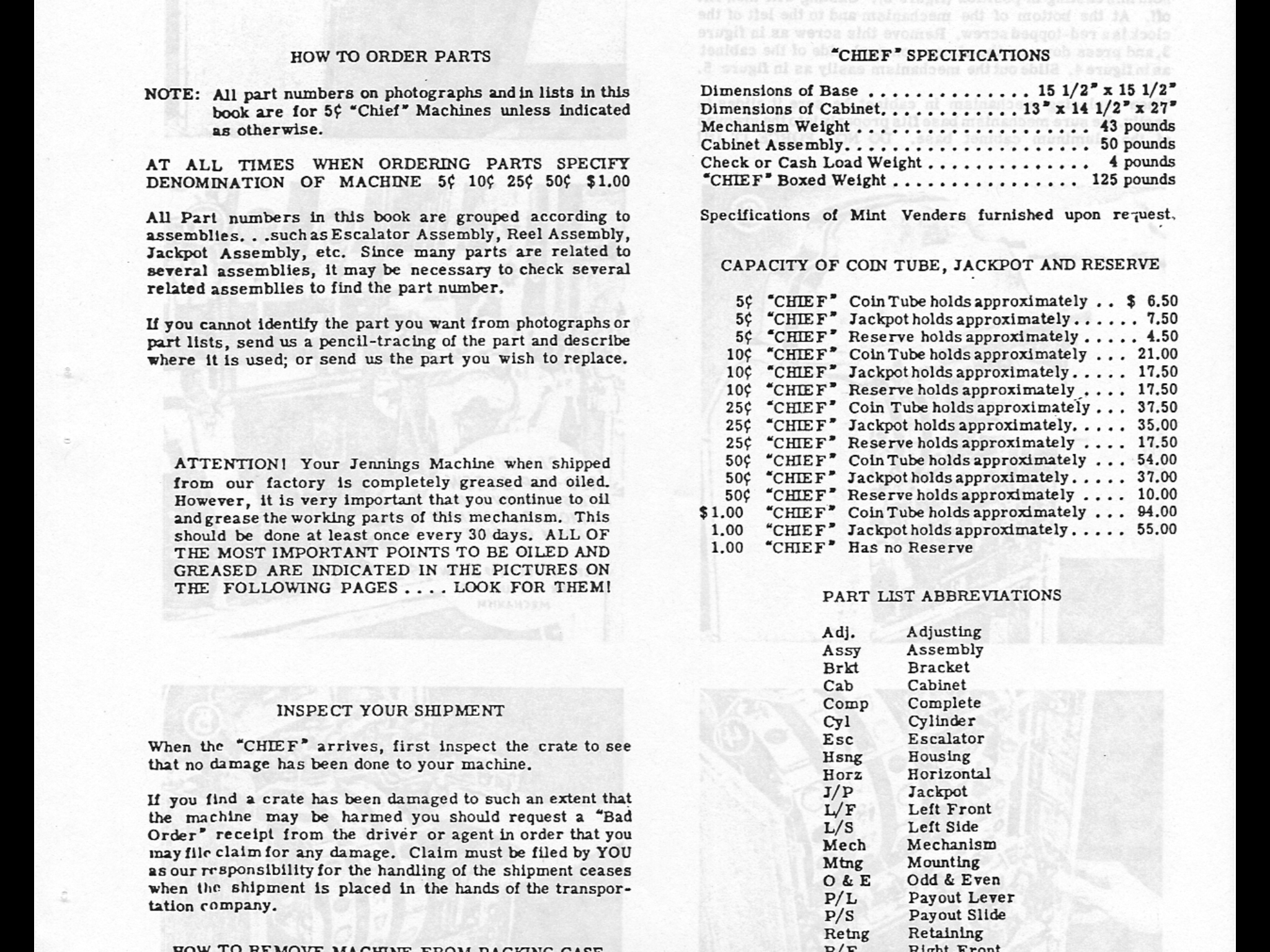

Thanks to both of you for answering. I did hand feed the jackpot by taking off the Indian Head. I’ve been having fun putting quarters in watching to see if any fall in the jackpot area and never saw any go in there. I took off my back and checked my cash box and found lots for me! One happy owner, thanks for your help.
I also found a Jennings Parts Catalog on line. Here’s the answer to my question on Jackpot question. Jackpot for quarters is $37.50! I also ordered a book Jennings Slot Machine Repair Manual to help me out.
