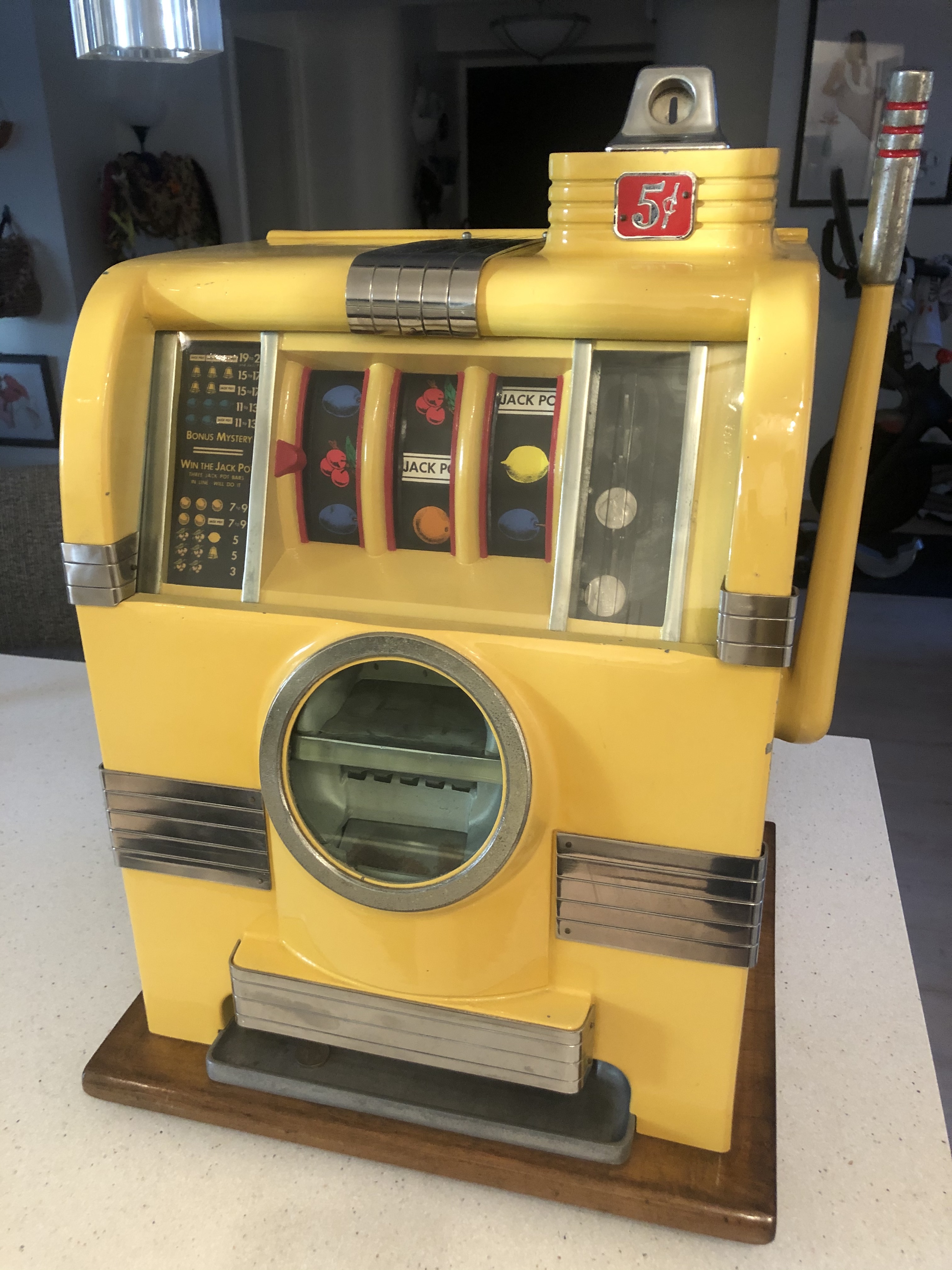

I have SO MANY questions, but first, here's what I picked up:
Caille Commander Front View

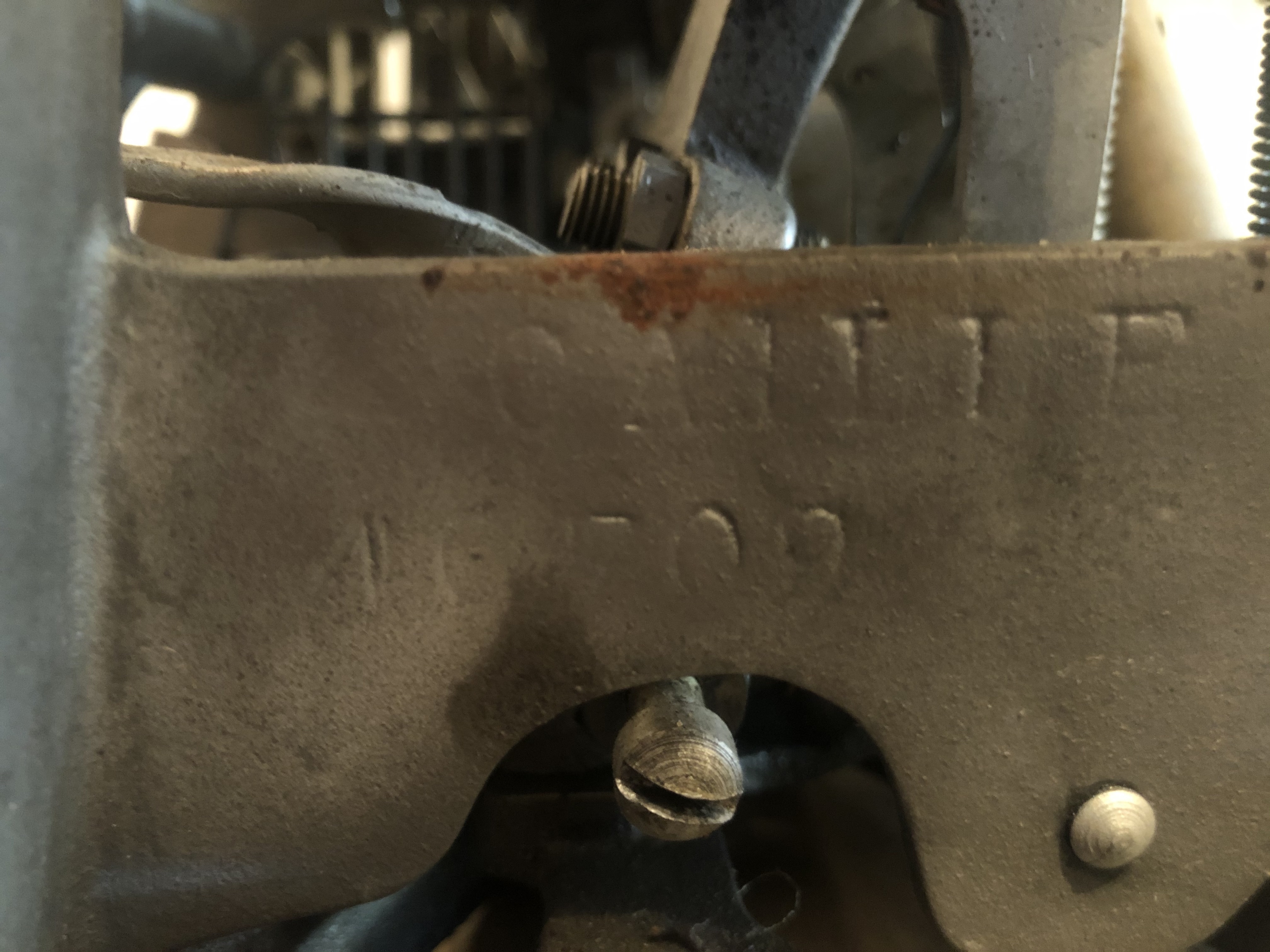

Mech Serial 40709
It was advertised as a "1936 Cadet," but I'm confident it's really a Commander from what I've learned here.
It's VERY clean looking and it's in pretty good working order. Someone did a really nice restoration it seems, and wouldn't it be SO COOL if someone on this forum recognizes it and takes credit!?

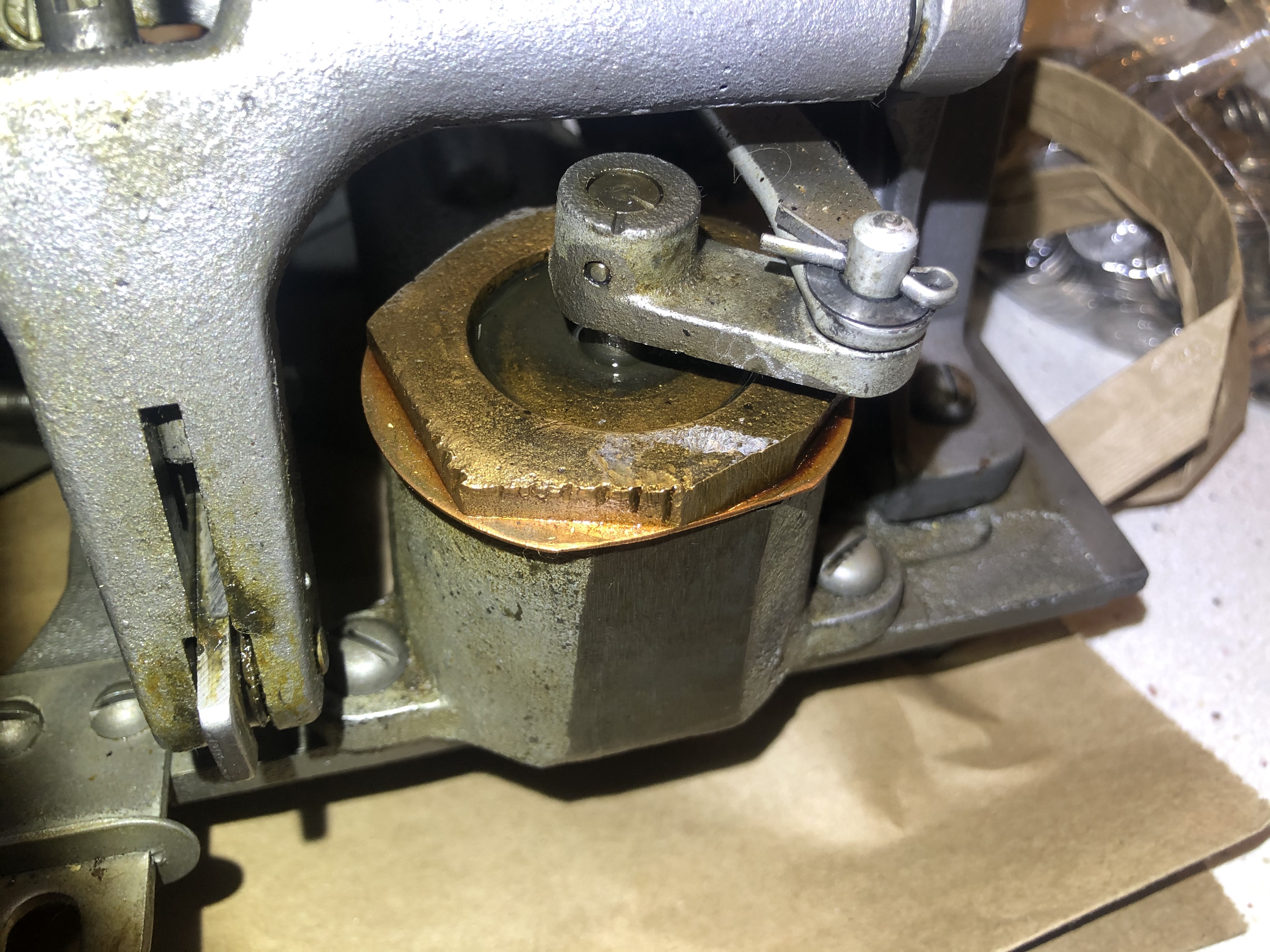

The teeth marks on the clock seems like an obvious indication that the clock has been tuned up. I see some fluid seeping up through the top, which tempts me to attempt a replacement of the top internal rubber O-ring and top off the fluid. It was barely moist when we got it, but the pooling slightly increased in volume after a few hundred pulls over the last 24 hours.
Seeping Clock

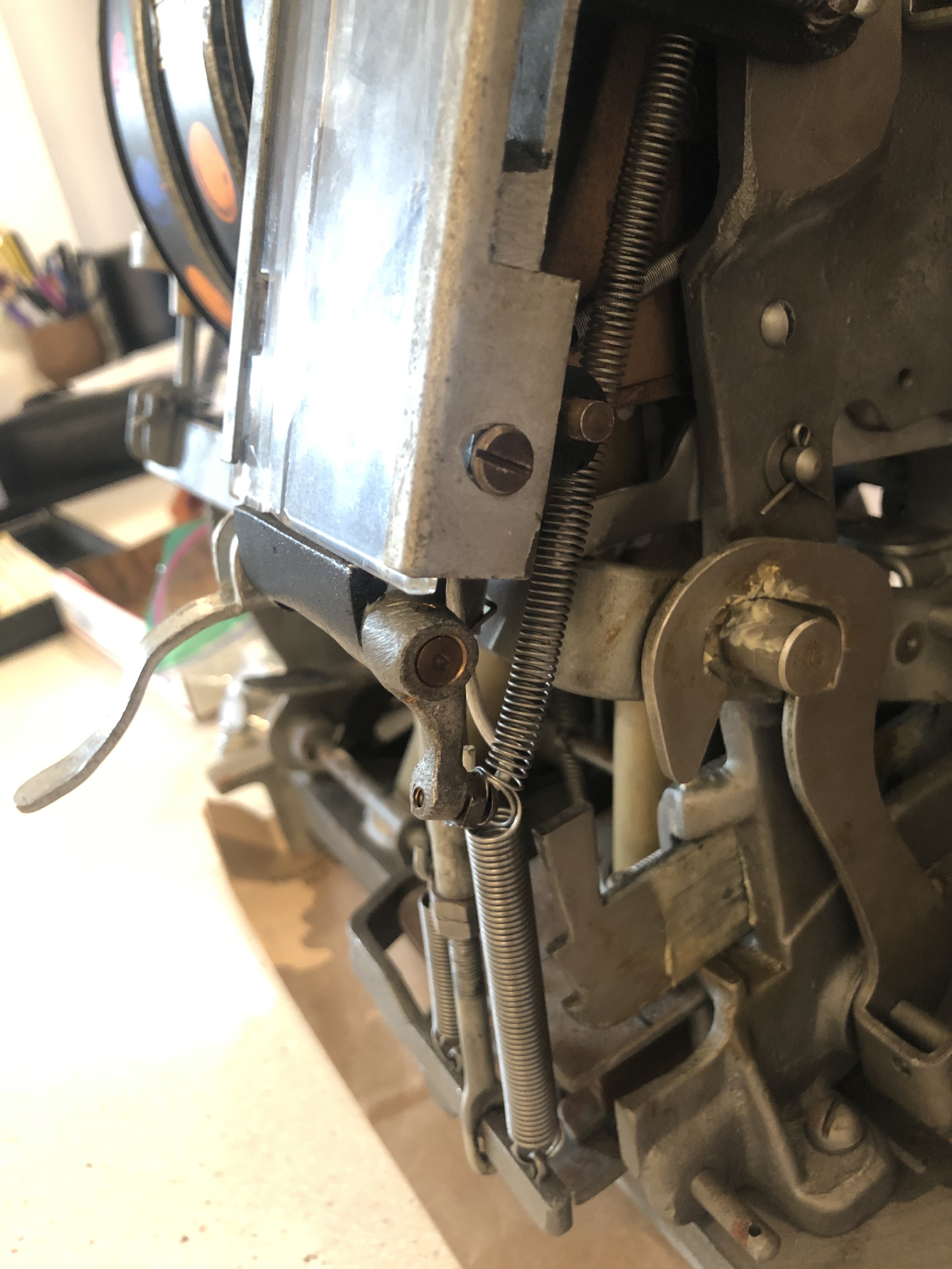

Escalator coin escape
Escalator escape strong spring

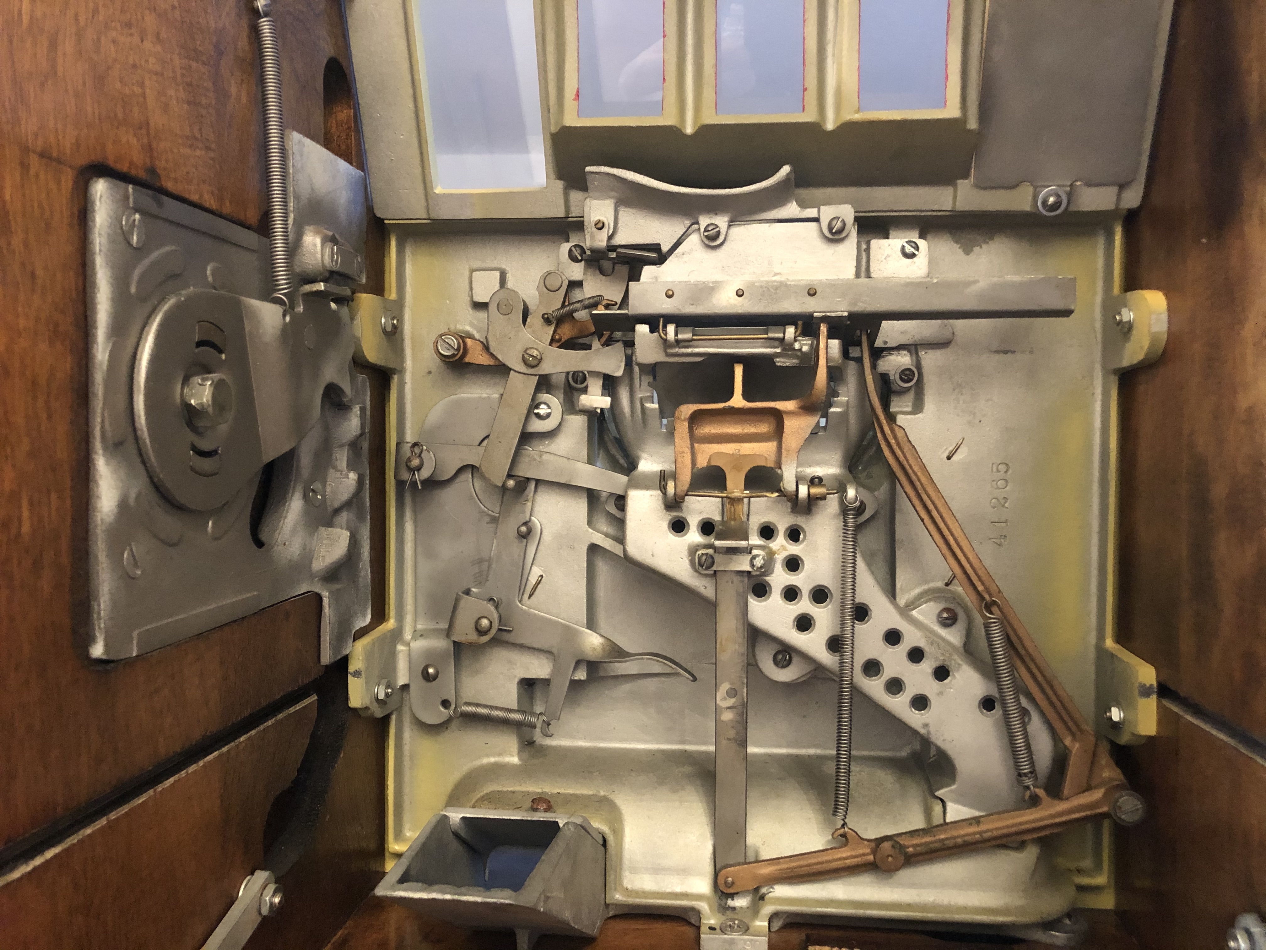

I haven't identified how the "escalator escape tab" (excuse my rookie lack of proper vocabulary) is triggered to allow the coin to roll into the jackpot reserve.

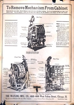

There's a cool Watling diagram glued to the inside of the door pointing out intricacies of that mechanism. Wondering if a similar map of the Commander mech exists which would help me better grok the internal operation.
Watling inner door diagram

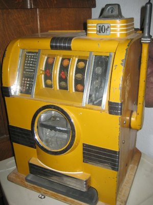

Congratulations on your find! I have owned and/or restored at least three Commanders over the last ten years; I guess I find the "look" more attractive than most.
On the positive side, it appears your machine is relatively complete, and some care was taken by whoever got hold of it before you. On the nit-picky side, I prefer the original, factory color scheme to this red-and-yellow. I'm attaching pictures of what the yellow/orange scheme looked like: it was white piping trim for all standard colors. Also, let me tell you how much I hate the reproduction reel strips that were installed on your machine:

I watched your video, and yes, the cycle is too fast. That is probably an effect of low hydraulic fluid in the pump, which as you indicate is percolating out the top casting around the crankshaft. I agree that that seal needs replacement.

You'll have to look for the cause of your jackpot feed problem: temporarily remove the reel window casting and glass, and that'll give you a better look at what's going on at the bottom of the escalator. If you need some guidance on that, PM me and maybe we can arrange a time to confer by phone. At any rate, you ought to enjoy tinkering with your nice Caille Commander!
Added note: I think you might be missing an essential part for the jackpot feed. Please post a handle-side-view of your mechanism.

The Caille machines in the Dough Boy line are often confused; the Commander and the Play-Boy, both of which came out in 1937, are almost identical.
Whoever restored it did a decent job; looks like one of the 6 correct colors. I don't know why he would put a Watling instruction sheet on the back door; that's a little strange; perhaps it was there before restoration and was just left as an interesting anomaly in the machine's history.

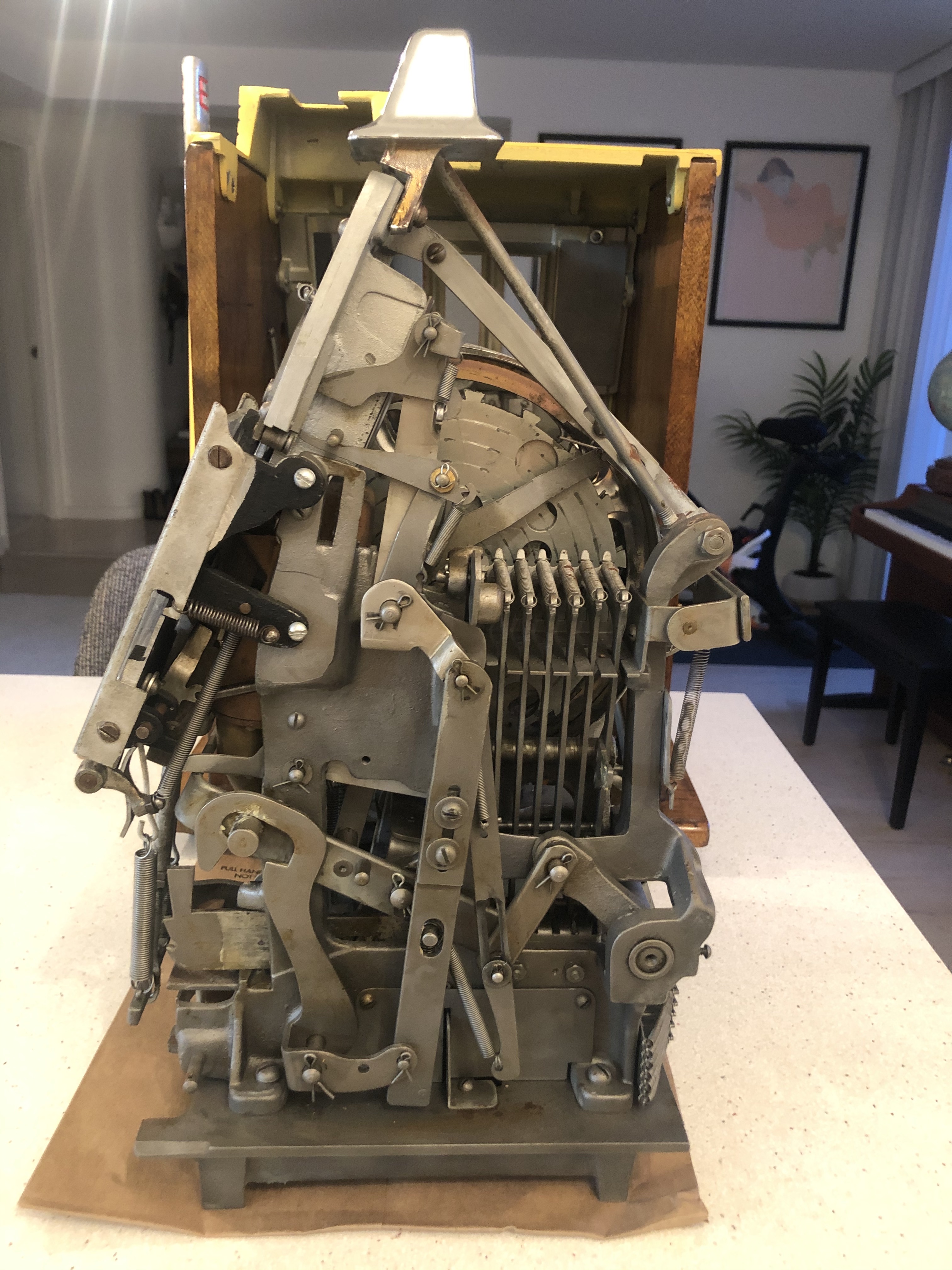

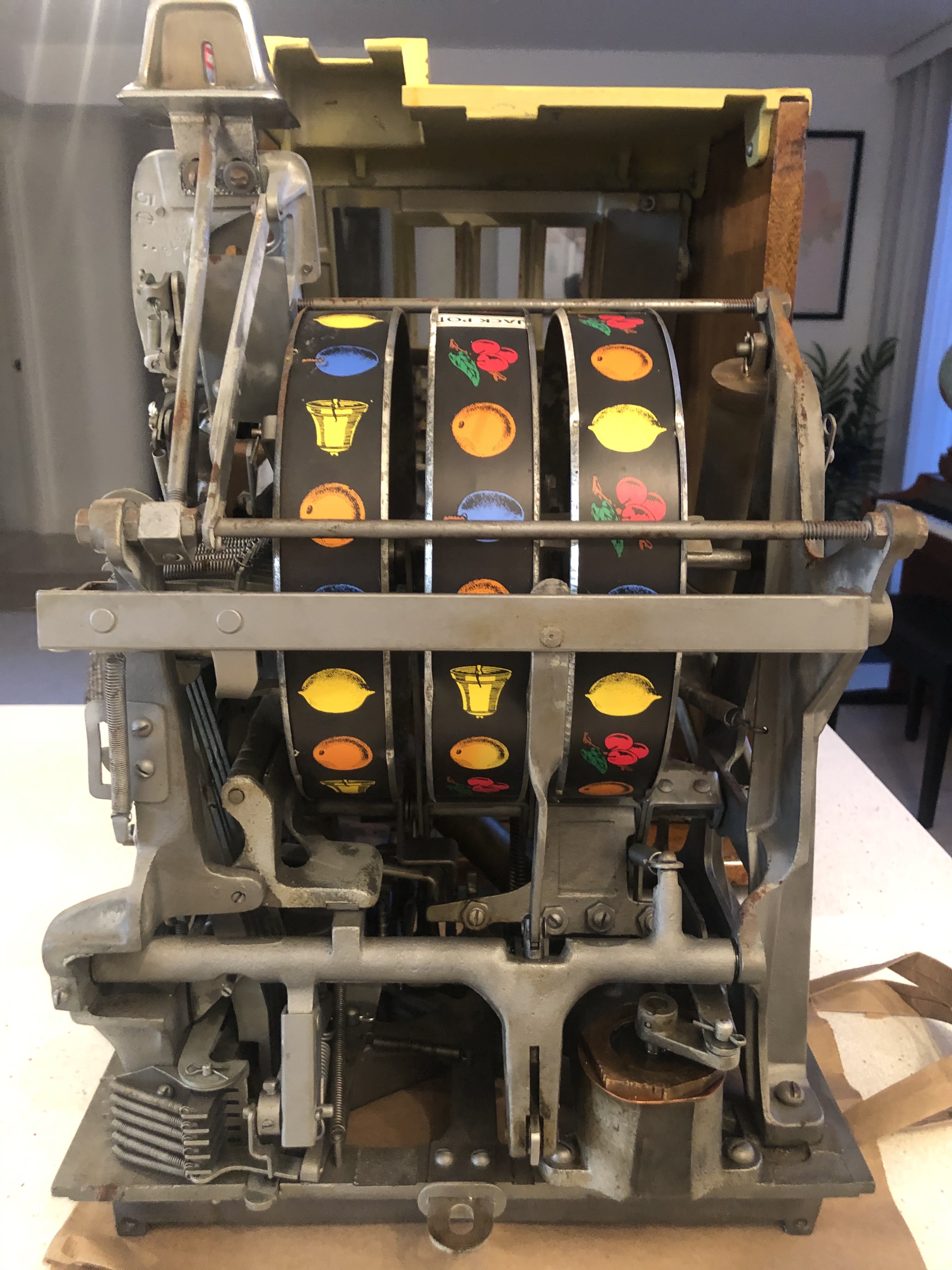

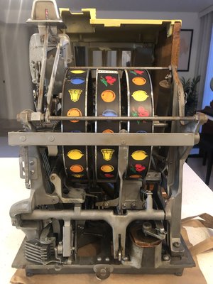

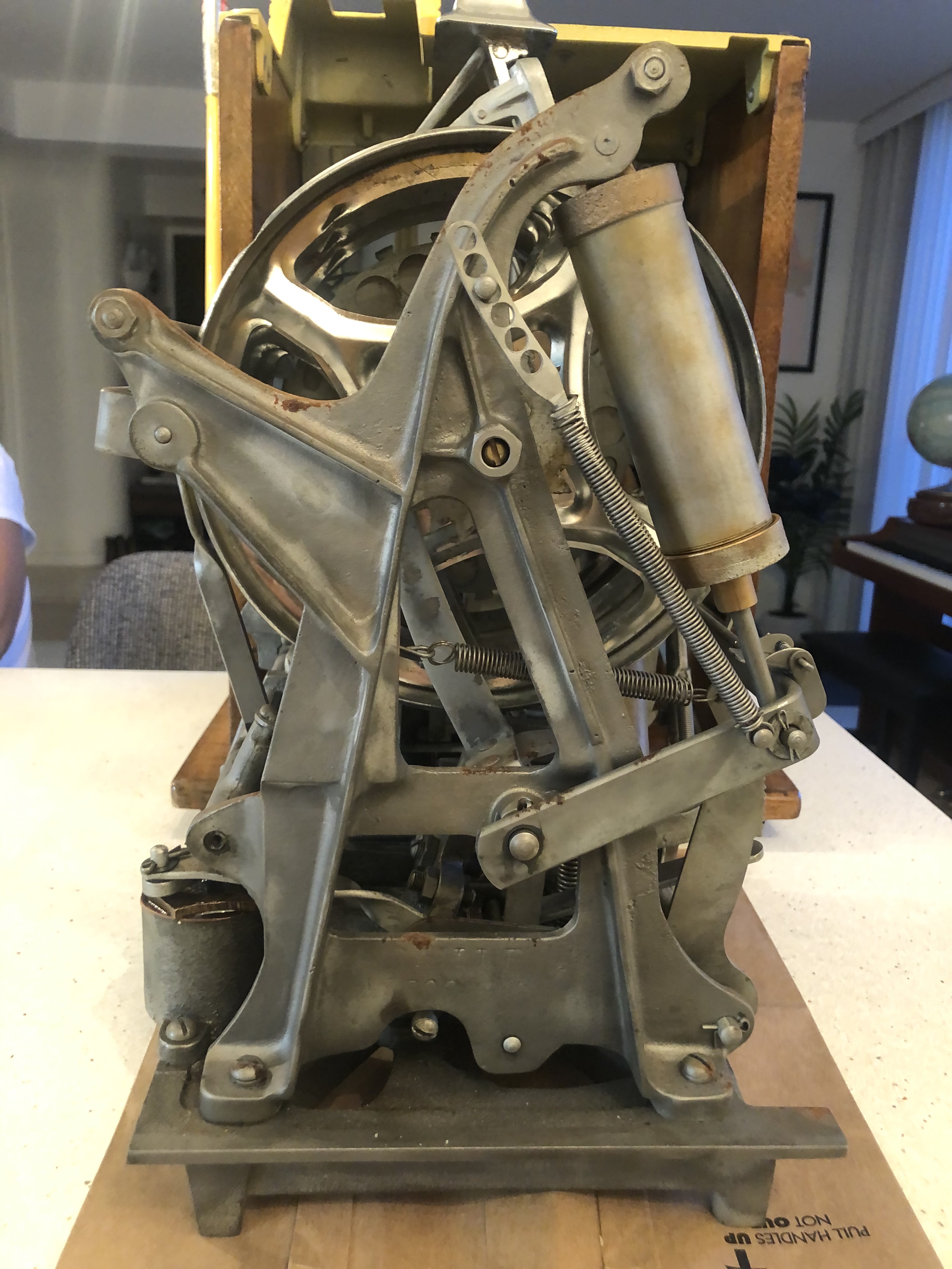

Here are MORE pics:
Mech Handle-side View
(I took the pics prior to reseating a spring, so ignore the spring behind the elevator pointing to the rear instead of straight up.)

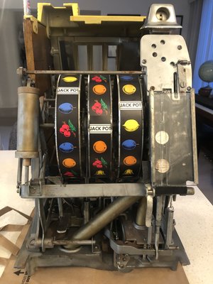

Mech Non-handle-side view

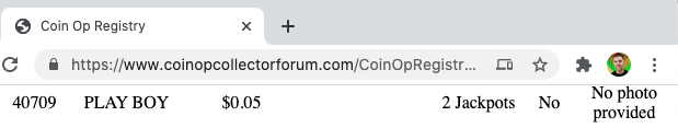

I discovered my mech serial 40709 listed at http://www.coinopregistry.com/ as a "Playboy", but no pics:
Mech Serial 40709 at coinopregistry
Wondering if it's a Playboy mech in a Commander case? ...with the wrong reel strips? (No lemons on a Playboy, right?) ...or perhaps it's just plain misclassified at Coin Op Registry due to the similarities acrosss models?
I'm curious if there's a case/mech mismatch as a result of the restoration or if this was manufactured late in Caille history where techs were assembling frankenslots to get the most out of orphaned parts. Fingers crossed, this one'll end up in @marsonion's "WTF File!"
The fact that the serial is listed at Coin Op Registry makes me anxious to see if someone here recalls actually performing the restoration!

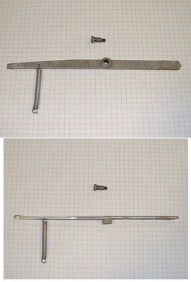

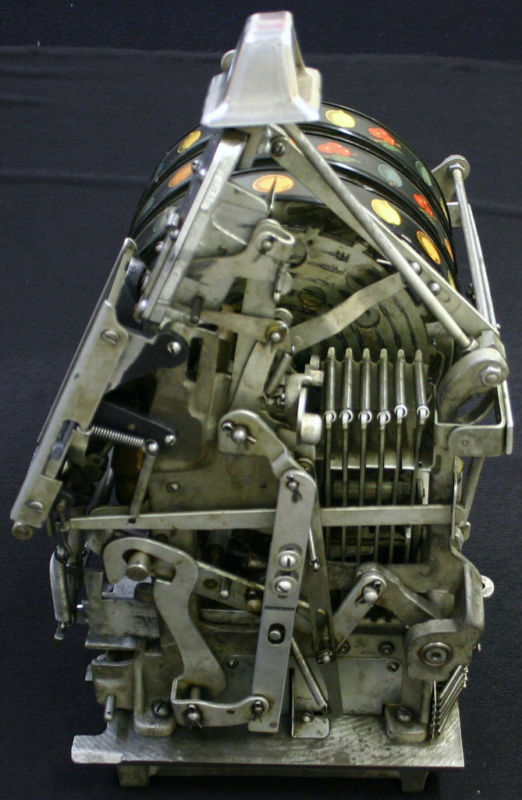

I'm attaching an image of a Commander mech, handle-side view. As you see, you're missing the long horizontal bar that communicates between the cherry payout finger and the jackpot feed hardware. Fortunately, this is an easy part to replicate, or you could make a functional substitute for it out of plastic until you can find the original part.

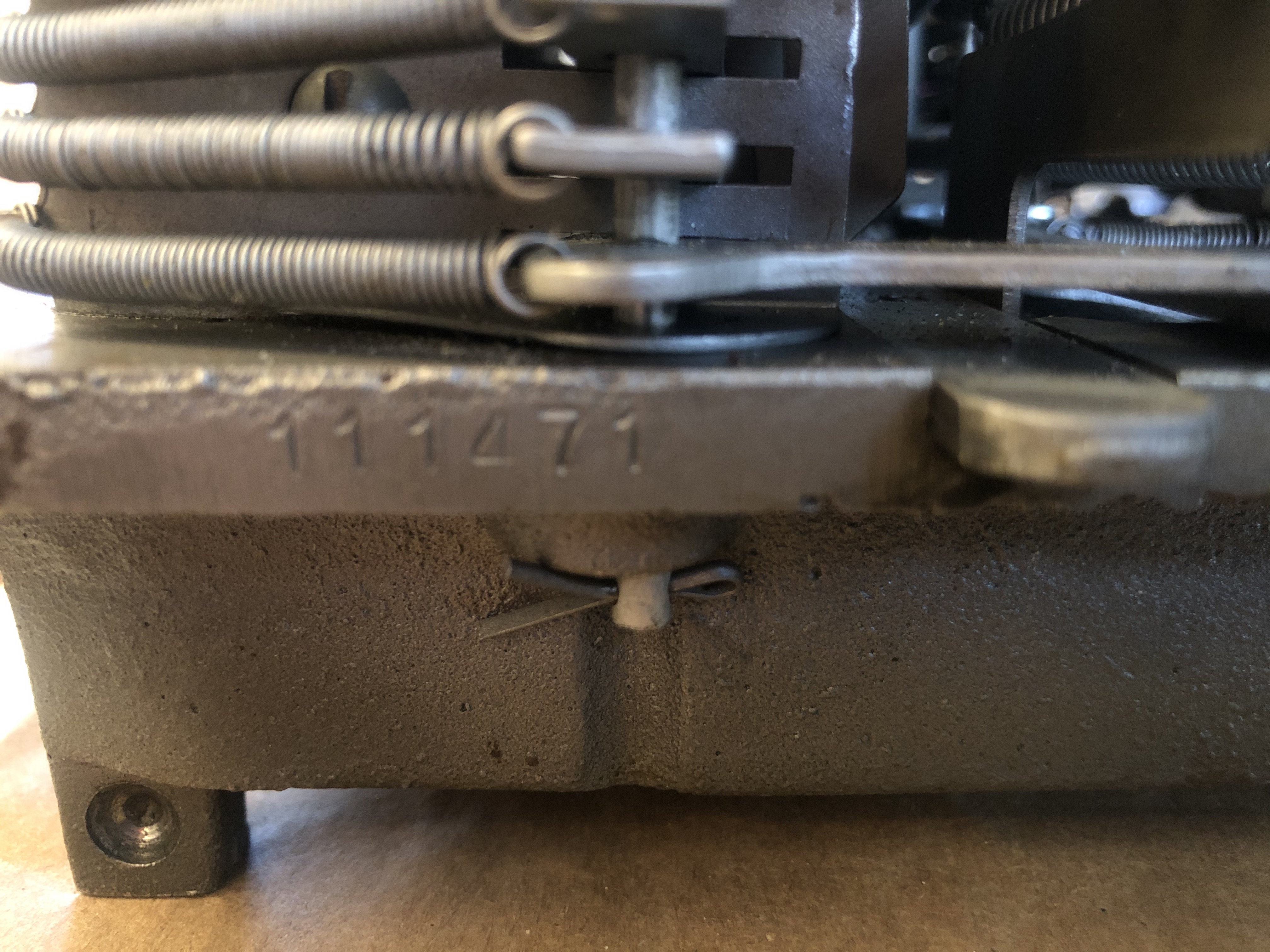

I'm very sure that 40709 is not a Caille serial number for your machine; it is a Caille part number for that casting. (The Coin Op Registry entry reflects the same error.) On Commanders, you will find the machine serial number along the rear edge of the mech base casting, typically just below the horizontal finger stack.

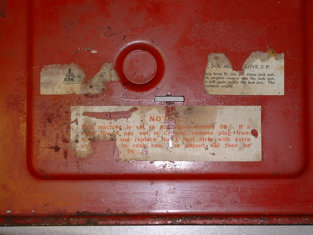

Also, there is no great mystery that you have a lemon on your reel strip where a cherry should be: there were "tight" first reels, and operators were offered the option of "pulling the plug" and substituting a more liberal payout schedule. Attached is a notice from the back door of a Commander I fixed-and-flipped several years ago.

With your guidance, I've identified my serial as 111471
Serial 111471
I now understand that my reel #1 is wrapped with the "tight" reel strip, despite the plug being pulled for the more liberal payout. If you have any of those reel strips left that you showed in your "MISREPRESTORATION" post, I'd LOVE to purchase a set! Loosely rolled, would they fit in a Small USPS Priority Flat Rate Box? I can also send you a prepaid mailing label to make it easy.

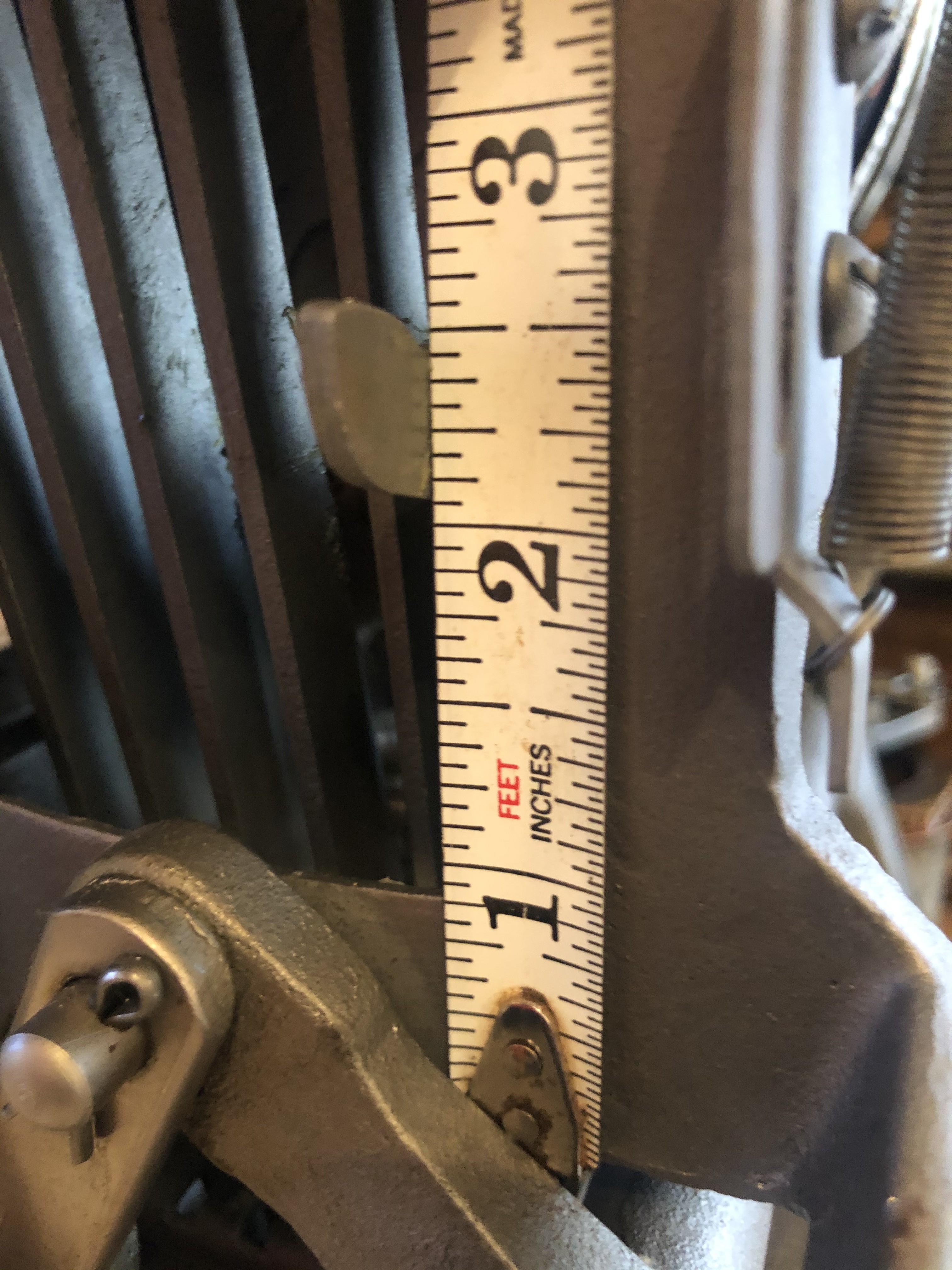

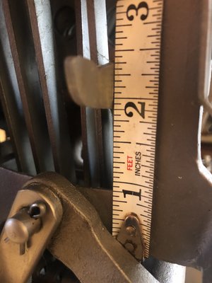

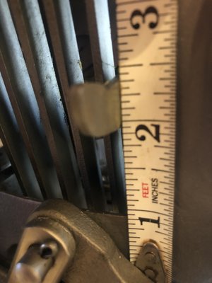

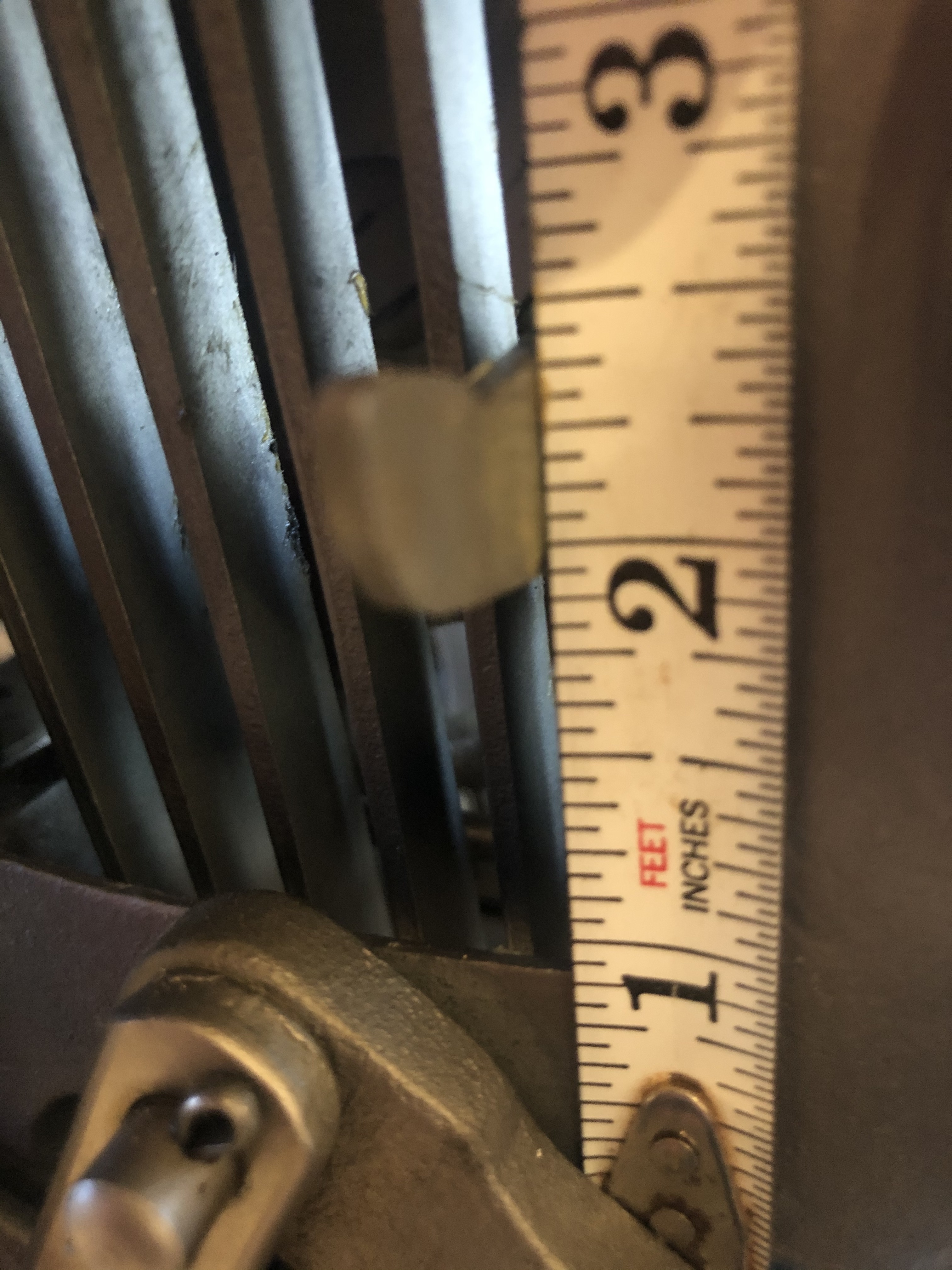

I very much appreciate your pic of the missing horizontal bar! I'm not totally clear how it works. From your photo, it looks like it needs to travel a great distance back-to-front in order to engage the elevator coin stop release. I do have the benefit of a metal shop two blocks away, so I'd be excited to fabricate a solution if I can obtain measurements or a trace of the part.

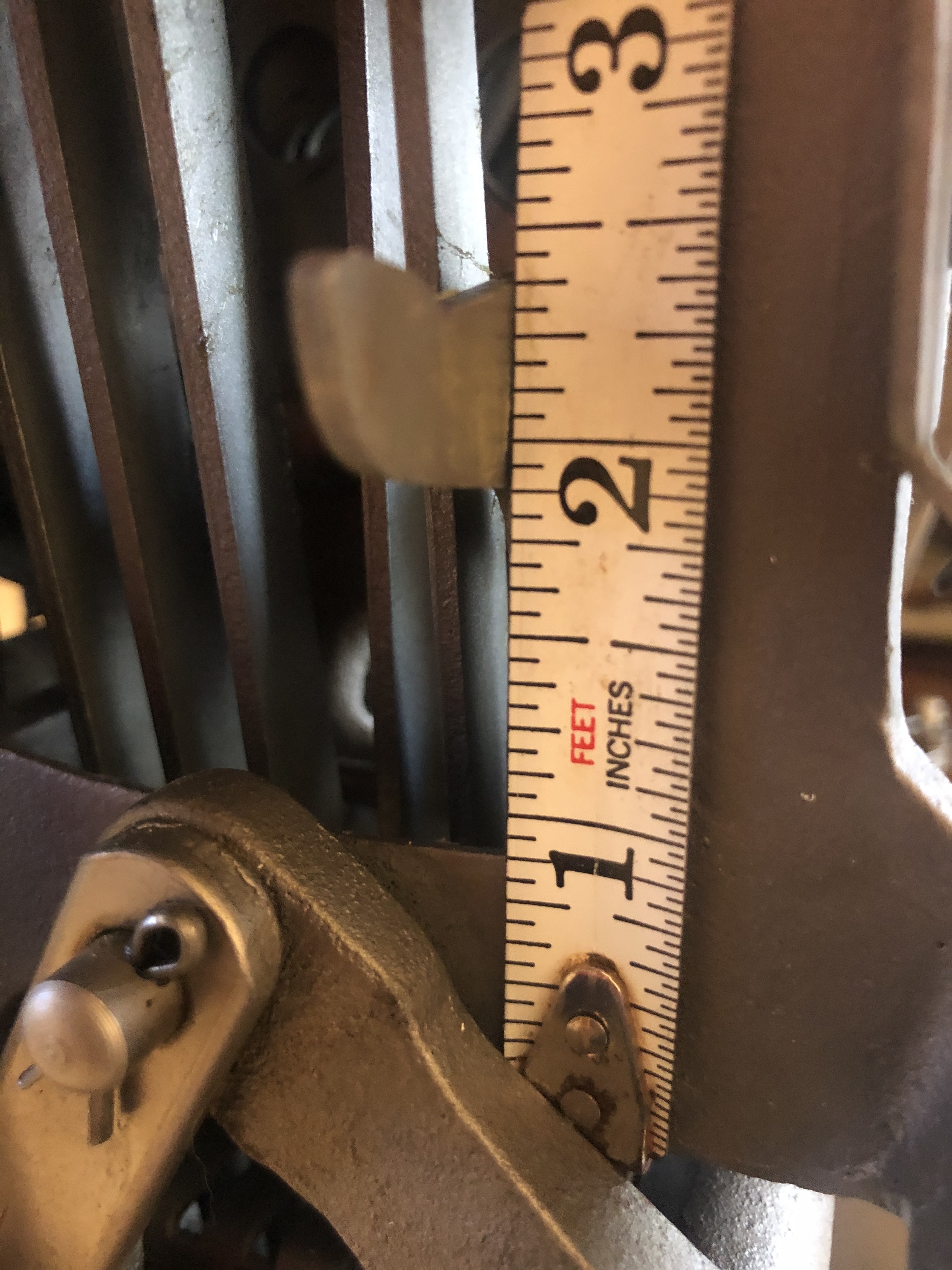

I measured the travel of the cherry finger tab and it appears to move only very little, so I'm not fully clear how it properly affects the horizontal bar.
Two Cherry Finger Position
One Cherry Finger Position
No Cherry Finger Position

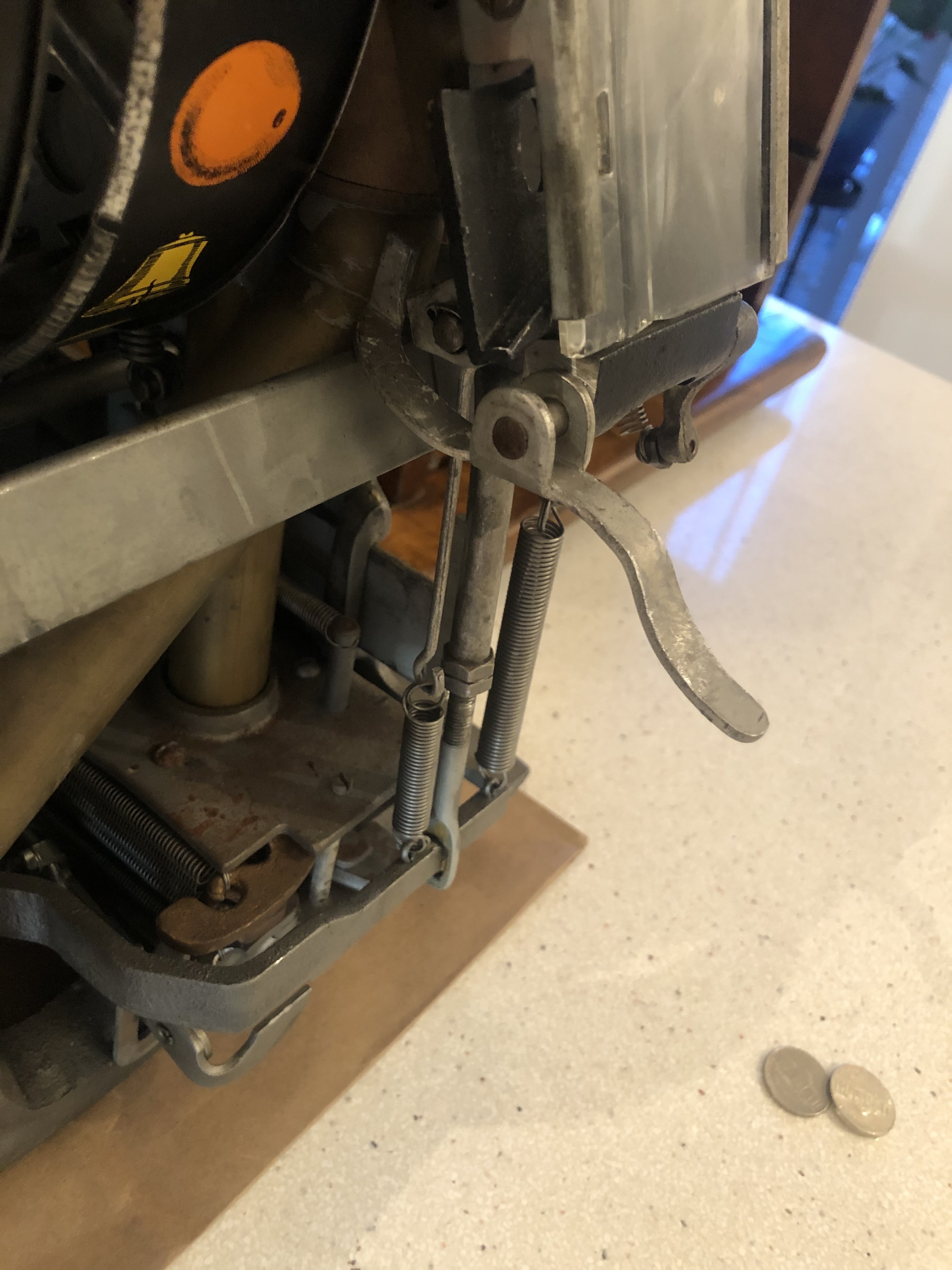

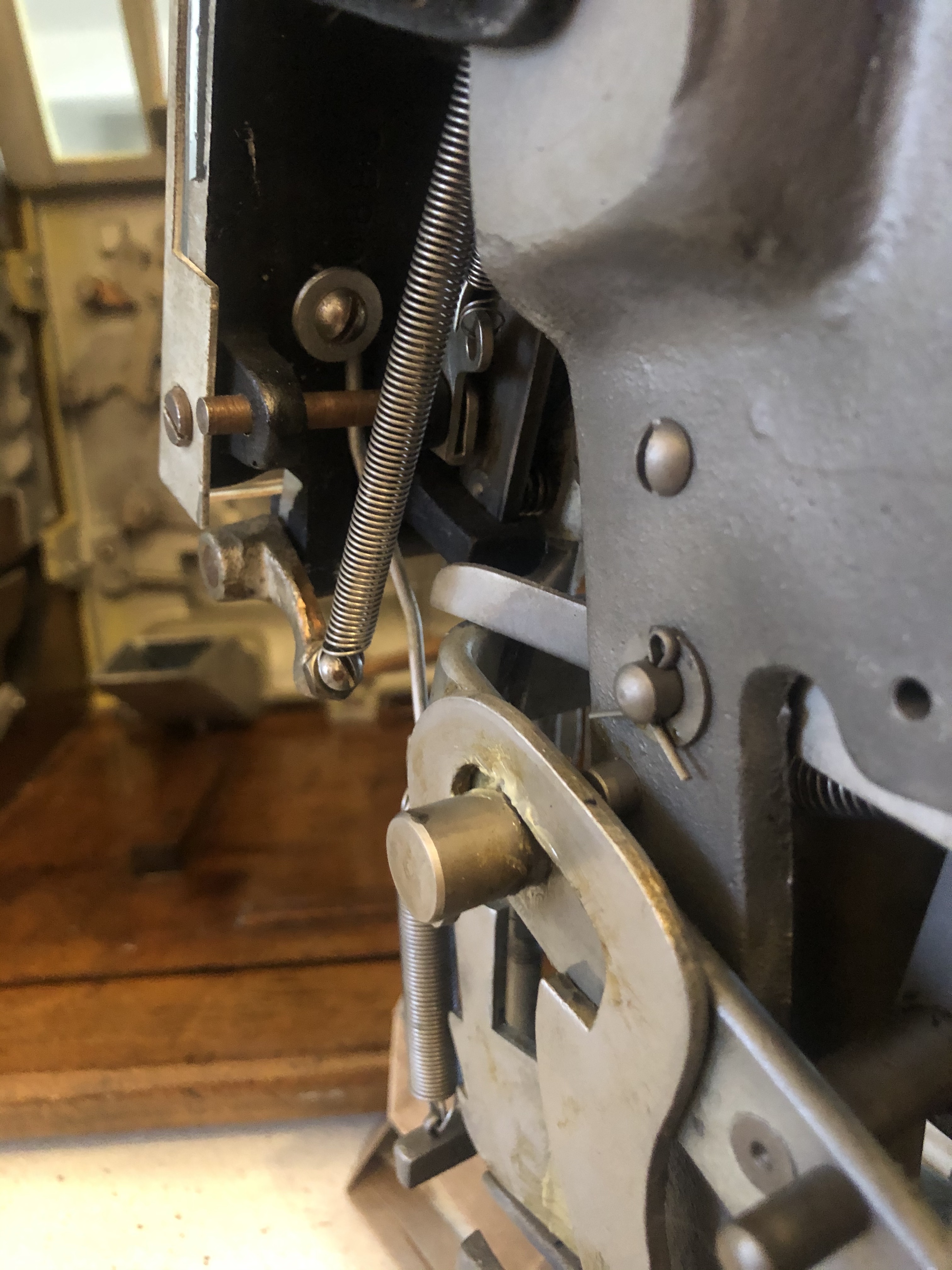

My escalator jackpot coin stop is currently held closed by a spring. I anticipate the missing bar should engage right where that spring is currently attached?
Jackpot Fill Spring View

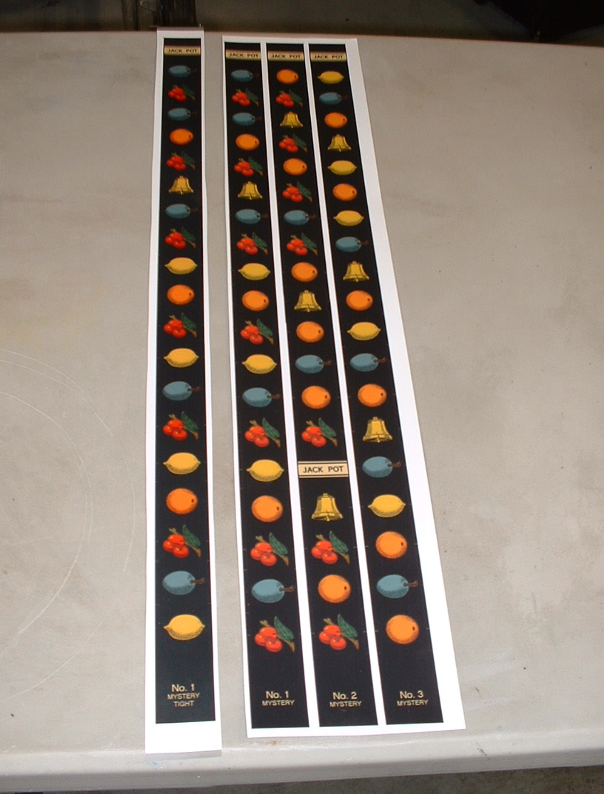

I do indeed have a nice set of "Mystery" black reel strips; please check the symbol order carefully to be sure they're right for your machine. The separated "tight" version first reel strip ought to match the one you've got, which should be replaced with the regular first reel strip. These are printed on card stock and laminated semi-gloss, which matches the look of the original strips to a remarkable degree, plus you can simply wipe off any grease or dirt, which is something you sure can't do with any of the paper strips repro'd elsewhere. $35.00 plus shipping; PM me if interested.

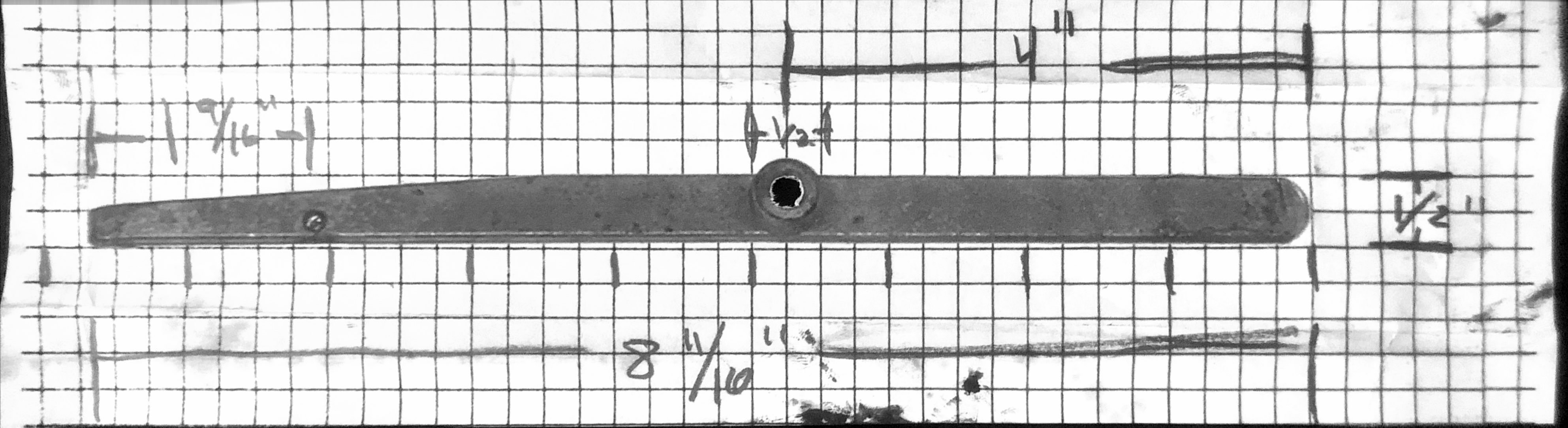

Also, the part you need on 1/4" quad paper. It's mostly just a shape cut from 1/8" steel, with a bushing stuck to it. Hopefully, the previous restorer had the common decency to leave you the shoulder screw threaded into the casting; if not, you'll have to make yourself one with a piece of brass tubing. (I don't own the part I photographed here, so I can't sell it to you.)

The photos are SO helpful, thank you @marsonion! I was able to scale & skew your photo to match my 1/4" graph paper and print to scale so that I could accurately measure the bushing and spring hole placements for fabrication.
Feed Arm Diagram
The metal shop down the street "Heavy Metal" has been enlisted to weld the bushing, shape the ends and drill the holes. I'm pumped! The restorer did not leave the screw, but I'm confident I can find a match and a spacer to replace that no problem. The bushing & screw hole was obscured in the first photo of the bar mounted on the mech. Now that you've generously provided the photos of the part in full view, I recognize how the cherry payout finger on the shorter side of the bar affects the travel on the longer jackpot feed side using that pivot point.

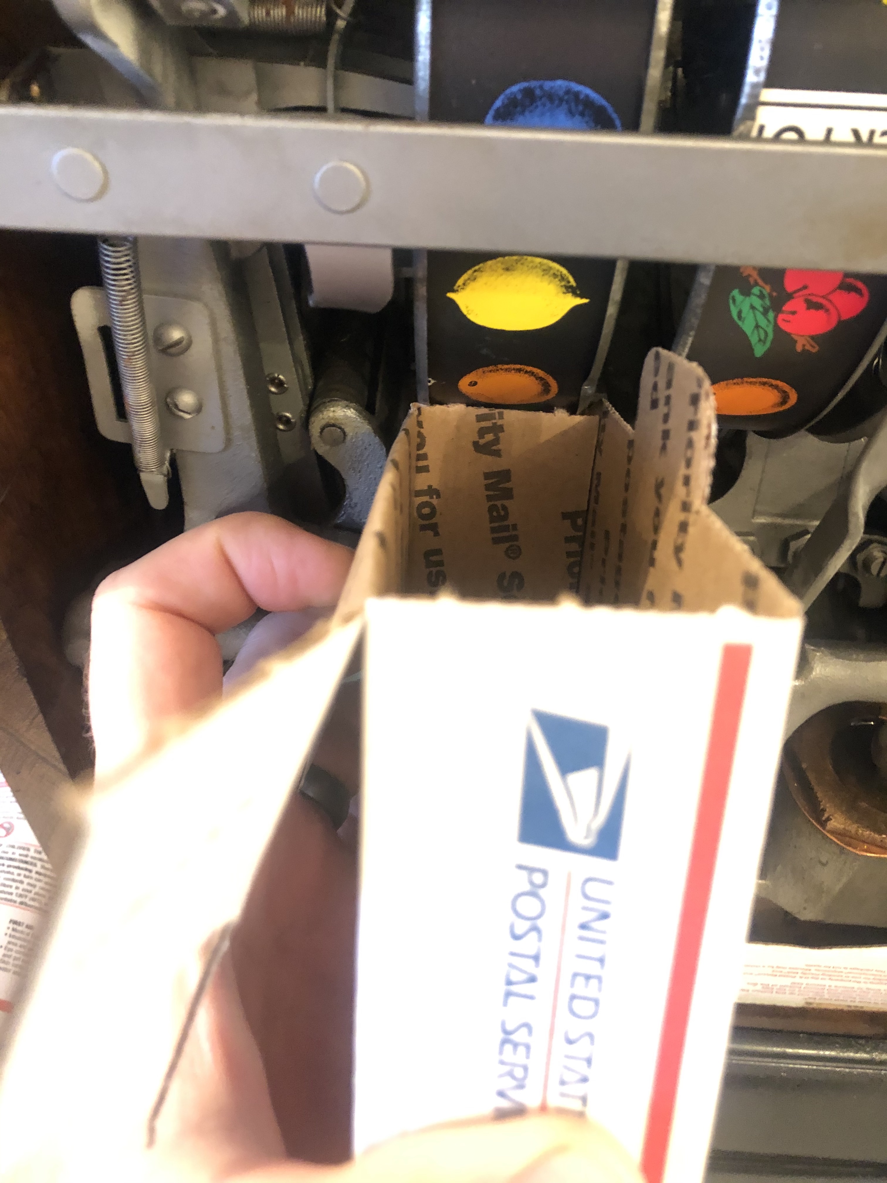

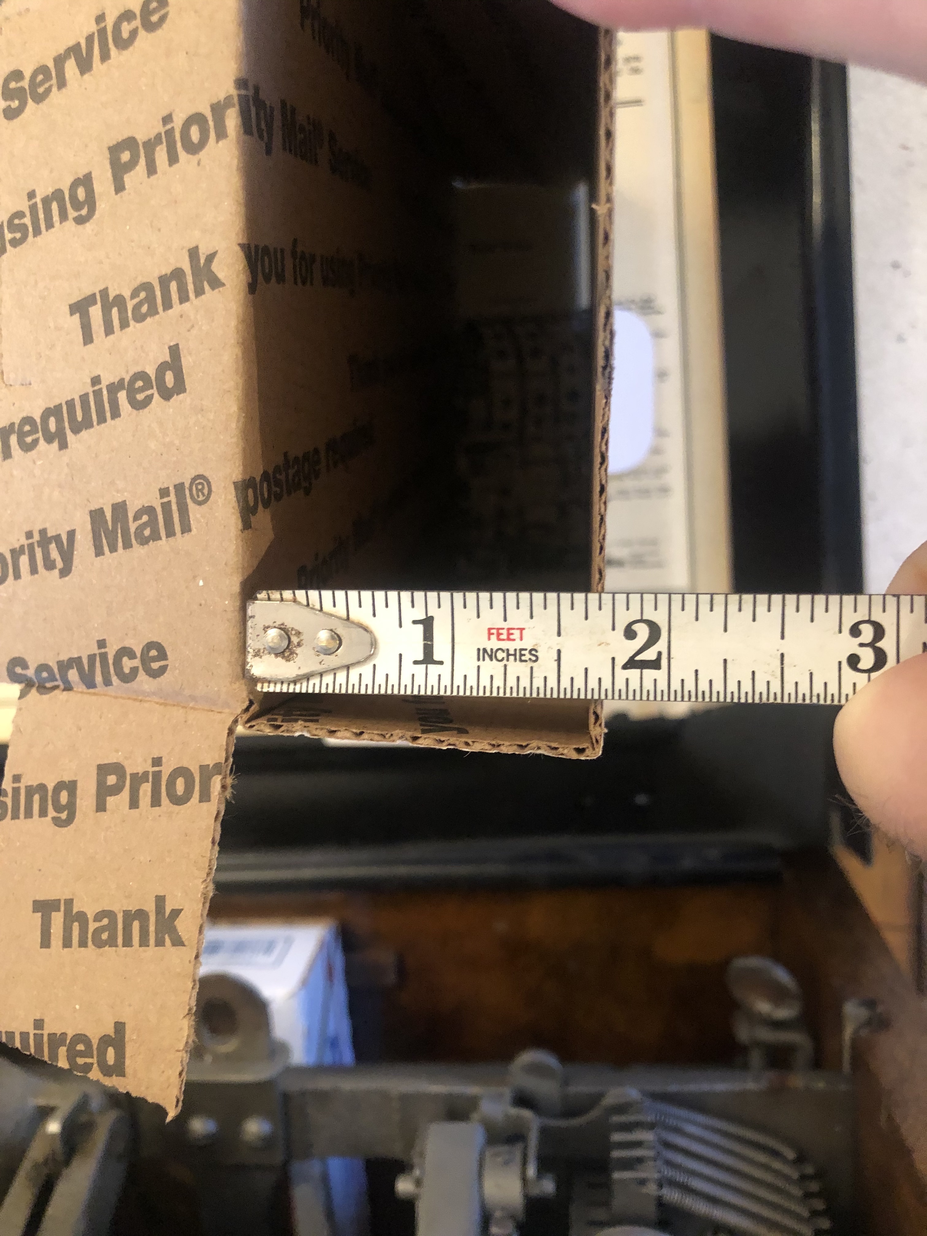

I verified that my reel strips order are exact matches. I also measured to see if they'd fit in a USPS Small Priority Flat Rate Box. It looks ideal!
Reel Diameter
USPS Small Priority Flat Rate Box Diameter
Reel Fit Inside USPS Small Priority Flat Rate Box
