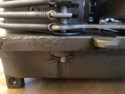

I'm attaching an image of a Commander mech, handle-side view. As you see, you're missing the long horizontal bar that communicates between the cherry payout finger and the jackpot feed hardware. Fortunately, this is an easy part to replicate, or you could make a functional substitute for it out of plastic until you can find the original part.
I'm very sure that 40709 is not a Caille serial number for your machine; it is a Caille part number for that casting. (The Coin Op Registry entry reflects the same error.) On Commanders, you will find the machine serial number along the rear edge of the mech base casting, typically just below the horizontal finger stack.

With your guidance, I've identified my serial as 111471
Serial 111471
