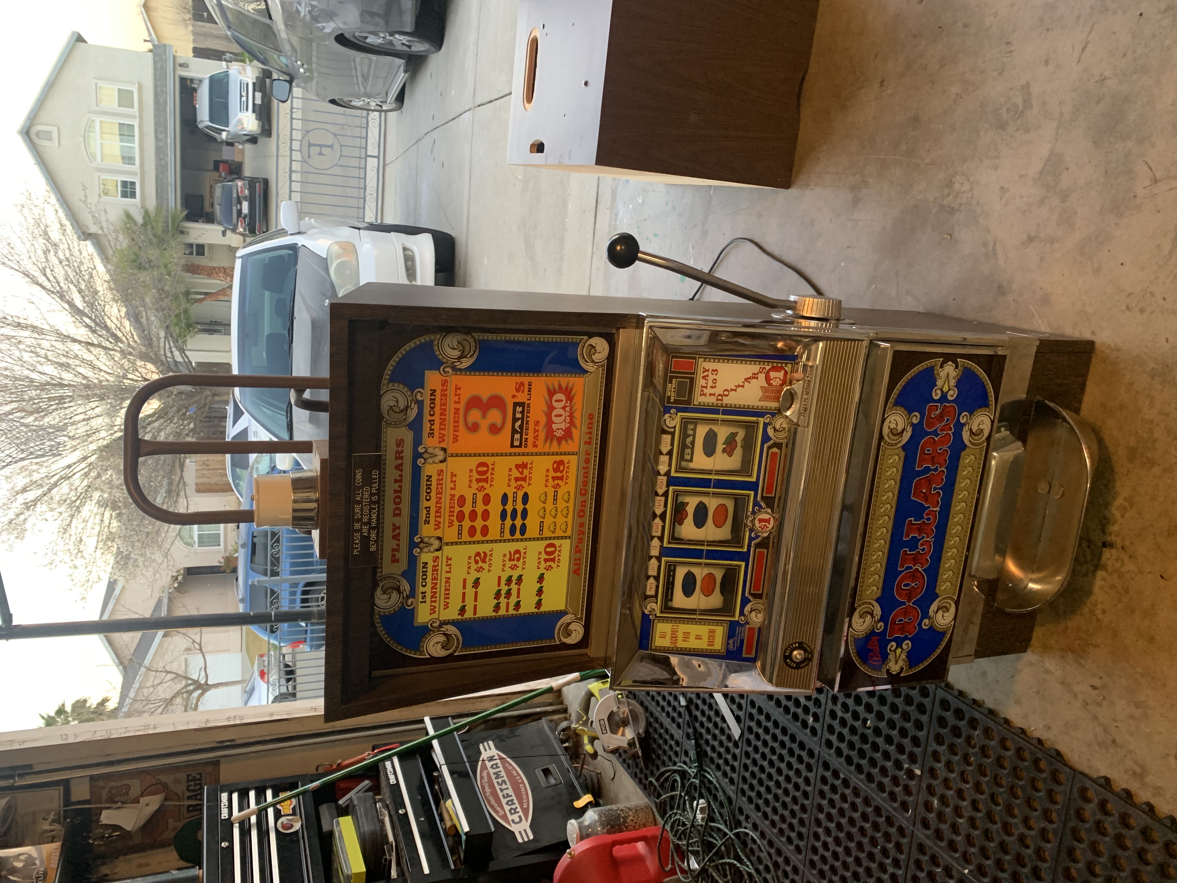

Hi, I am so happy to be part this wonderful website.
I have been repairing Japanese pachislo slot machines for months now.
I recently acquired a gorgeous Bally’s 1088-2 quarter slot machine.
The unit is in great shape!
The reels spins and all lights work.
The problem with the unit is that it’s stuck in “Tilt” mode. The tilt light is on all the time. So it doesn’t pay out.
I’m looking for help fixing or bypassing the tilt sensor. I have not trouble shooted it as it seems a little more complex than the pachislo machines I’m used to, lol.
I’ve attached photos of the beauty.
Bally’s 1088-2 slot machine

Here are the pics of the machine.
Here is some more info:
-The winners paid light remains on, the meter count is 003. Not sure what that means.
-The machine tilt light is on, but will still accept coins, and reels spin, although I never seem to win, so maybe the tilt is preventing it from winning?
-I’ve pressed the safety timer reset. Nothing happens.
-I’ve pressed this cherry button to the right of the reels. Nothing happens, and I don’t know what that’s for.
Dave, thanks for helping, I do not see any red buttons on the hopper. I’ve attached some photos of the hopper.
Some notes on the hopper;
There’s a capacitor that looks beat up but not leaking or bulging.
The motor on the hopper has a third prong that no wire is attached to? Is this normal? (See pic)
The hopper spins only if I press a latch on top to disengage it. And it’s a little tough, it doesn’t just free spin.
Inside the unit I found a note that the previous owner had wrote on, although he said he never attempted to actually fix it.
Here’s the note:

Postby RameGoom » Thu Feb 25, 2021 8:53 am
I think your written note answers your questions.
That broken tab, don't worry about that since there's no contact on it.
The capacitor (note referred to it as a resistor) is damaged and no doubt shorted.
On that part, there should be some information; xx MFD, xx VDC. That will determine what you need to replace it. The part is readily available, called an electrolytic capacitor.
This should get you going and get the machine working again.

Postby karloz25 » Thu Feb 25, 2021 10:31 am
RameGoom wrote:I think your written note answers your questions.
John
Thanks for your reply, I ordered the capacitor from eBay, should arrive in about 5 days.
I sure hope that fixes the tilt.
I have seen or heard ZERO life in the hopper since I bought it.
upload pic
Regarding the broken tab, I would still like to fix it. Can it be soldered? It does have wear marks where it made contact with the little round bumper piece.
Can these be ordered? What are the official names for these?

Postby RameGoom » Thu Feb 25, 2021 11:20 am
If that contact finger actually contacts a moving part, then yes, you should replace it. Not sure if soldering it will work because it's supposed to flex.
Check with pinball parts suppliers - it's called a leaf switch and you can replace individual leaves in it if you can find the right length.
John
