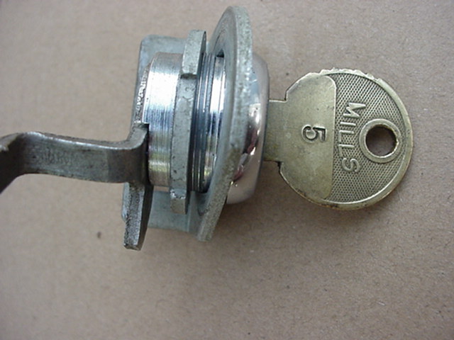

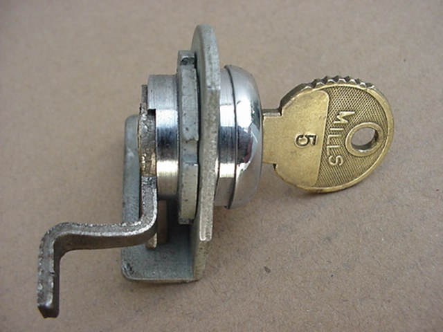

Postby radiorich123 » Sun May 14, 2023 12:04 pm
I re keyed this mills lock. Works good.

Postby shortrackskater » Sun May 14, 2023 12:14 pm
Thanks for the replies and the re-key photos.

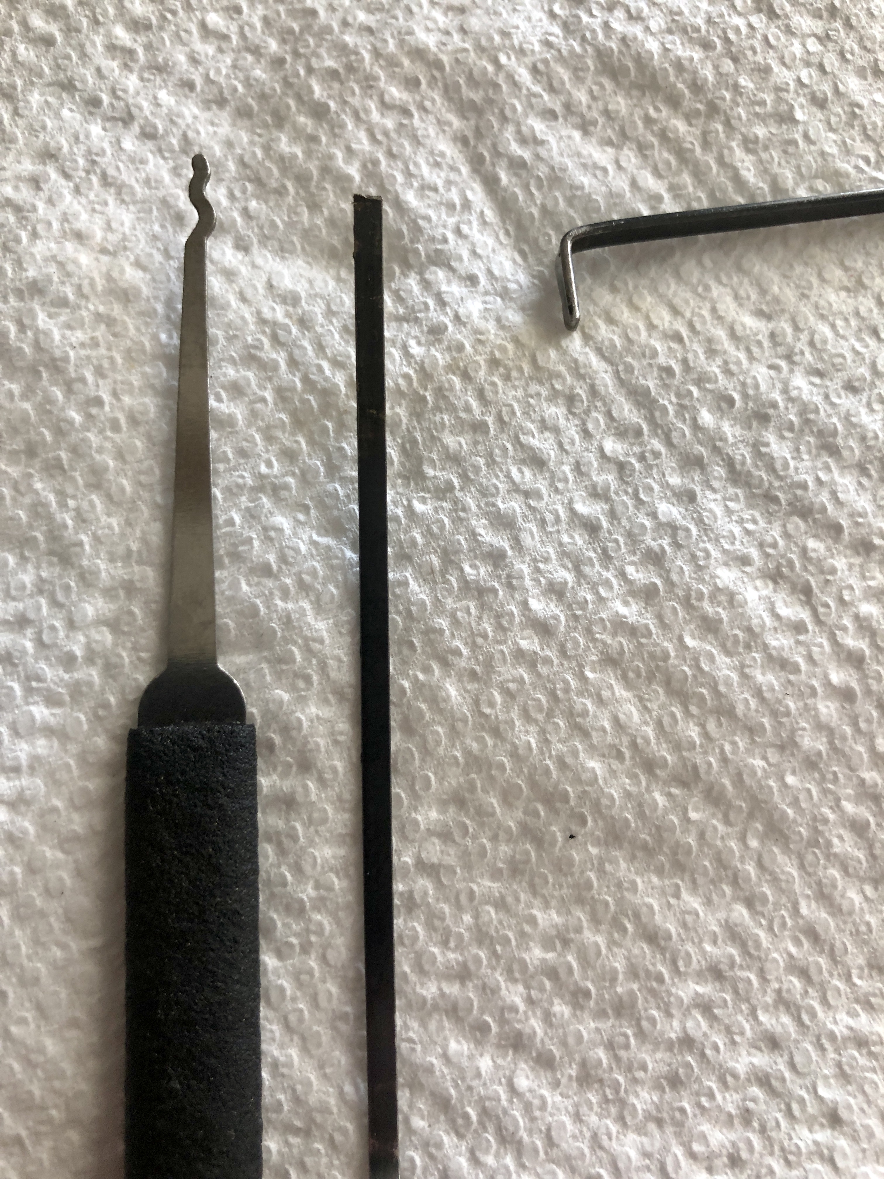

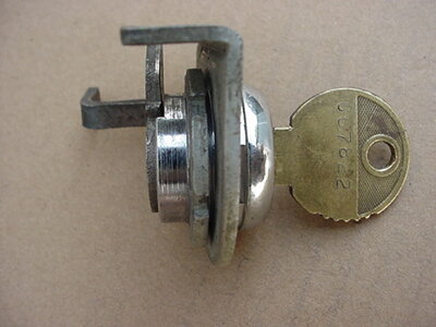

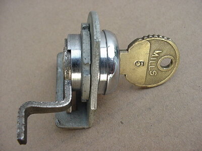

Postby shortrackskater » Mon May 15, 2023 2:58 pm
Here are the three tools I used: one is the snake pick, two are torsion wrenches with the thin one being used as a pick. I modified the torsion wrench so I had more maneuverability for the other two.
I couldn't get a photo of them "in use" because it takes both hands to do this. I have been picking regular locks for a number of years now so I have a good sense of feeling.
Basically I used the snake and thin torsion bar together, holding them like chopsticks to sandwich and manipulate the pins. The problem is it may take a LONG time to get all the pins in the correct up/down position for the lock to turn. So you need patience.
