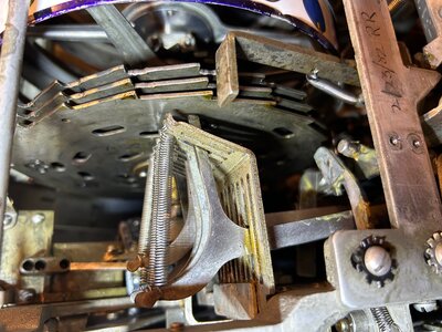

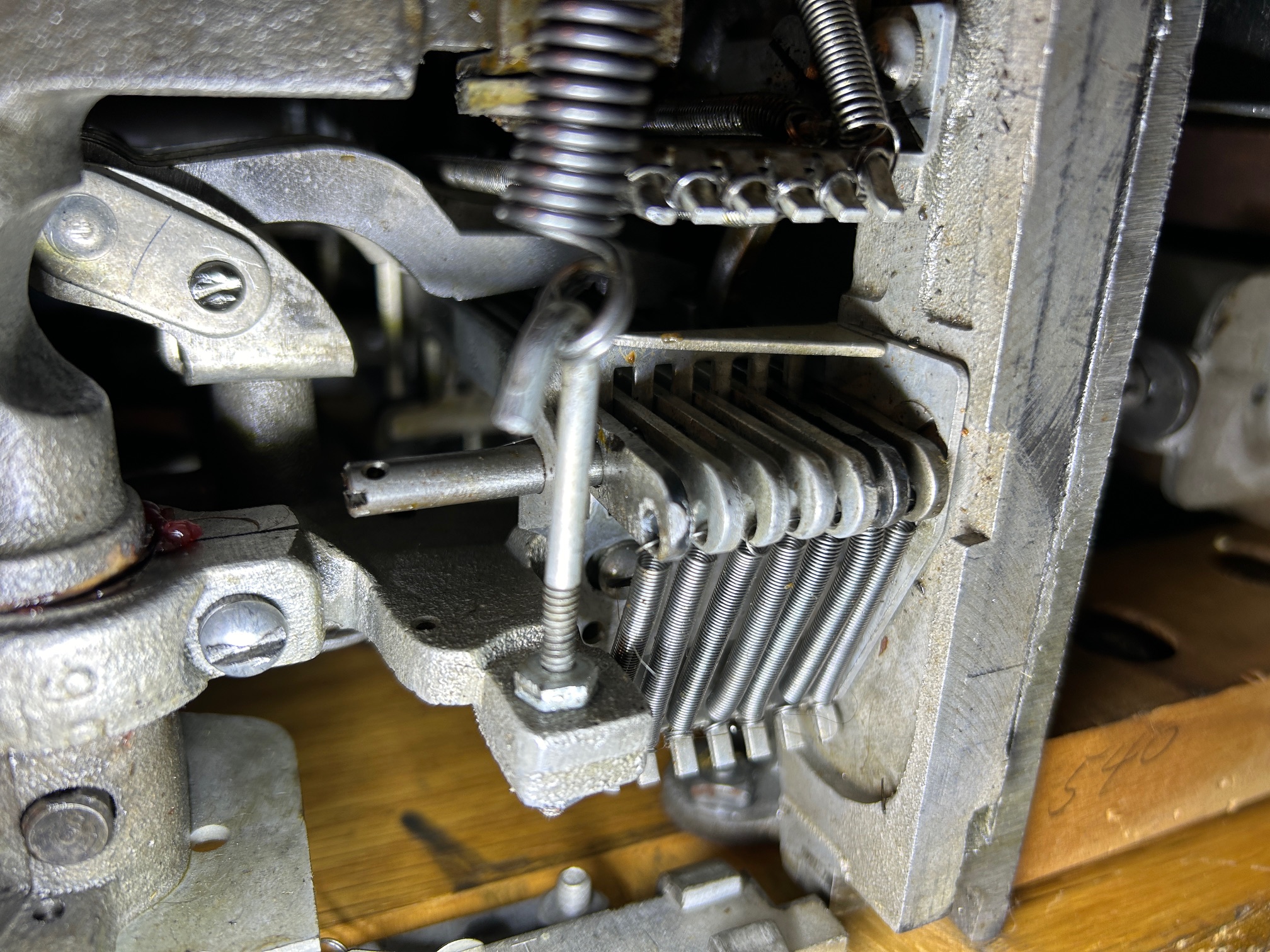

Here are 2 pics of the back of my machine. I don't see any "bugs". Can anyone help me figure out where or what I need to do to improve odds?
Thank you in advance!

Postby 63mini » Wed Nov 29, 2023 8:37 am
VitaminC914,
There is no easy way to improve the olds on a mechanical machine. Now, I did notice that on your second photo there is a weld plug/patch on your payout disc. This is in the 12 o'clock position where a cherry symbol would have been. You could remove that welded plug/patch and get a replacement reel strip (or set). But since your reel strips have the Fitzgerald logo on them, they would not be easy to find. You could take a spare strip and cut out a Cherry symbol and do a "patch" on the existing reel strip. This would not look good, but it would "Improve" the odds. In my opinion it would be too much work if you are not familiar with the R&R these parts. I would just play it and enjoy it as is.

Postby oldslotman » Wed Nov 29, 2023 10:00 am
VitaminC914 wrote:Here are 2 pics of the back of my machine. I don't see any "bugs". Can anyone help me figure out where or what I need to do to improve odds?
Bugs would be on the reel stop.
