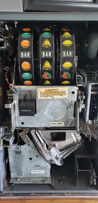

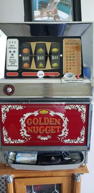

I am in South Florida, my family has had a Bally Gold Nugget slot machine for over 20 years and it stopped working recently. I was hoping to find a forum like this where we can do some trouble shooting or find someone close enough to maybe help out.
I really don't know anything about these machines, any advice is greatly appreciated. I'm also curious what a machine like this is realistically worth to see how much to spend to fix it.

It worked great for a long time, it jammed up once and ever since we just let it it there. I just don't even know where to start. It could be the most simple solution in the world or the thing is completely shot. Any help is greatly appreciated!

Hello and Welcome, I don't live close to Florida, but I do have 4 EMs slots so maybe I can help you identify your issue. Your machine hit a Bar jackpot so if it ran out of coins the safety timer will shut off the machine and you just need to push in reset button.
1. Does the machine have power?
2.If you do have power do you see a red light on the bottom section behind the Coin Hopper?
3.You stated "jammed" when you add a coin does it drop into bottom tray with the power on?

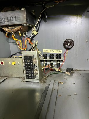

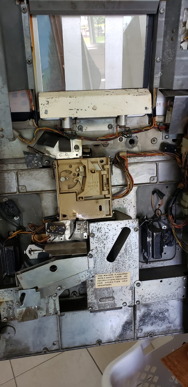

I was able to do some more troubleshooting. Here are a few more details and answers to the questions asked.
I know there’s power there’s a humming noise in one light illuminated but when I insert the coin it doesn’t register. The side that has information on payouts isn't illuminating as far as I can tell.
1. Does the machine have power? -
Yes most of it lights up, just not the payout side. It makes a faint humming noise, but opening and closing the front door will eventually make that stop.
No the red light is not iluminated.
Yes it drops in fine, but doesn't register anything on the screen.

Postby 702collector » Wed Mar 06, 2024 2:31 pm
Did it drop into the bottom tray?”payout tray” or did it go to the hopper?
Did you hear a solenoid when the coin went in?
Could be a burned out bulb behind coin accepted
Will the handle pull?
The buzzing is probably the coin acceptor.
