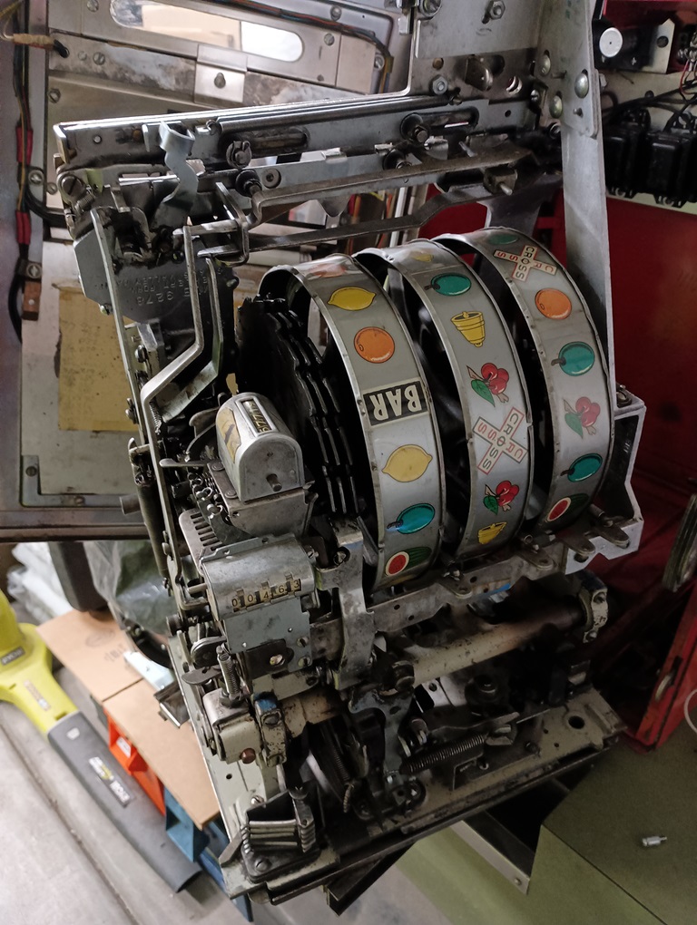

So, when you cycle the mech and stop the clock, do the reels spin freely by hand? Do they spin freely individually? I just want to be sure that they are not binding on each other.
Were the reels disassembled to thoroughly clean the reel bushings and axle? If so, was the kicker removed and cleaned? You could have a worn kicker, or it just has hardened grease and is not pivoting properly to kick the reels.
Those are the first things I would look at.
