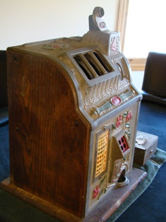

Hi -
I'm new to this and just acquired a nice Mills 25c Poinsettia machine.
It needs a little work but seems complete.
Looking for some help on identifying the year. The serial number appears to have been chisled off - wondering if there is another place to look for it?
Others I've seen on the internet don't have the 3 individual glass panes over the reels.
Also looking for parts or restoring help in the Denver/Colorado area.
Appreciate any wisdom!
BG

HI
I had this machine and the 3 seperate glass over the reels are correct The bar that is attached to the clock meck in the back looks not original. Something fishie here. The year is 1930 oe 1931 the serial # should beetween 248000 and 273000.
Rich
