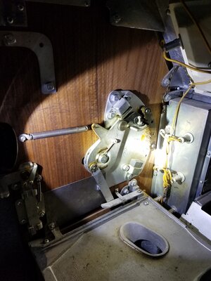

Thank you for having me. I have had an interest in slot machines for many years. My first slot that I bought was thru the antique trader. It was a mint original 10 cent war eagle. Found under a bed in North Carolina. That was the good. The bad was the casting was broken in shipment. What a heart breaker so it had to be returned. The next cool machine I owned was a mill bonus horsehead. Also in mint original condition. I bought some property to build my family a home so it had to go down the road. Darn shame but so goes life sometimes. Then I purchased an outstanding 5 cent Jennings sun chief also in excellent original condition with the manual. That is what brings me here. I spin the machine every couple of weeks and my family plays it a few turns when they visit. Always has worked fine. Recently it started to act up. I noticed this question on another thread but there was no solution so I am hoping someone can help. The slot arm will swing freely after I play it a couple nickels sometimes. I move the whole machine slightly and then the arm will engage and play fine. The nickels will circulate in the escalator and the arm move freely always but it does not engage the mechanism. Nothing jammed. A slight movement to see what is going on and it works fine from there on out.

Show some hirez photos of the handle side of the mech, right side from front as this will help anyone here to possibly diagnose your issue!

here are some pictures. I do see wear on the lever gear on the right side of the mechanism. I have posted a picture of it. Not sure of part name .I do have the original manual .

Well, maybe it's just my Old Eye's but from the photos you posted I don't see anything obvious sticking out!
I doubt seriously it is an inside the cabinet issue, either escalator or right side of mech, handle side, issue!
Possibly someone else here on the forum can supply some advise as sometimes without "hands on" it can be hard to solve a problem!

Can you tell me the name of the part in the top photo that shows gear like teeth ? I took the mech out yesterday and cleaned these teeth. There is quit a bit of wear on one section of the teeth while another section looks like new. After cleaning the teeth I reinstalled the mech and have not had one misfire so far. Thinking maybe that the issue is worn teeth from old age and use just like mine. :)

Postby plentyofcoup » Tue Nov 16, 2021 10:01 am
Have done some lubing of parts and for now the problem seems to have disappeared.
