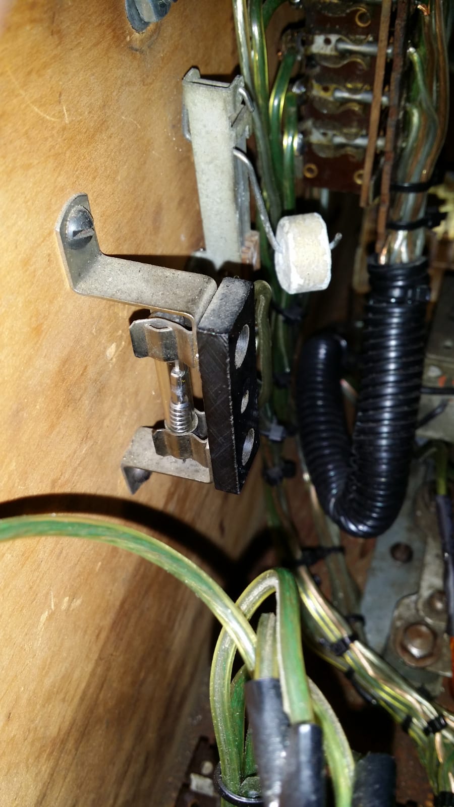

When i have a payout ,with the fuse already taken out for that Solenoid, thereby breaking the circuit, I get 13.2V acroos the fuse Lugs.
(see picture on back of machine next to tilt switch).
I watched it snap shut at 6V on a bench, yet it is marked at 110V on the schematic.
In the game it just hums and slowly pulls in spitting out two coins every 5 seconds whereas it used to sound like a machine Gun!
