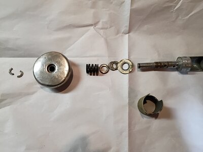

Hello all. I just thought I would post a way to remove the knob / handle for the gum vendor. Many of you probably already have a way to do this but I thought some may not.

Not sure what happened, but part of the post didn't show up. On the pic is a tool I made. Place it on the knob and use a small bar clamp to compress the spring. Then you can remove the keepers from the shaft. Hopefully this helps someone.
Don
