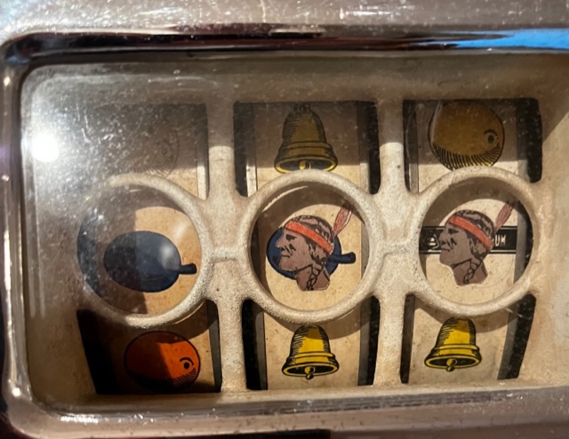

Thanks for all your work and yes it is fun to find out as much as possible. I recently purchased 6 slots and all have something. Here in the Netherlands I notice some are build of different parts from different machines.
They play fine but miss things like with my Chief. I got an Wild Indian with I think maybe not the original reel strips but I am not sure. Machine looks great and plays well so I don't. bother.Below example of the Indian head.
