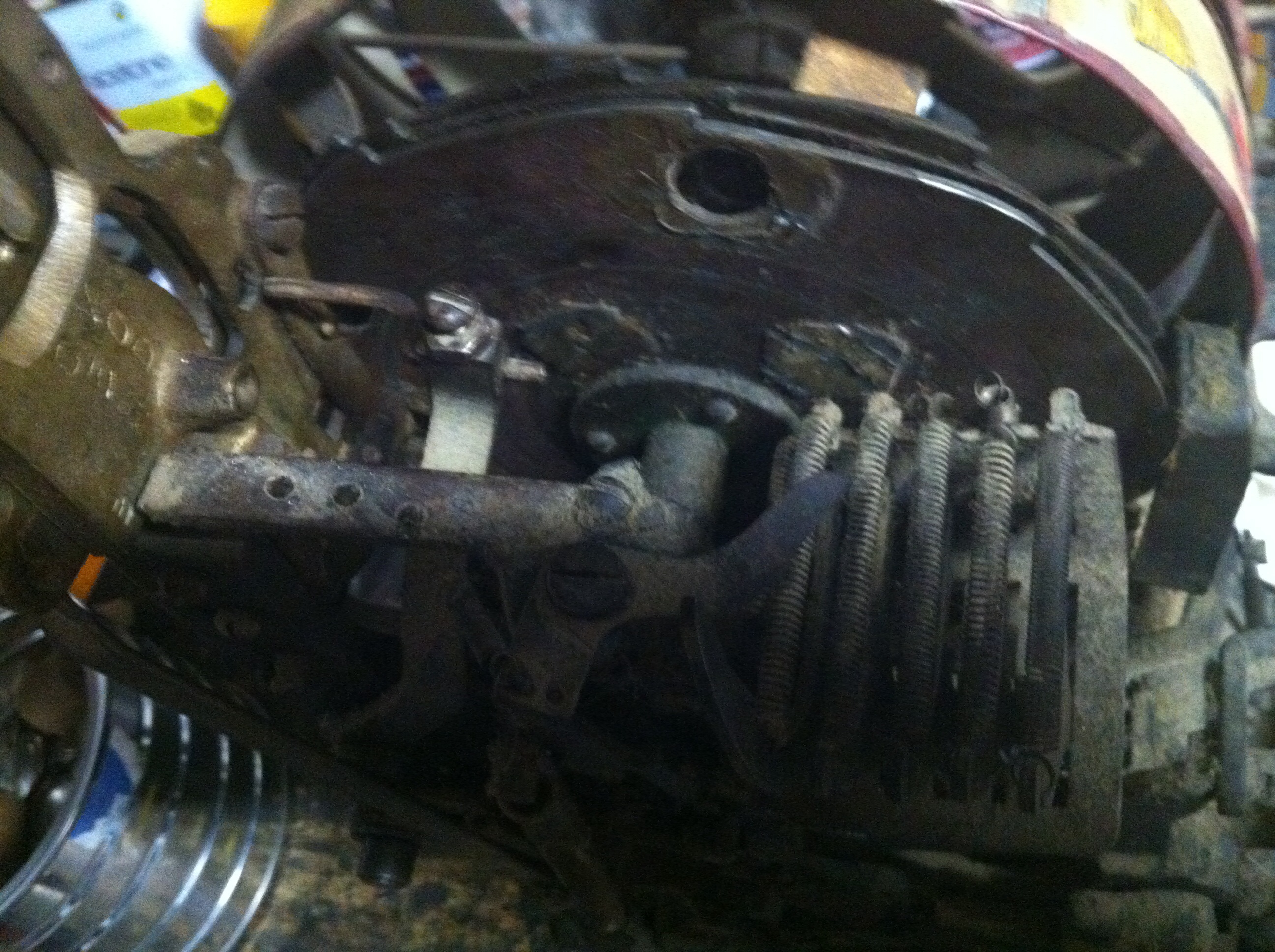

Yep and one of mine had a bug. Rick B

What's to do here ? Leave it as is or make it pay like it should ?

Definitely take all bugs off. You want the machine to pay the best odds. It's now in your collection, and not on location any longer,
so you want it to be fun. Right? You don't want to cheat your friends. Or do you? [-X
Most people tend to think that the bugs began with the 3 reel slots. Not the case. Many of the Victorian Uprights were gaffed as well.
I find them all the time, and remove them, unless a customer wants them left on. Most uprights only have two high pay spots, and one
of them is usually blocked, as well as several others. I even have a trade stimulator, that was gaffed at the factory, if you can believe
that. It's a 3 reel fruit, 10 symbol x 10 stop, with only one bar on each reel, and the star wheel was never cut-out on the 3rd reel bar,
at the factory. Talk about a cheater, and it's a quarter play to boot.

Back to "factory" is nicer. my last one; Aristocrat club master of 1956 (Australia) had a bug added to the middle star wheel, to cheat a 2 coin p.o. (!?!), one leaded in hole, & 2 more filled in with a "plug" = all on the first disc to cheat on little / medium wins,
to go with this , first reel strip had the last 2 images cut & replaced opposite of each other , AND the top 2 pay out slides had been screwed together ,with the head blocking it from going all the way back to actually pay out.
also 2 of the pay out arm springs ( of 9 total) were gone. didn't think much of it first, these do go missing, ect. , then I saw all the other stuff....
this machine is with the "poker" type reel strips. just got it last week , so going over it with a fine tooth comb checking all the reel pay out combinations, ect. good knows what else I might find. this Also has a few "mystery pay out" holes added by the looks of it. (god knows why).
on "Vegas" slot machine discs, many found with the holes spot welded up, & actually east to remove.... hammer & a proper hole punch. of course you have to remove the discs, ect. leaded up holes ,use a new razor blade & "cut" off.
