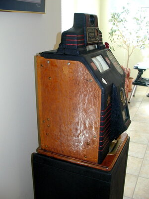

My wife and I (well mostly me) had been thinking for the past several months about buying an antique slot machine. Our original interest was sparked due to being fans of "Pawn Stars" and "American Pickers" on the History Channel. I soon started searching out information on the internet, finding this site and a few others, and began checking eBay and Craigslist every few days, hoping to find a machine near me that I could drive to see and pick up, without having to be concerned about shipping damage.

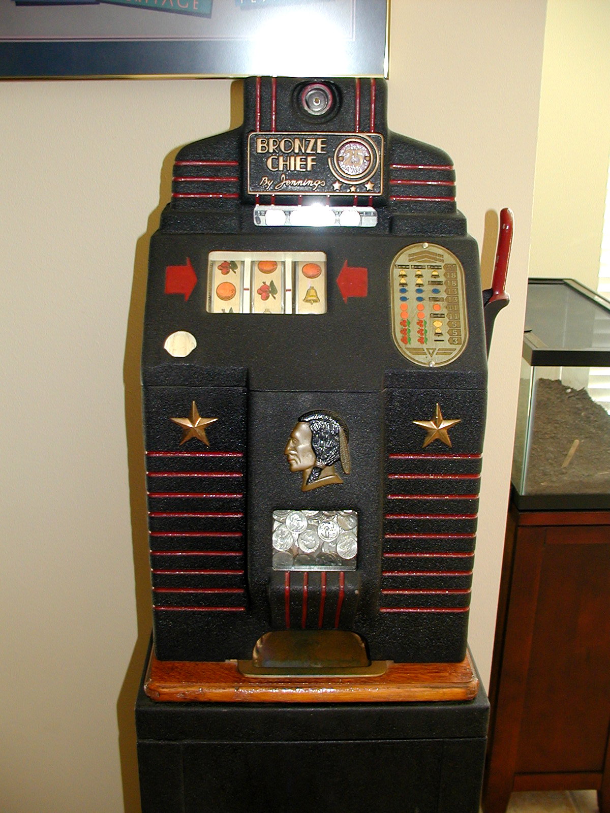

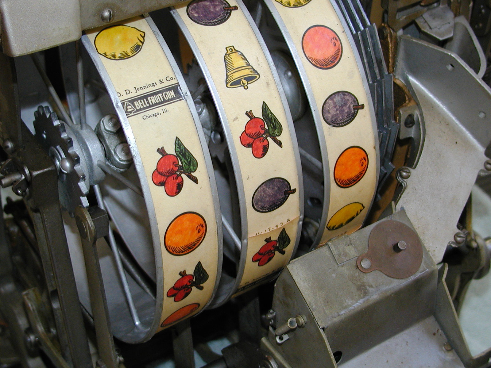

After finding a "Golden Nugget" machine (that looked TOO new) right in my backyard, and stumbling onto Dave's article about how to tell the real-deal from a reproduction, I decided to pass on that one. About 10 days later I found the machine in the picture above on Craigslist. This machine was only about 90 minutes from me. The Craigslist ad had no pictures, but I got the seller to email me a few. From what I could see in the pictures, it appeared to be just what I was hoping to find...... an authentic old machine, that worked, and looked fairly decent. I was told by Don Creekmore (based on the seller's pictures) that the machine is a 1941 model, as determined by its styling details.

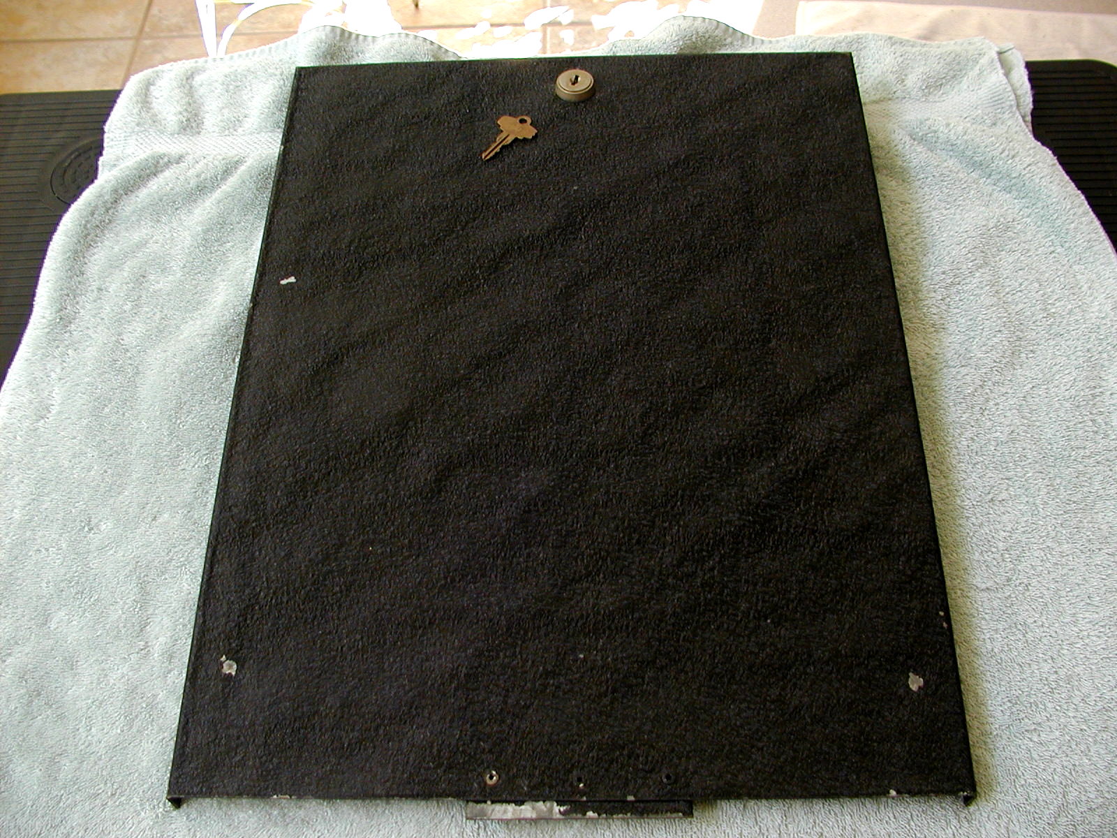

Anyway, I drove to see (and buy) the machine on Friday. The cashbox is missing (cigar box in it's place), and the back cover doesn't appear to be original (fabricated from heavy gauge galvanized sheet steel with pop-rivets). Other than that, the machine looks original as far as I can tell, but I'm not sure about the reels/reel strips.

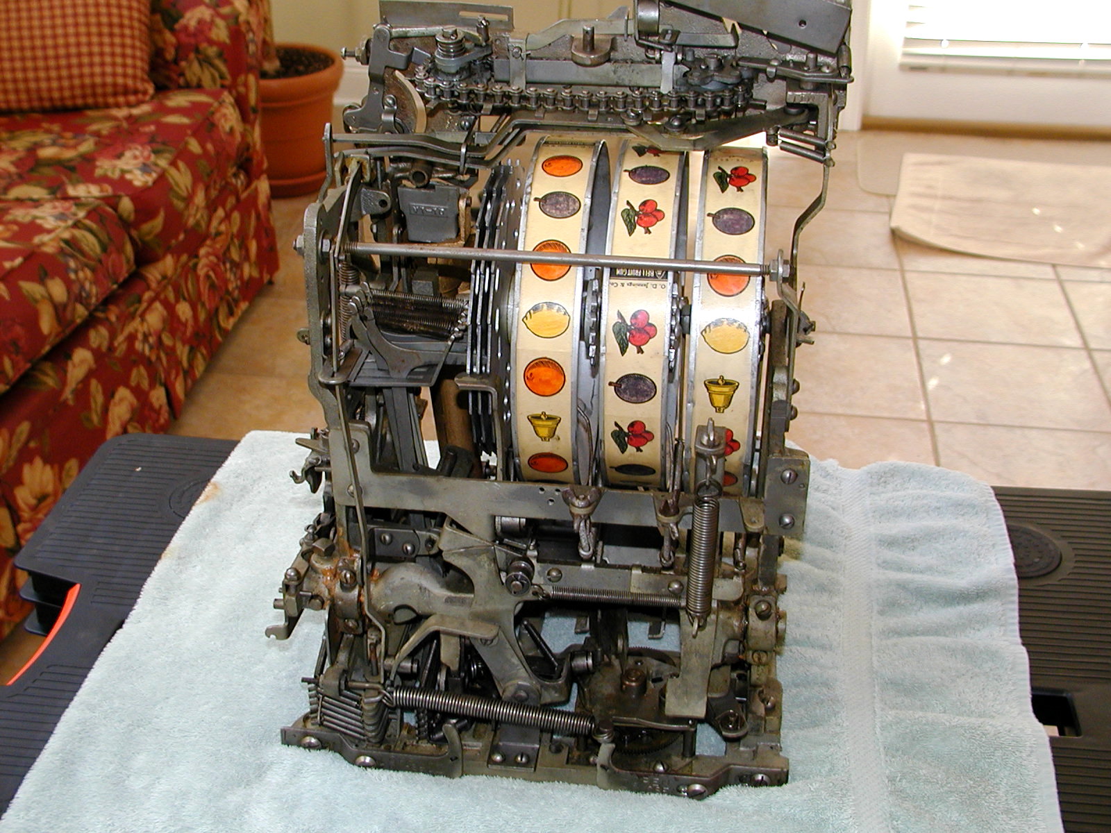

After we got it home on Friday, my wife proceeded to shovel about $50 of quarters into it, at which point it seemed to stop paying out quarters. Not knowing much of anything about how these machines are supposed to work, I figured maybe it was just "out of quarters" to use for the payoff. There were no quarters in the "Jackpot" stash at that point. After a while I took the mechanism out of the case, and saw that I could manually add quarters to the Jackpot reservoir. I added quarters there, but upon putting the machine back together I quickly found that that didn't help. I went back to the internet and discovered enough clues to make me realize that the 3,5,11,13,18 payouts didn't come from the Jackpot, they came from the bottom end of the coin tube via the payout sliders. Sure enough, the bottom payout slider was sticking. I made it operable with a bit of (gasp) WD40, not realizing till later that the payout sliders are supposed to be "dry". Well, it had grease on it before......... that's what caused it to stick . . .

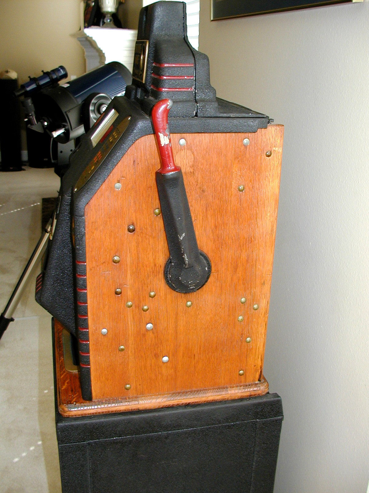

I can read the serial number stamped into the exterior bottom left side wooden panel. Is there any way to confirm the year by the serial number?

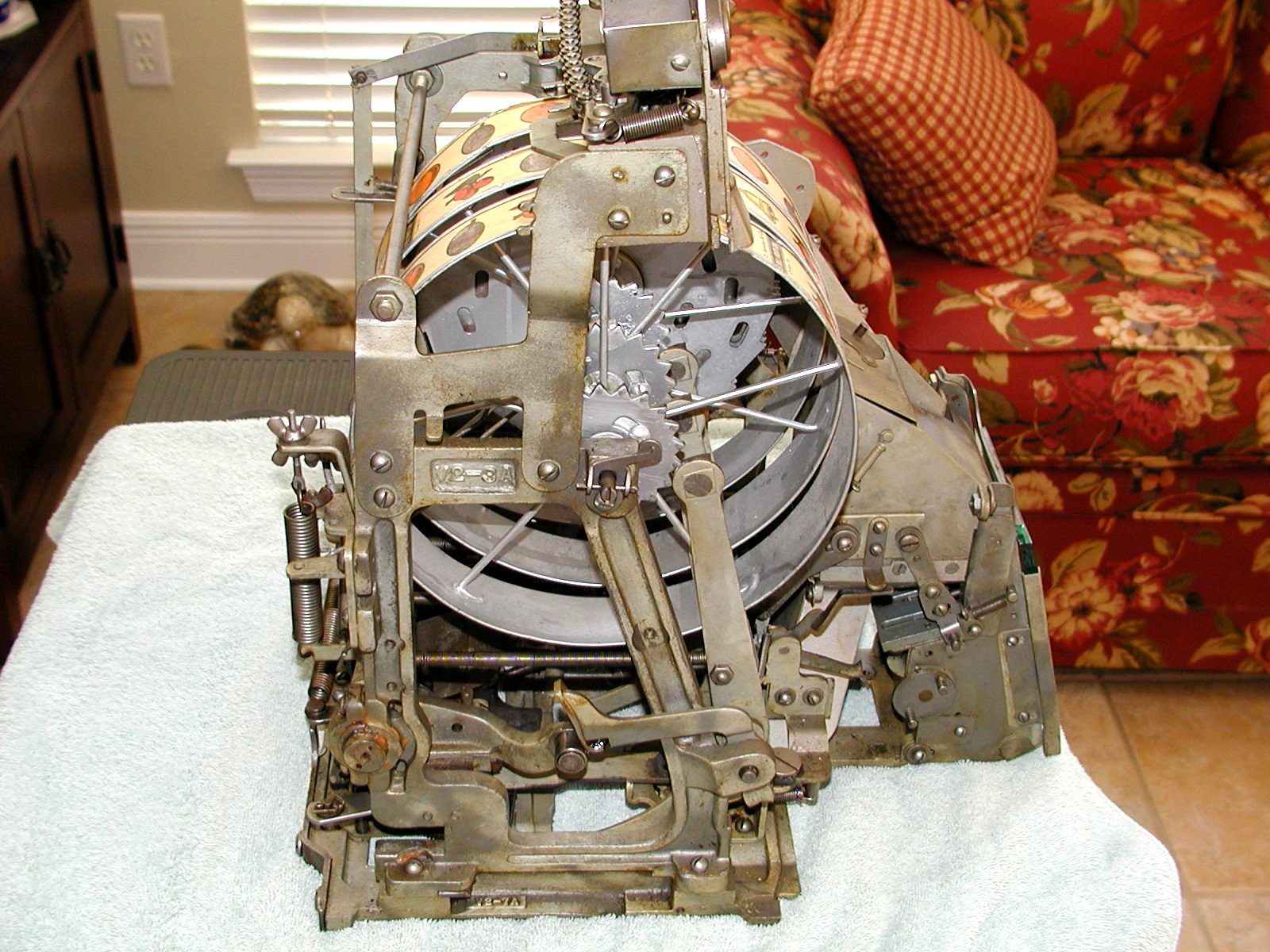

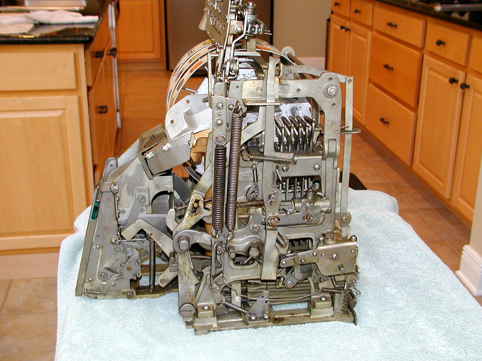

Postby WS65711 » Thu Oct 06, 2011 3:53 pm
Coin Ops -
Thanks for the helpful info. I guess there must be a problem then with refilling the Jackpot from the reserve on my machine....... because that didn't happen . . . :cry:
Edit:

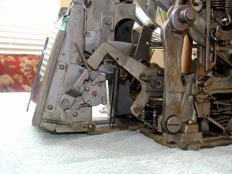

I've added pictures of the lefthand and righthand sides of the Jackpot mechanism, in the hopes that someone might notice something out of the ordinary (like the problem) . . .

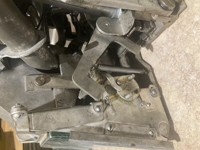

Yes it's a 12 year old thread but it COULD HAVE helped others out. That's the purpose of a forum. I would have LOVED to see the photos of the mechanism because I'm having trouble with my jackpot mech and need to see the front right side. If the forums image system was used, they'd be here. But NOPE!!!! Off site image hosting... and they ALWAYS DISAPPEAR over time.

Postby WS65711 » Sun Apr 02, 2023 3:30 am
shortrackskater wrote:Yes it's a 12 year old thread but it COULD HAVE helped others out. That's the purpose of a forum. I would have LOVED to see the photos of the mechanism because I'm having trouble with my jackpot mech and need to see the front right side. If the forums image system was used, they'd be here. But NOPE!!!! Off site image hosting... and they ALWAYS DISAPPEAR over time.
Very frustrating.
I know what you mean about pictures disappearing from forums as time passes. I linked the pics because back then this forum didn't allow any uploads.
But I do still have the machine as well as the pics I had posted way back when. It's 5:30am here now and my dog just got me up. If you need more than what oldslotman posted I'll locate my pictures and add them back to this thread... later when I'm more awake. :shock:
