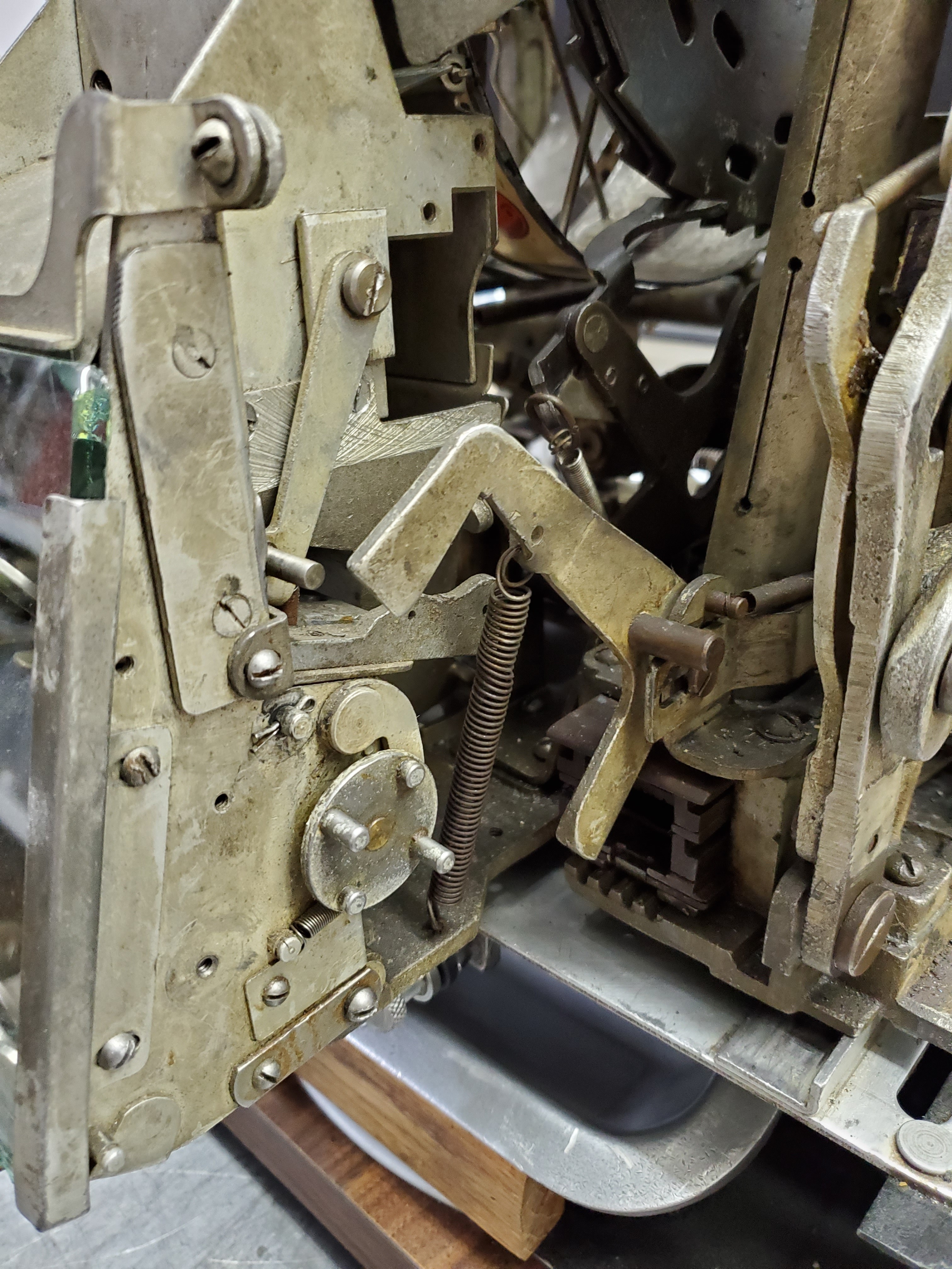

Sorry I am on my cell phone and laptop at this time due to the Dixie fire and my main office computer is packed up or I would post photos of the Jennings mech assembly but I neglected to comment on the front jackpot!
My Bad!
Depending on your particular Jennings there were slight differences in the front jackpot tripping assembly but usually most of that is attached to the slide cover with usually a spring on the trip lever attached to the front jackpot lower frame!
Actually it wouldn't be that hard to remove the front jackpot assembly and yes a glass company could cut a new glass window for you!
Enjoy your new hobby and others here are wealth of information as well!
Ciao!
PS
Just happen to have this photo on my laptop, may be your configuration!
