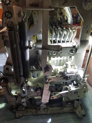

by MONTI
Show some hirez photos of the handle side of the mech, right side from front as this will help anyone here to possibly diagnose your issue!
Re: Jennings slot machine question and more
PostPosted: Thu Nov 11, 2021 4:43 pm

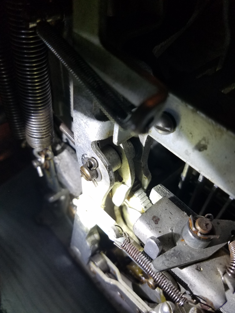

by plentyofcoup
here are some pictures. I do see wear on the lever gear on the right side of the mechanism. I have posted a picture of it. Not sure of part name .I do have the original manual .

by MONTI
Well, maybe it's just my Old Eye's but from the photos you posted I don't see anything obvious sticking out!
I doubt seriously it is an inside the cabinet issue, either escalator or right side of mech, handle side, issue!
Possibly someone else here on the forum can supply some advise as sometimes without "hands on" it can be hard to solve a problem!

PostPosted: Fri Nov 12, 2021 10:38 am
by plentyofcoup
Can you tell me the name of the part in the top photo that shows gear like teeth ? I took the mech out yesterday and cleaned these teeth. There is quit a bit of wear on one section of the teeth while another section looks like new. After cleaning the teeth I reinstalled the mech and have not had one misfire so far. Thinking maybe that the issue is worn teeth from old age and use just like mine. :)

PostPosted: Tue Nov 16, 2021 10:01 am
by plentyofcoup
Have done some lubing of parts and for now the problem seems to have disappeared.
