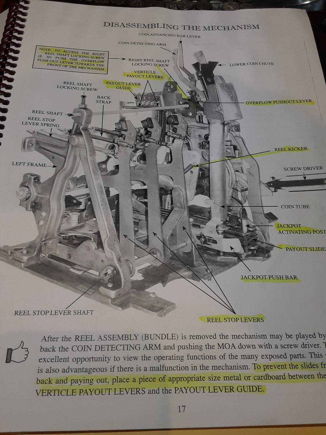

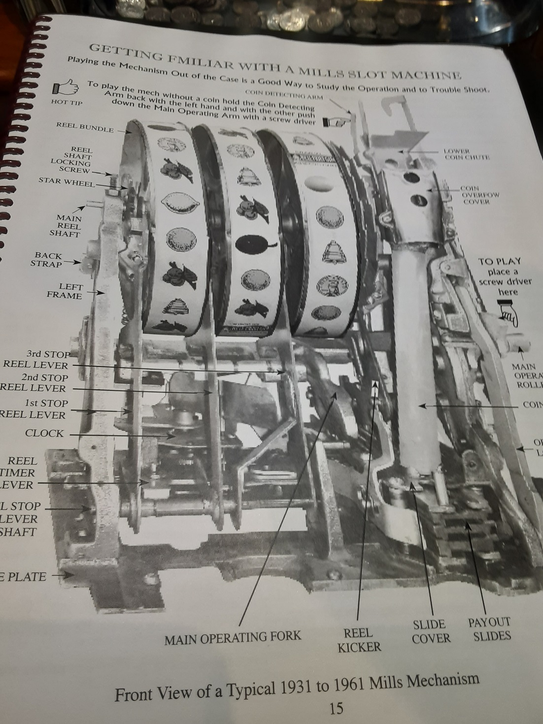

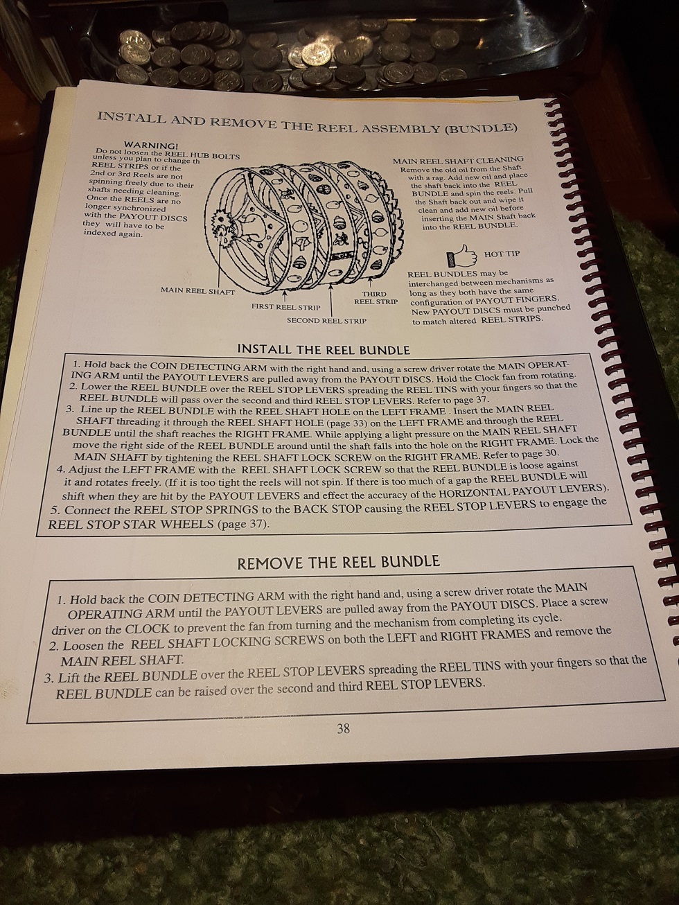

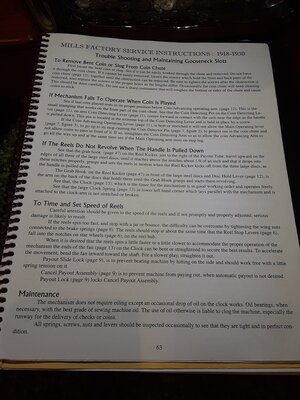

Hello, Not sure what level of experience you have in the disassembly process of your Mills Roman head slot machine but I would start by checking to see if the reel stop levers are not gummed up and the Reel stop lever springs are not stretched out. If that nots the issue I would remove the reel bundle and hand spin each reel to confirm its spinning freely. I have included some pictures to help you identify the parts and help in your troubleshooting efforts.
