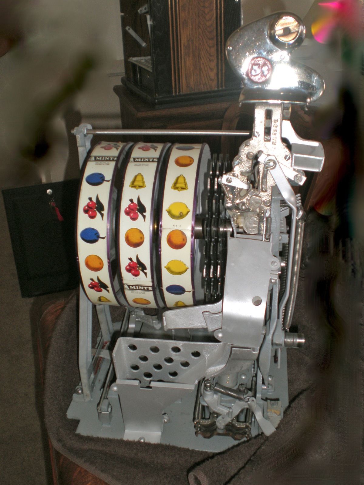

Postby Lambow » Wed Jan 21, 2015 5:13 pm
A thanks to everyone the responded. I decided not to bid, and no one else did either as it close without any bids (doesn't mean that someone isn't contacting the seller on the side). The seller did post these additional pictures at someone request. Do they show the correct second coin return? Thank You, Lambert
Lambow
Posts: 33
Joined: Fri Mar 28, 2014 12:12 pm
Location: Vacaville, CA
Re: Watling Treasury on Ebay
Postby watlingboy » Thu Jan 22, 2015 10:18 am
The first picture, from the back of the mech, shows the second coin detector. The front picture shows the coin return chute on the right side frame, just under the head. As stated, this is an original Treasury mech. Because of all the fakes that have been made, most people don't know what to look for on the mech and therefore are afraid to bid on a restored Treasury, unrestored machines bring more money. This same thing has happened to other machines which have been faked in large quantities. The Jennings Witch is a perfect example.
