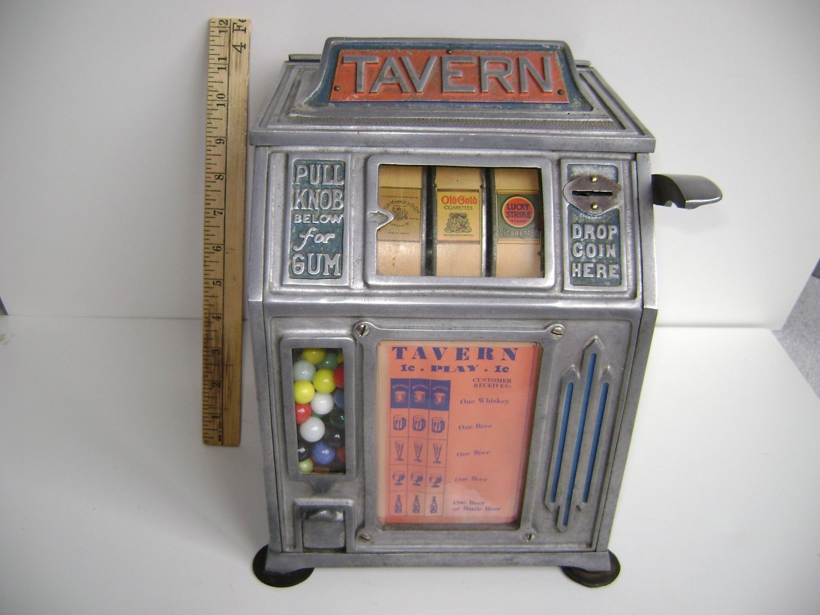

Add this to the list of phony Tavern's. Check out the cigarette reel strips. Ebay item 171871460278

This is one best answered by Bill but I believe that this one is an original one, not positive but I think that some TAVERN did come through with cigarette strips, some one may have replaced the award card with the TAVERN beer award card, but I am sure that Bill will school us all.

No, this is not someones 'Phoney-Fake'. It is a totally original "Tavern". Only problem here, is it may not have left the factory in
this configuration. My guess is that the reel bundle was changed at some point, by an operator, who was placing it in a location
other than a saloon. But why the award card was not replaced at the same time, is a mystery. Groetchen did make a "Tavern",
that had the beer strips, but had a pack of Lucky Strikes slid over each Whiskey symbol, and had an award card with the Luckies
at the top, instead of the Whiskey, but the card was printed that way, not paste-overs. I found two many years ago, and sold one
to a friend, and have seen a couple of others. Strangely, the first Groetchen "The Bartender" that I found many years ago, had
cigarette reel strips & card. Another turned up several years ago, at a live auction, in the same configuration. Then a third one
not long after. Therefore, an original Bartender has never surfaced with Beer strips. It wasn't long after the one that sold at the
live auction, that the many Fakes started to show up from the Vegas Butcher. So, either he bought it, or knew who did, and
borrowed the cast nameplate, to make a batch for his upcoming Phoneys. He also put repro Tavern strips in them, and had some
award cards made, by changing the Tavern lettering to now read Bartender, which was NEVER original.

altort wrote:This is one best answered by Bill but I believe that this one is an original one, not positive but I think that some TAVERN did come through with cigarette strips, some one may have replaced the award card with the TAVERN beer award card, but I am sure that Bill will school us all.
You can always depend on Bill for the correct answer :D
