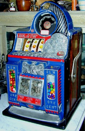

This Rol-A-Top (eBay 200965243506) is back on eBay after running for a lengthy period at a high reserve. It is the nickel machine with a gumball vendor which seems a bit odd. I sent the seller some questions about the machine but didn't get any response. The inside picture of the top casting appears to be a repro but I would be interested in comments from more experienced Watling folks such as WatlingBoy. What do you think?

Hi Flipper77
The slot come from :
http://www.slotmachinereelstrips.net/ap ... ow/3605643
it s a frankenstein Slot machine !!!
Mech is from a Rol a toR !
No gumball with 5ç coin !So the guy have removed the "1ç" logo on front ! Stupid idea !!! [-X
Don't loose your time , exept if you have a rol a tor front casting somewhere !!

Thanks much Stephane. What I had concluded but wanted to get input from Watling experts. Guess I know why seller didn't respond to questions. This seller has numerous machines on eBay and a decent rating. Know now to avoid.
Appreciate the info!
