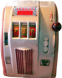

Does any one know about the coin pay outs for the Groetchen "Sparks Champion"
the listing on eBay says it is a Champion, but on International Arcade Museum,
http://www.arcade-museum.com/game_detail.php?game_id=5584
It is listed as a Sparks Champion
The listing says it doen't have the gum ball items and there are two coin tubes on the left that have been locked down, so as to not work.
I don't see where the case would allow a coin to come out on the left side, where these two coin tubes are located.
and I also, don't see where the gold Champion token can be placed into the front coin chute.
I can see where the token comes out on the right side and that is all.
In the 10th eBay listing picture, you can see where a part looks like it was recently removed (clean spot between two base lugs)
I'd hate to buy this and find out there is allot of 'hard to obtain parts' missing!

eBay pictures show it as a 1 cent denomination and International Arcade only show 5 cents

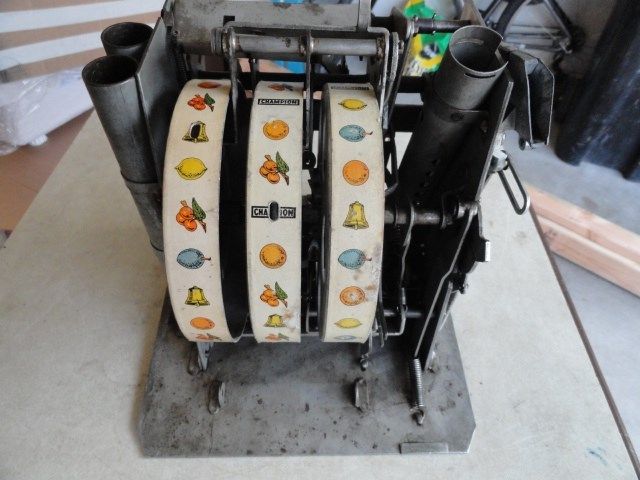

Here is a couple of pictures of my mech with the parts that are missing on the one on ebay, the part on the front would release a gold champion token when the three fingers line up with the holes on the reels, the gold champion tokens load from the top of the window on the inside, it is also missing the spring loaded flap on the back that the coins played fall through, I don't know about the two coin tubes on the gum ball side.
Hope this helps.

Altort,
thanks for the pictures, it does help. Do you have another shot of the front base area? the one on eBay is showing a set of ear lugs on the base and a clean area where some thing use to be. He says the ball gum mechanism is gone and I was wondering if that was once attached there. By the way, thanks for pointing out the missing flap on the back door!!

altort wrote:Here is a couple of pictures of my mech with the parts that are missing on the one on ebay, the part on the front would release a gold champion token when the three fingers line up with the holes on the reels, the gold champion tokens load from the top of the window on the inside, it is also missing the spring loaded flap on the back that the coins played fall through, I don't know about the two coin tubes on the gum ball side.
Hope this helps.

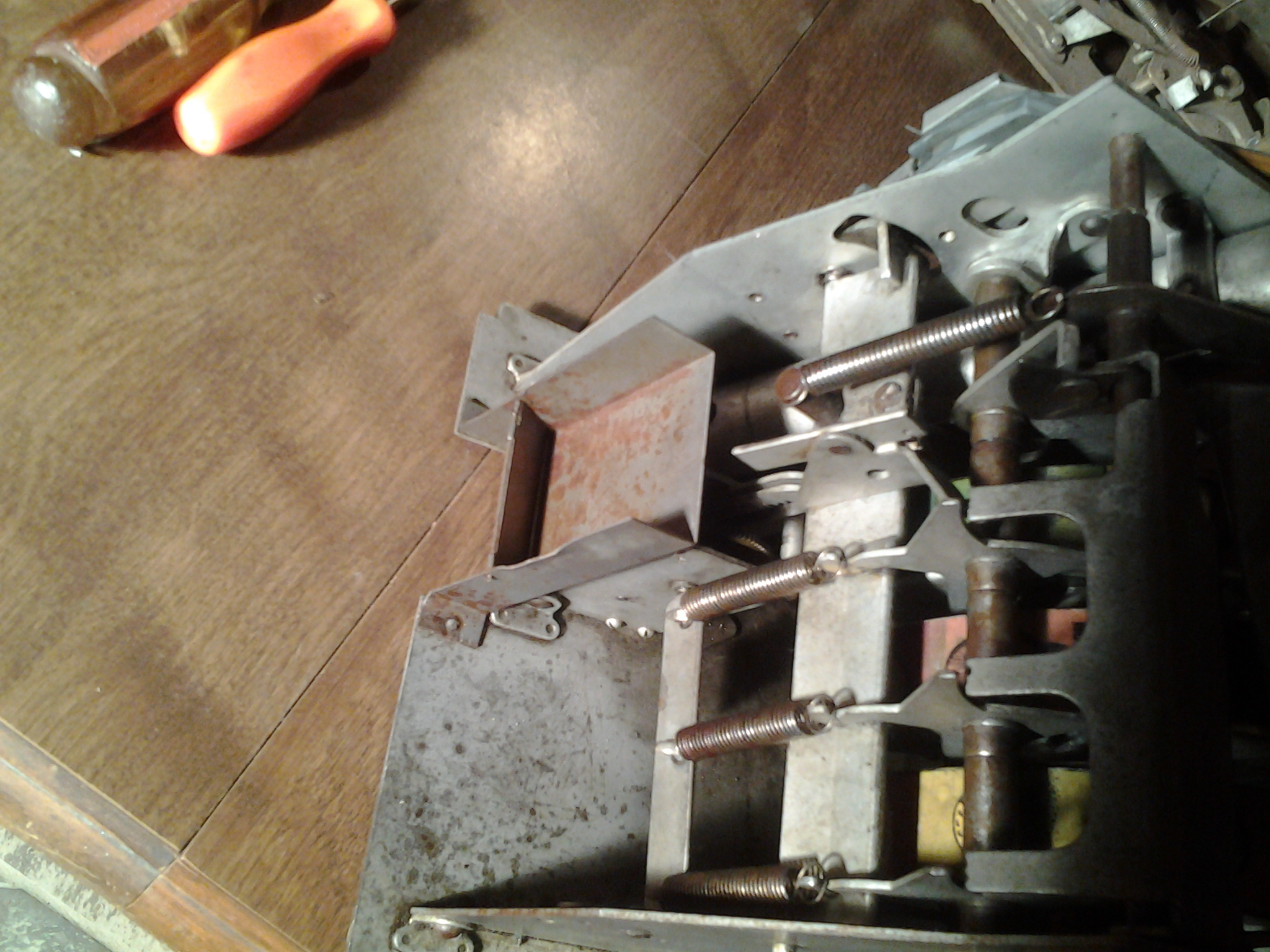

I can see on your machine where the two lugs I was referring to,, are actually hold the parts for the reel finger latches.
How can the eBay machine truly function if these are missing?

Well, I did receive my answers on the Groetchen Champion!
It seems this unit is missing the gum ball dispensing parts,
the small coin flap in the chute, on the coin drop, and
the latching pawls for the gold Champion pay out system.
So far, the seller has not made it known about the missing gold Champion token pay out latching system
or the missing coin flap. Just the missing gum ball parts.
