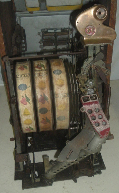

Do the 25 cent watling blue seal torch front machines come with the linkage that feeds the jackpot every 6 quarters? There's one on eBay that looks like it is missing. Seller said its complete, loads and pays out on both jackpots.

Hello
They are two different jackpot version .This one on EBay don t have the linkage that feeds the jackpot every 6 quarters !And don t need it on this version since that the coin chute are on the Jackpot!
But if you have the coin chute on the Mech. , you must have it .

So linkage is only on 5 cent machines?

Hi
No , you can find it also on 1ç and certainly on other coin denomination , but it s hard to find a blue seal in 10ç or 25ç for be sure !!
This one on eBay is a "special version" with the coin chute on the jackpot ,but you can find it in 5ç also .
At this time , I seen this version only on the Torch front (at this time ,but maybe it s possible to find it on other models).
