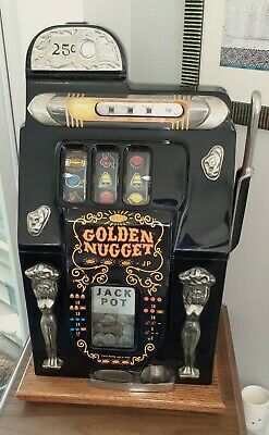

After reading " tips on identifying fraudulent machines " I guess this fits into that category.

Absolutely a reproduction machine!

The Golden Nuggets actually fall into 2 different categories. You can have an original Mills Black cherry, Diamond front or Golden Falls that someone has bought a Golden Nugget Kit and put on an original machine. These Nugget kits were made by the hundreds and sold. They consisted of reel strips, nuggets, dolls and an award card. These were put on original machines and put on complete reproductions. Whether it was an original machine to start with or a complete repro, like the one you posted, both are wrong and have little in common with the original Nugget machines.

An original GN will have formica sides, the fake/revamp will be wood sides, the payout base will wrap across the bottom as well as the sides(chrome piece at the bottom) a fake or revamped will just have the small coin tray as in your picture.
The award bib on an original will not be silk screen it is embossed, meaning it is indented and when you get a chance to see one in person just run your finger over it and you will automatically know by it’s feel. The dolls on the originals will be 2 tone gold/cjrome, this is more costly to reproduce so is seldom if ever recreated in the aftermarket.
The exact history on the revamp/fake machines I am not absolutely sure of but I believe these revamped machines came into existence in the 70’s by some clever individuals who saw a market for converting machines for the tourist market in Vegas/Reno, since it became legal in many states to own an antique slot machine. These machines generally were original Mills machine. This evolved probably in the late 70’s to early 80’s into outright reproduction machines by other savvy individuals that wanted a piece of this market. These total fakes will almost always be 25 cent with smooth back doors, many without escalators and other parts.

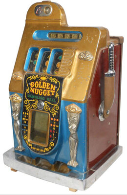

Here just grabbed this photo off google, notice the actual coin tray is made of brass and then surrounded by the chrome moulding, the hand load jp, the sides of the machine are formica and the 2 tone dolls, this is an original Golden Nugget.
The photo in this picture is most likely an unrestored version of the 25 cent GN, It’s a very nice looking machine.
