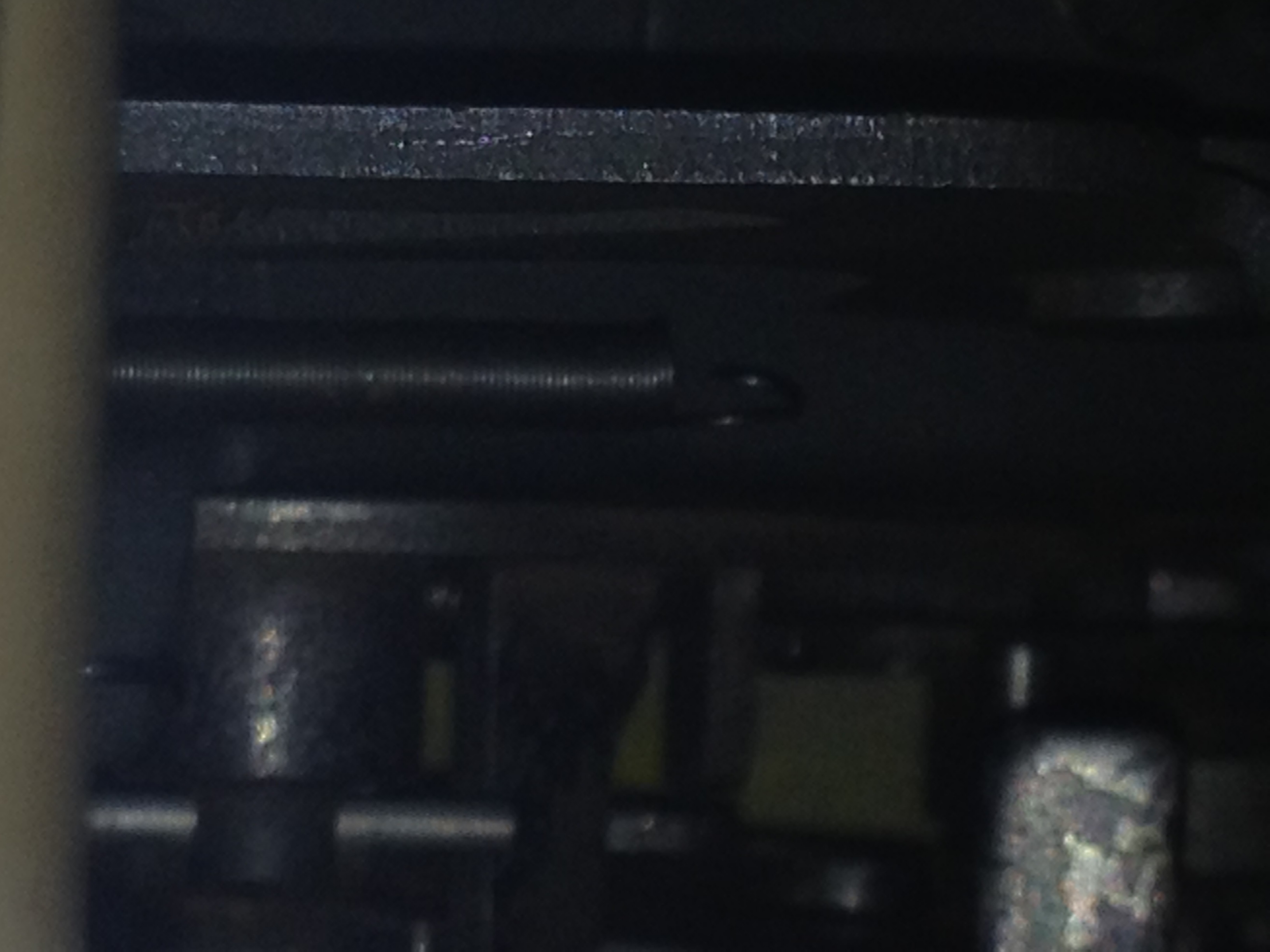

Ok here is the inside to mine do I pull or push the leavers to get them to go back in also the spring that is hanging down where do that go

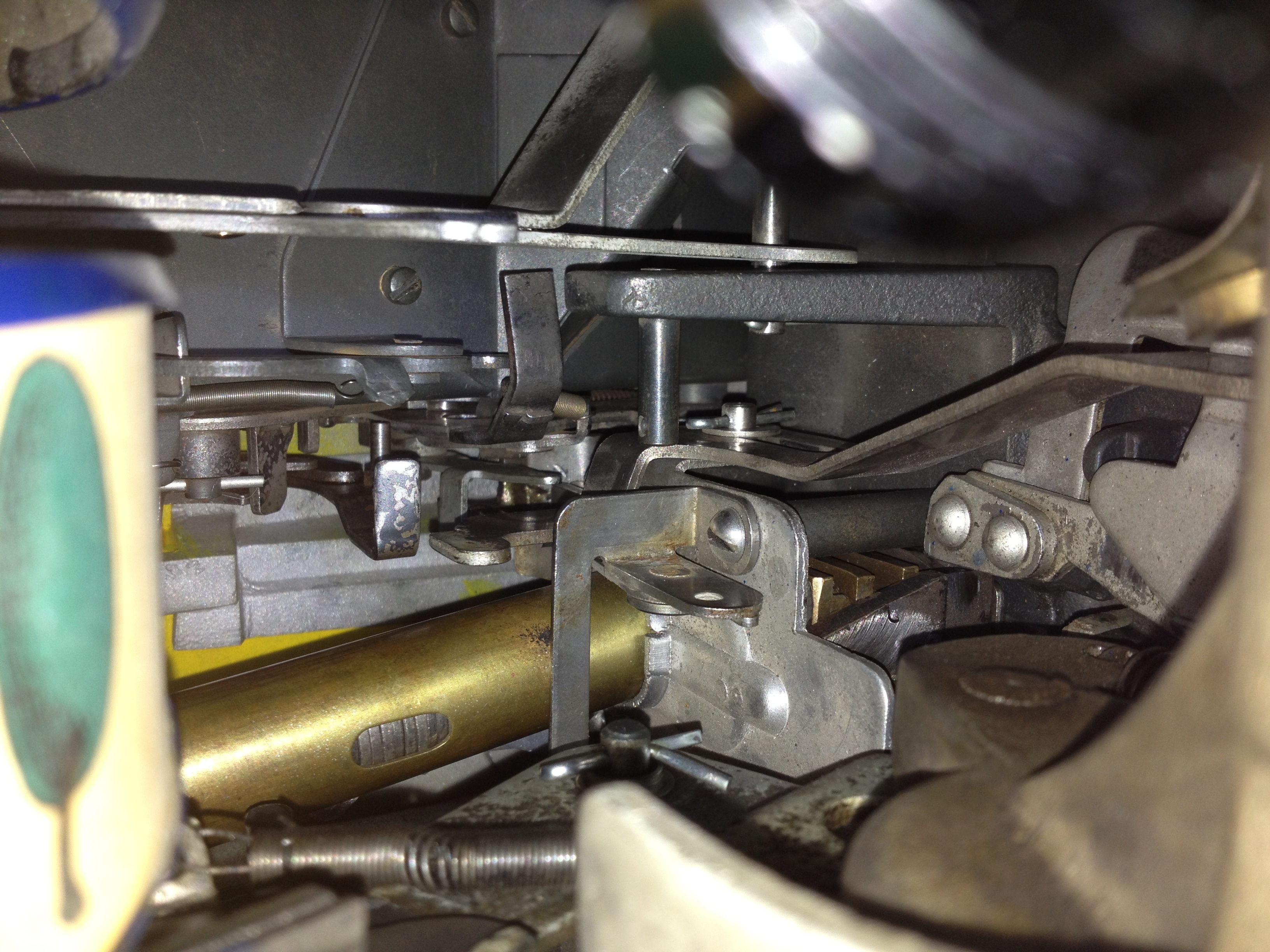

Here is the spring

It appears to me that you are going to need someone that knows about slots to have a look at it. Needless to say, there is a large amount of complexity to operate the reserve jackpot feature. If the reserve jackpot feature fails it can lead to total malfunction of the jackpot itself. Where are you located? Maybe there is a chance that someone on this forum that knows about the jackpot mech lives close to you. Slim chance but you never know.

I found the leavers you were talking about and got it to reset thank you for your knowledge
