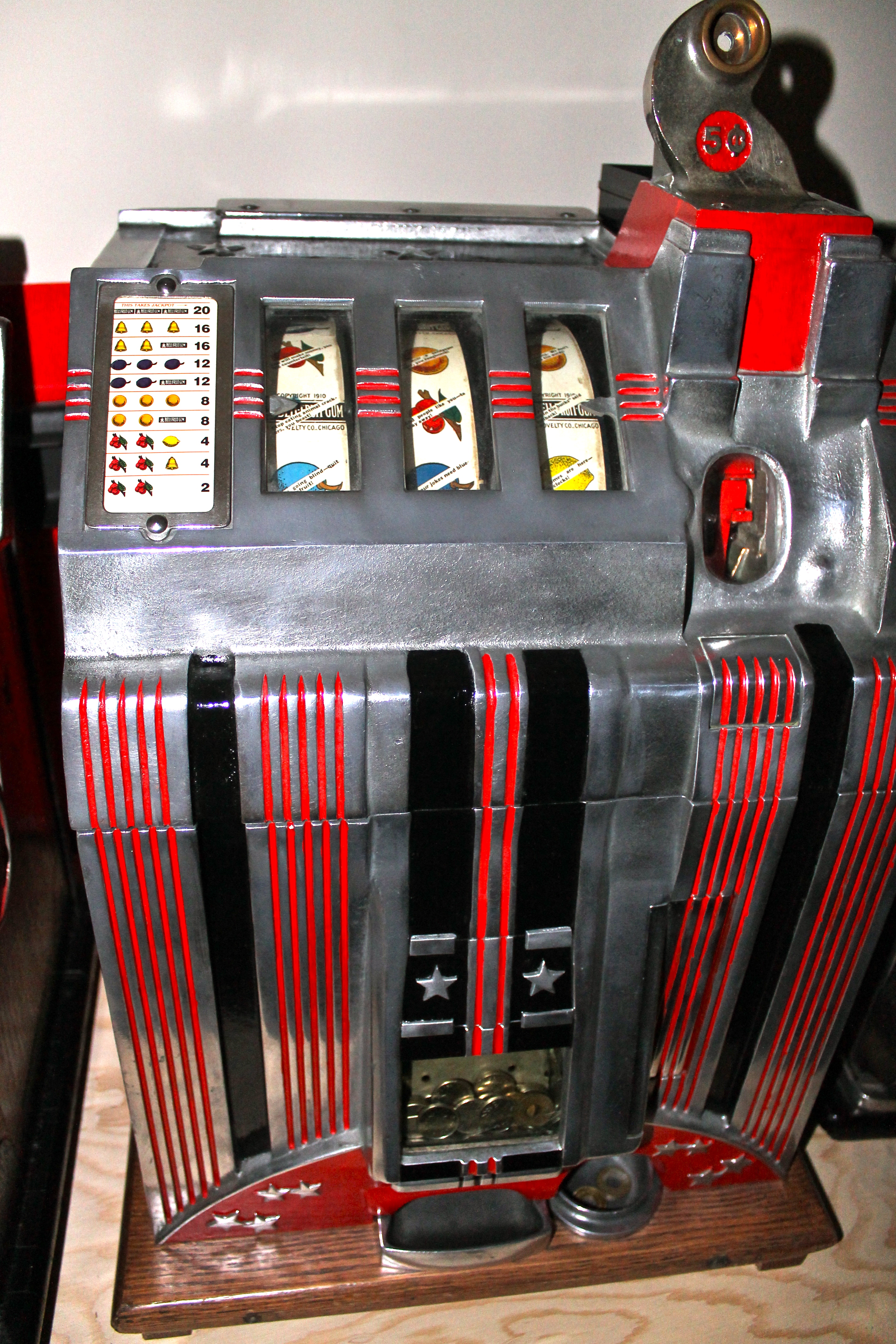

I restored my Mills Skyscraper about 5 years ago
I noticed that the metal payout card is a 3/5 and mine is a 2/4 payout !!
I think the 2/4 are older models, but I would ask the oldtimers on this, :>)
I got the original colors from a book called Slots 1, Richard Bueschel, True Colors

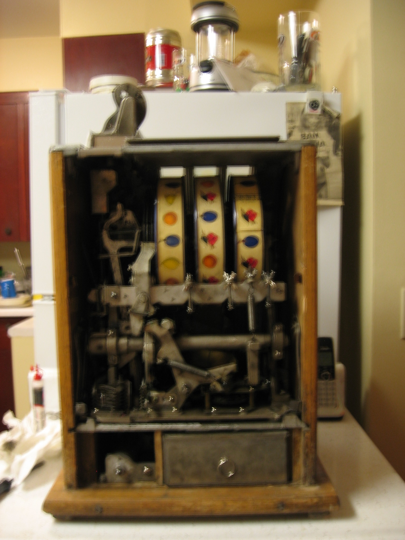

I'll post some pics and / or e-mail you after work.
Original guts and labels are all inside, although I don't remember finding a date.
From memory serial number is a six digit starting with A390XXX ( "A" prefix on the serial number looks to have been stamped with the same depth / force as the numbers ?
Internal serial number sticker has an old fashioned A added to it ( looks like oldie type fountain pen ink ).

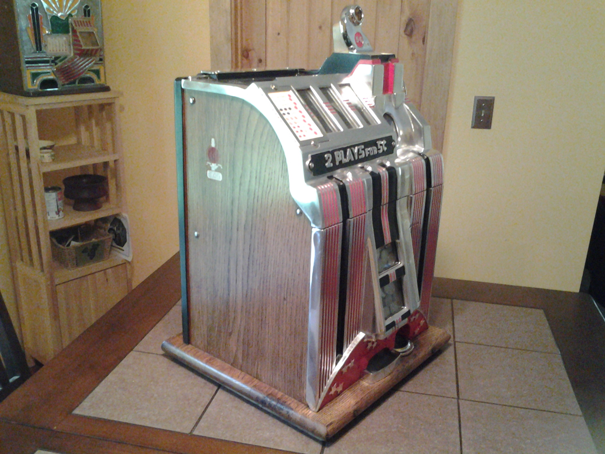

Postby altort » Wed Feb 05, 2014 6:36 pm
kentdun wrote:Looks like a great paint job. Can I assume you had to hand paint it. Can't imagine it could be sprayed. Are the sides painted or varnished? Mine is painted flat black on the sides. If mine doesn't sell I might tackle a repaint. Never repainted anything larger than a gumball machine.
A little of both, the thin red lines were hand painted, the larger red areas and all of the black was spayed, after spraying you need to feather the tape lines to get rid of the sharp paint edge, lots of taping but the results are worth it in the long run.
The cabinet is stained a medium walnut with several coats of satin polyurethane.
The slot was pretty rough to start with but the end result was well worth the effort.

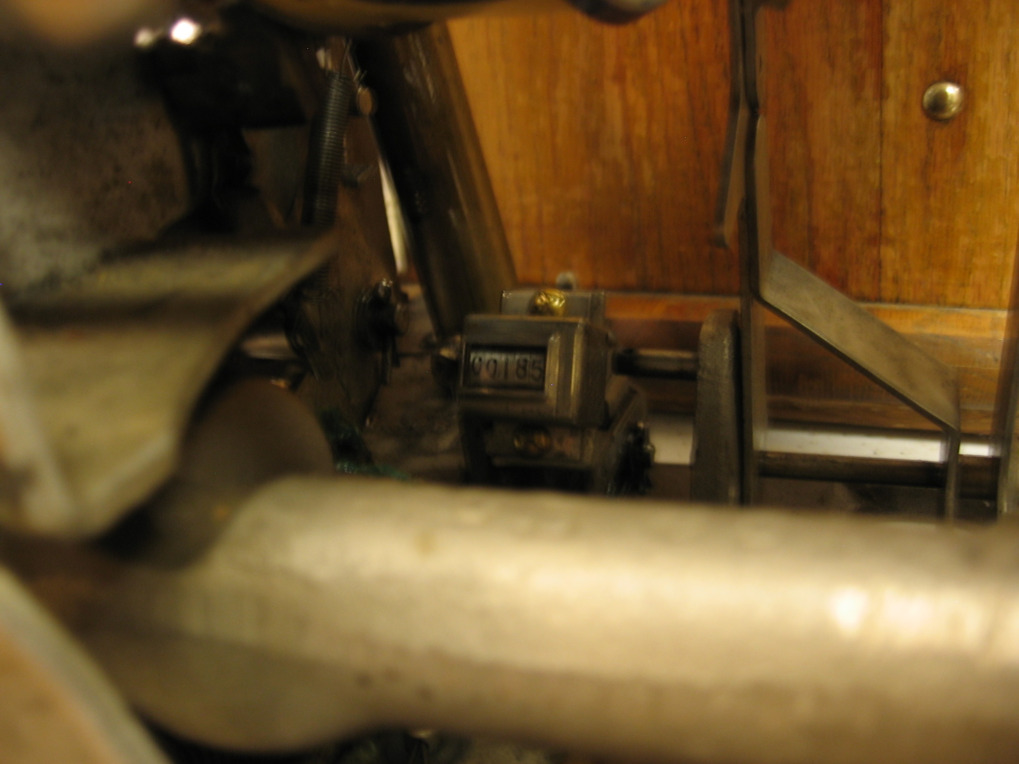

only 185 Jackpots since 1936. I'm guessing nobody got rich from this machine - LOL.

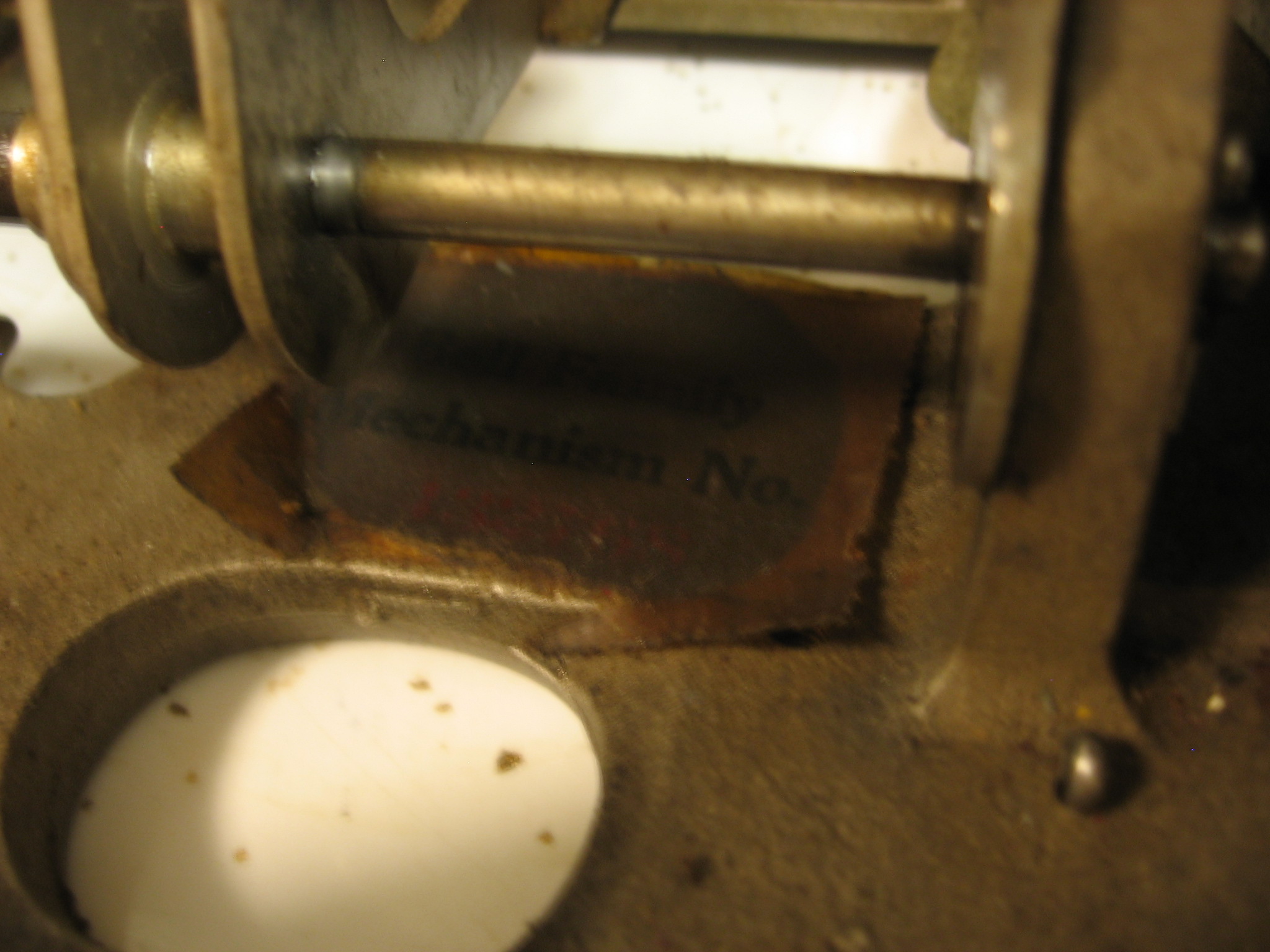

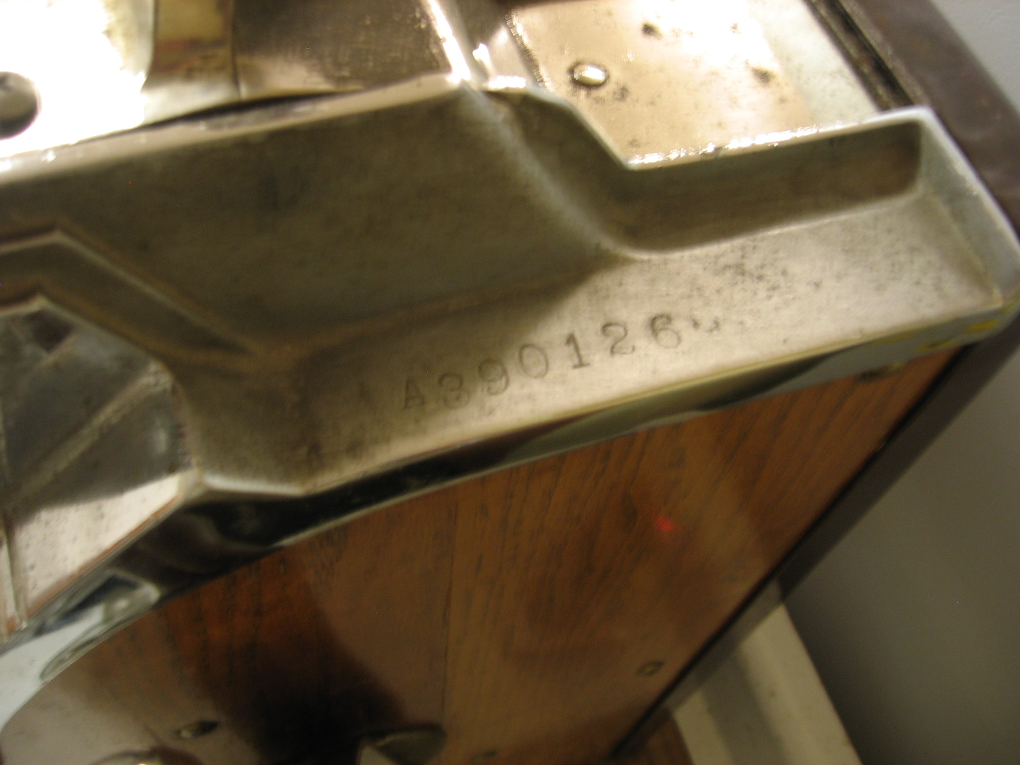

Not 100 legible . . .
A is obviously smaller but looking at the stamp in person, it's easy to tell that it was punched with the same force / tooling.

Ref Steve's machine:
A Skyscraper with hand-load JP, JP counter, metal award plate, and a lettered serial number; VERY interesting.
The serial number is high for a Skyscraper, indicating it is near the end of the model run and close to the introduction of metal award plates on Half-tops.
This may very well be an early use of metal award plates by Mills.
Very few Mills machines had a letter prefix.
The Bueschel/Zimmerman serial number list already has 390126 assigned to a 25 cent Castle Front.
That may provide a clue as to why the A prefix;
perhaps quality control discovered the duplicate number and the accounting department (or some government regulator) said they could not just change the duplicate number, but had to modify it.
The mechanism number is unreadable in the photo;
I think Steve indicated it had a hand-written A prefix and he could read some of the printed numbers indicating it matched the case.
That's kool that you figured out an additional machine with an identical serial number !
Kinda nixes the theory that the A was added later by an operator / restorer, as previously suggested in another post.
If you could see the serial number in person you would be able to tell that the letter and numbers were stamped by the same means .
