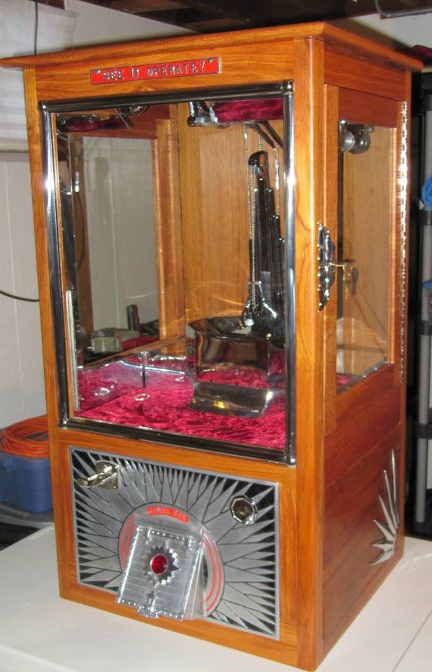

I am just finishing the Jewel Box Upper...see attached pic. I am waiting on the mirror for the background, and I will have the base ready for trim this weekend. Sorry I couldn't help you.

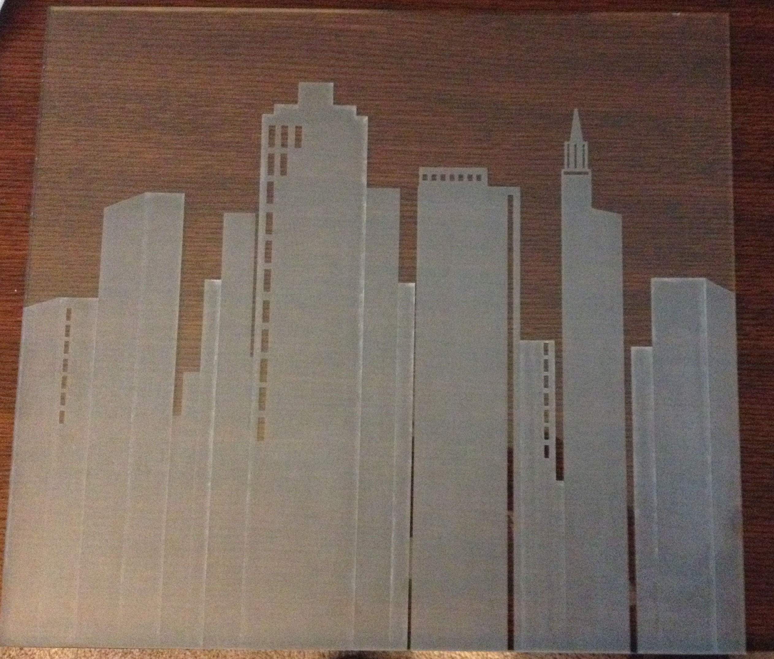

Nigel...just made a decent score in regards to the Deluxe background. All that I have seen have a mirror for the background, but I am now told the original was a mirror with a blue arc at the top to resemble the sky, and then another glass panel with etched skyscrapers then sits in front of the mirror. I was actually able to locate an original and now have it in hand........I've never seen it outside of one of Jim Rollers pics. I will try and post some pics for you if you want to try and have one re-created for your Deluxe.

Nigel, this is a pic I took from my phone. I will get you a higher res picture this weekend, but at least it will give you and idea of what it looks like. It is pretty thick glass, and goes in front of the normal mirrored background. The mirror should have the top in blue tint to simulate the sky. I'm probably going to have to have that special made.....I'm guessing the odds of finding one of those intact are next to none. I'm getting closer to having all of the pieces for the deluxe......going to have to re-create the prize door, top cap and base trim.

That looks great, I have seen a Jim Roller resto with exact same art work on mirror!
Are you sure this is original as it looks remarkably sharp and modern looking for an 80 year old digger??

I believe it is original. There are some scratches and edge chips, and there is also a little bit of a paint line at the top from where it was obviously in a thin frame at one point. I will agree it is in pretty remarkable shape, but unless it was an early repro, I would not call it new. I would think if they were being reproduced, I would have seen one somewhere other than the one Jim did. There is some dimension to the glass, meaning this is not just etched across the surface. There are peaks and valleys to the buildings, to give it a 3-dimensional look.

Well Nigel....I may owe you a drink when I get over there this summer! You got me curious, so I checked with the original owner. It is indeed an older re-creation from an original pattern. It is used, and was in another digger, but you are correct, it is not quite original. My hat is off to you sir.............
