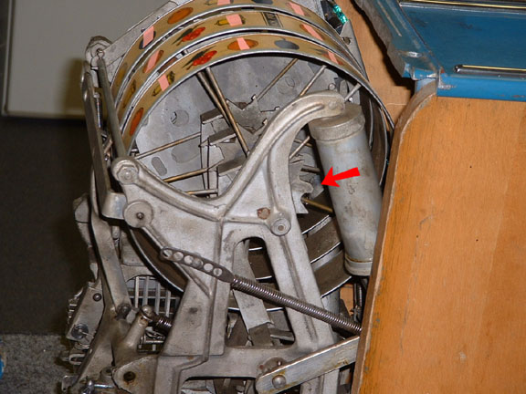

OK, finally played around a bit with it. Numbers match??? Backwards numbers have me wondering if this is normal?? As you can see a few things. One I got a free mouse although he is playing dead. Next you can see frame and case match # wise. Next the heavy HARD grease. All is operating after I had to bend a bar slightly that pushing on the reel bars to release them. Next after monkeying around I realized the reel spin mec was gooed up and not coming back down to position. Once I manual operated it I found that issue. I am pointing at this lever in 5th picture. I adjusted the clock and it works perfect as you screw it in and out it slows and speeds up. All seems to be working and will just need cleaning to get it perfect. What is missing in the bottom/center of the box? I see where screws were and mount but it is missing. Also found a Bug. Thanks,,Rick B

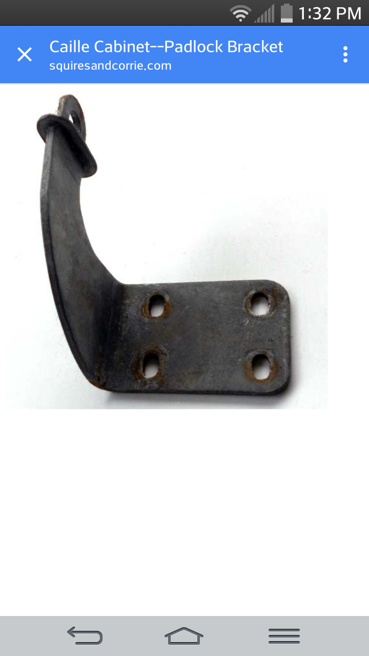

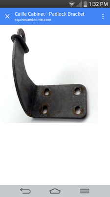

I may be wrong but since you have a slot in the door ,I believe the missing part you speak of is sort of a hasp that fits through the slot for an additional lock.

Here is a picture of just the part.

Thank you. I seen a picture on the net but it is so small it looked like two parts. Anybody know about the backwards numbers? By the way the pay out slides work fine also. Rick B

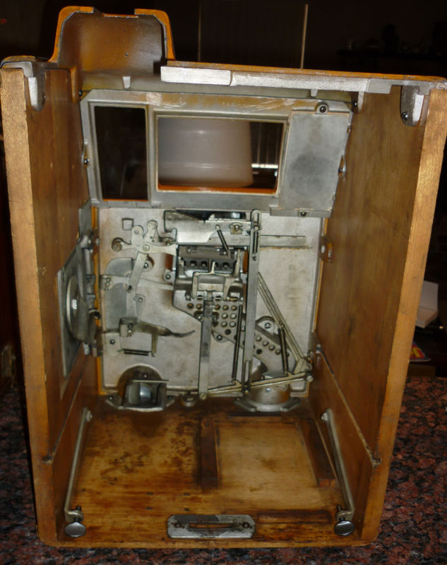

You are missing a critical part, a casting, from your jackpot assembly. It is an odd-shaped, ballasted part that prevents the sliding trap door which forms the floor of the reserve to travel far enough to latch on the hasp to the left; it tips backward when coins have filled the JP chamber and allows the sliding trap door to lock shut. I will try to find a picture of it so you can see.
All Dough-Boys were manufactured with a "bug" of sorts: you'll find a deformed cog on the first reel starwheel which, though it doesn't actually make a first-reel bar on the payline impossible, does make it lots less likely.
Nice mouse! I got one just like it with my Dictator. 8)
Re: Super deal on 3 machines at auction. Need a few things
Postby marsonion » Sat Nov 12, 2016 3:52 pm
Images attached, one providing a view of the inside of the cabinet; the casting you're missing is dead center in the picture. The other picture shows the manufactured "semi-bug" on the first reel jackpot bar.
