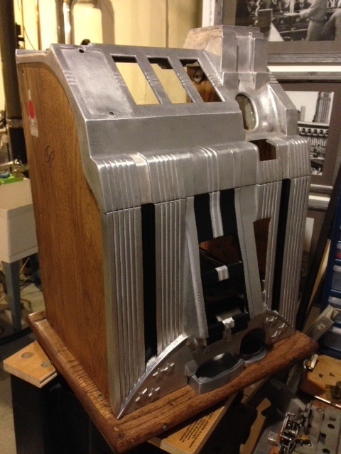

Thanks altort for the input! Yes, I removed both castings from the cabinet before stripping off the paint. I used a product called "Citri Strip", which worked great and didn't have the bad fumes. I then used a nylon brush, scotch brite pad and toothpick to remove the paint. We'll see how the sanding and polishing goes next!

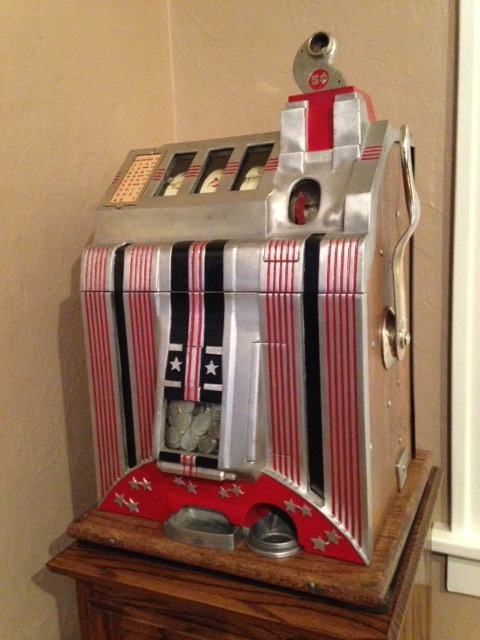

Postby YourBestBet » Sat Nov 22, 2014 9:32 am
I finished it a couple months ago but haven't gotten around to posting a picture. I'm really happy with the way it turned out. It was beyond rough!

Postby Midcoast Vintage » Sat Nov 22, 2014 3:23 pm
VERY NICE!
Re: Mills Skyscraper
Postby sam2002 » Sat Nov 22, 2014 6:40 pm
SWEET !!!
Posts: 712
Postby TheFatman » Sat Nov 22, 2014 7:10 pm
Awesome job.... loving the restore...Is this the one from NY area? I saw it and almost bought it but let it go ... yes very rough, if it is that one.
