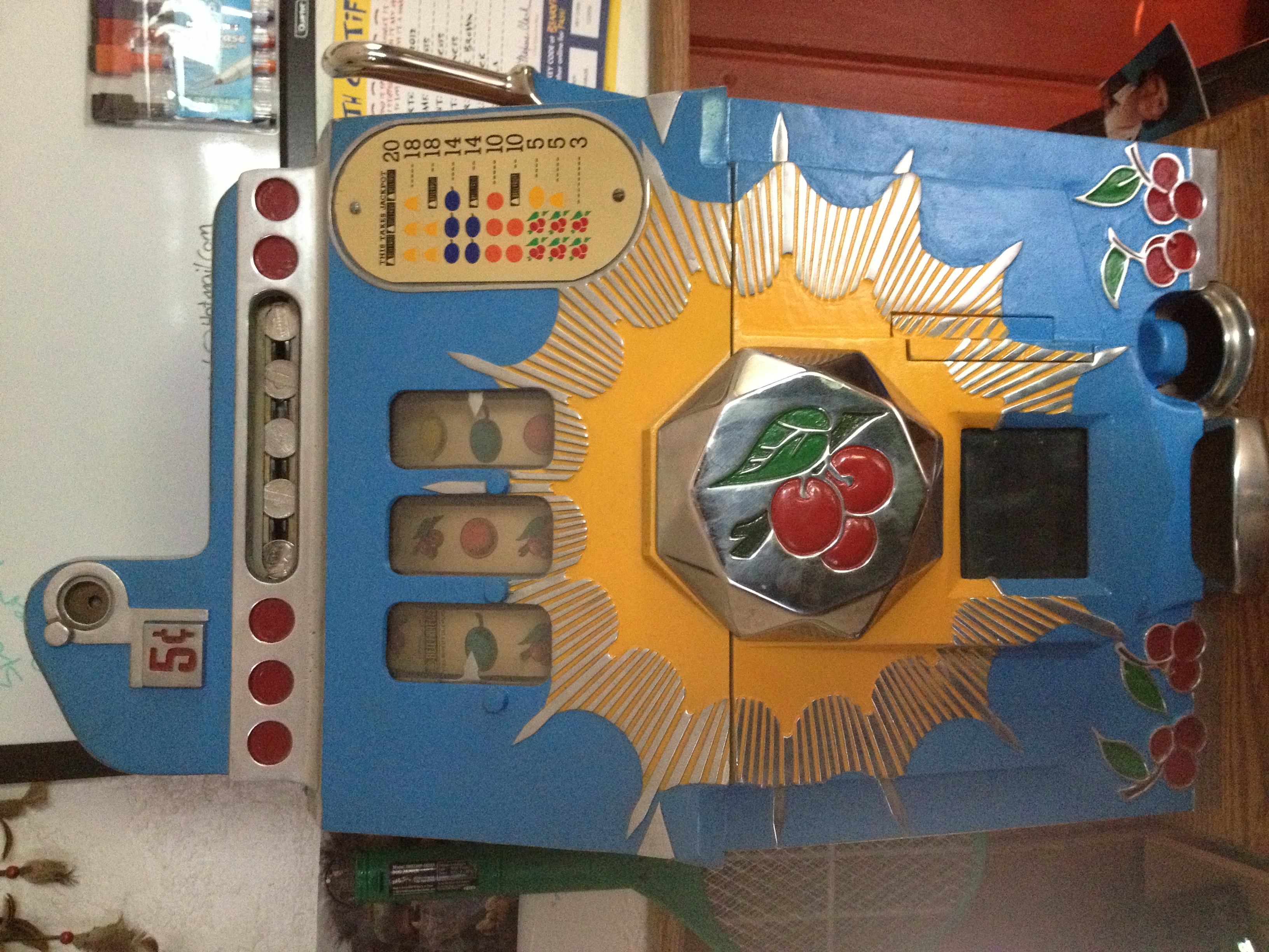

I have a working mills slot machine (bursting cherries) I hit the jackpot and now the trap door is stuck open and wont fill back up with nickel's any ideas would help also does it look like a reproduction or a real one?

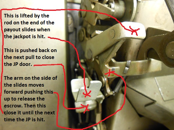

Postby melkiefert » Wed May 29, 2013 2:13 pm
Dose anyone have a pic of the arms u are talking about so I can see what and where the arms are and try to figure this out

Postby TheFatman » Wed May 29, 2013 5:03 pm
I will be adding a brief description and picture of what the basic levers do and how they look so you can find them.
OK ... I am back with it
The JP gets hit and the door opens to dump the coins in the window. The next pull of he handle will shut the door, trip the escrow to dump coins into the JP window and then it locks the escrow so it will fill back up . People did not want to play a machine with an empty JP window.
I hope this helps you. Make sure that all the levers move freely. If not. mineral spirits is what I have used to free the old grease.
This is the best I have at this time
